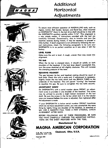

I have posted shopsmith's information several times on this subject. Right now I can't find those posts containing the document.
Machines below serial number 290367 had to be filed, as in no adjustment screw. Those with numbers above 290367 have the adjustment screw.
This was for such tools as the jig saw, belt sander, bandsaw, and sprayer, all of which had straight legs. In order to align them you adjusted the screw or filed to get a fit.
This was done after the headrest was squared.
I'll scan it in later tonight and please take the time to print it out and keep for reference so when the subject comes up again we are all working off the same page. (Get it? Same page?).
The instructions are not for the dual tilt machines and were made obsolete with later SPT that have the off set tubes.
spt lateral adjustment for straight tubes
[ATTACH]20972[/ATTACH]
[ATTACH]20975[/ATTACH]
Lateral adjustment is accomplished by 'squaring the headrest'.
Notice the word 'slight' relative to the set screw adjusting. Notice the tie bar screws should be loosened. This does indeed adjust the tilt or helix condition of the way tubes.
Notice the info regarding the tie bar seating on the headrest.(both shoulders)
I believe the offset spt mounting tubes were created to eliminate folks having to 'square the headrest' and mess up alignment in the process.
Notice an uneven floor can affect this.
Now this is not addressing the table alignment issue, but does enlighten us as to what moves what and in what direction.
Now how do we adjust for extension table left/right tilt due to headrest being cocked(spt mounting holes not perpendicular to the way tubes / not parallel with the spt holes on the other end)?;)
There are so many things that interact and can cause slight deviation from perfect alignment, that some tolerance of imperfection must be tolerated.
That said, IMHO one can get closer than 'typical' if correct adjustments are made in the correct order.
The waytubes must not twist from end to end - this causes the headstock and main table to rest at different angles as they traverse from end to end. Set screw is the relevant adjustment.
The headrest must be perpendicular to the way tubes so that the spt mounting tubes are equidistant from the headstock axis of rotation and perpendicular to it front to rear. There is no way to adjust the hinge end spt mounting holes other than squaring the casting front to rear to the bench tubes similar to 'squaring the headrest'. We have to assume the rotation axis is parallel to the way tubes.
I added a pdf attachment.
