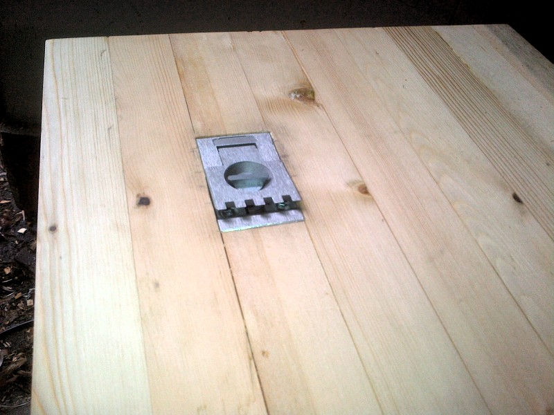

I am going to add a Mortised Bench Stop like the one in this thread. What is it?
Also I am thinking of trying to make some hold fasts similar to the ones in this picture. I will keep this thread updated as I add "features" to the bench.
A recent thread by pieceseeker ( What is it? ) reminded me of the mortised bench stops that I had previously seen in the Lee Valley catalogue.
So I stopped by last week and bought one.
This morning I spent a couple of hours in the shop and installed it in my workbench.
Mortise cut.
[ATTACH]21586[/ATTACH]
Stop installed
[ATTACH]21587[/ATTACH]
Stop in use.
[ATTACH]21588[/ATTACH]
It works well but I may get another one to mount facing the front of the workbench a few inches back and to the right of the first one to support the work in two directions.

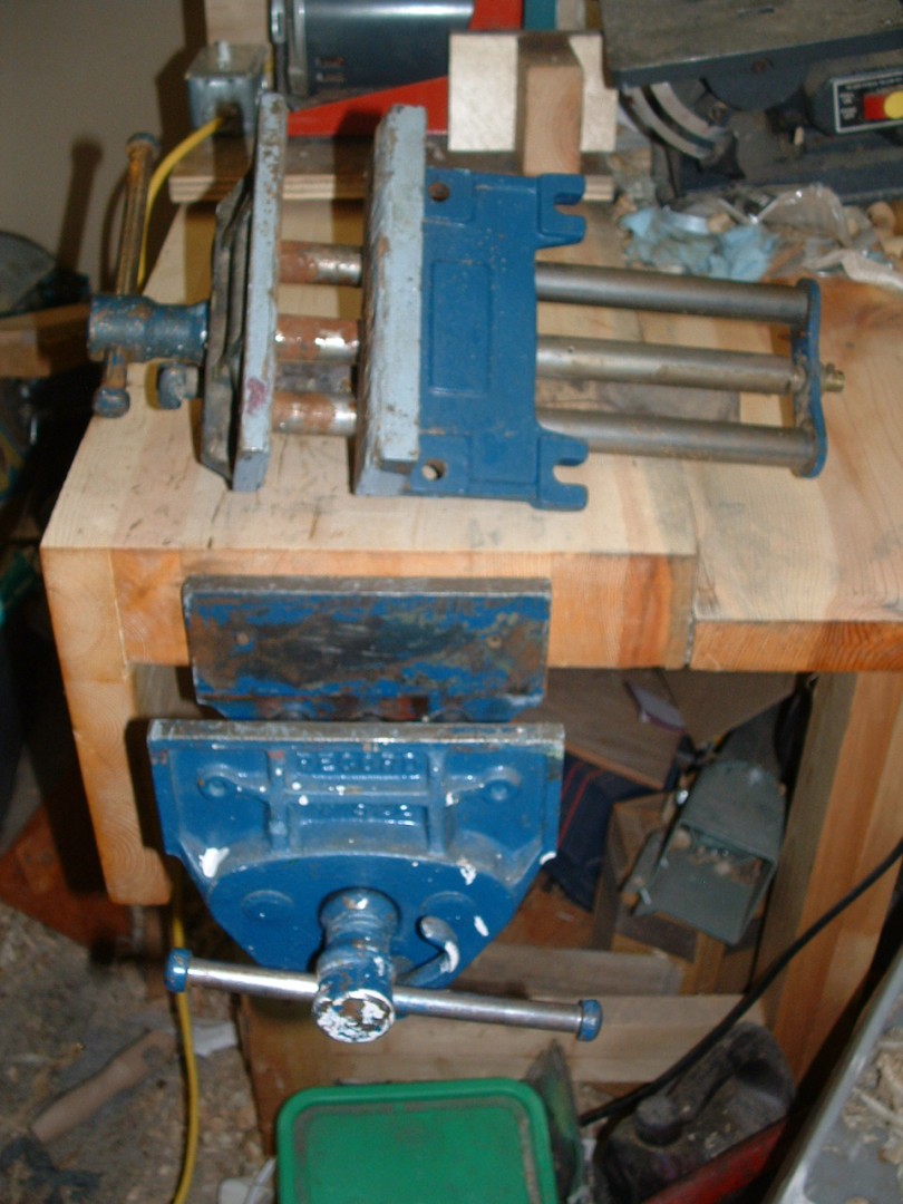

Last month I was at my local Habitat for Humanity ReStore on a Monday and they had just got in about twenty, old, made in England, Record #52E quick release vises.
They were priced at $35.00 each and I am happy to say that two of them followed me home.
I think they must have come from a local high school that was torn down this summer, (replaced by two new high schools).
Anyway here is the obligatory picture.
I am thinking the other will be a face vise once it is back in good order.

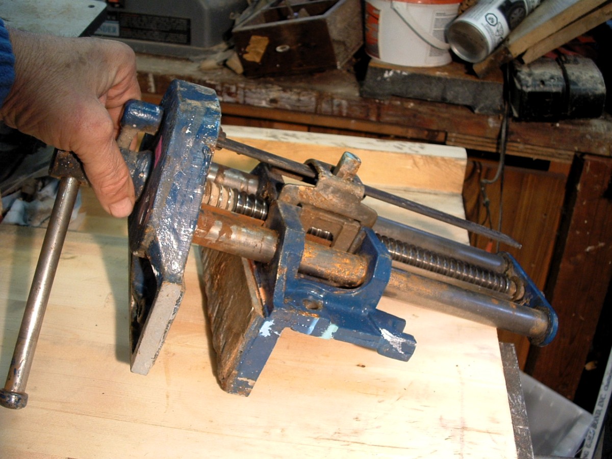

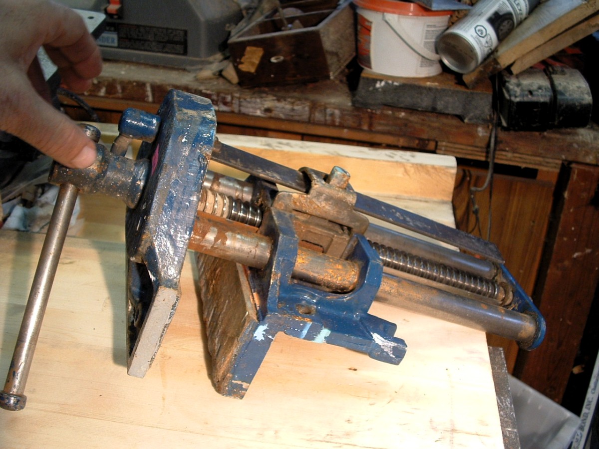

Re: Woodwork bench build
Curious about that lever beside the lead screw. Lock?
Incorporate a 'peg' to engage work pieces with the movable face.
At first I thought that was what the lever was for, but do not see the
rising part'.
rising part'.
That is the quick release lever. Squeezing the curved lever disengages the half nut and allows the moving jaw to slide open and closed. This model did not come with a built in dog but I will add one when I install the wooden faces.JPG wrote:Curious about that lever beside the lead screw. Lock?
rising part'.
