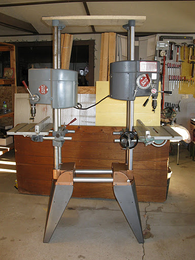

Why would I want to lift one of my ShopSmiths?
[ATTACH]21580[/ATTACH]
- push me - pull me.JPG (72.46 KiB) Viewed 1737 times
I really can not answer that question!! But then I can not think of a reason why anyone would need two Shopsmiths set up as back-to-back drill presses either.robinson46176 wrote:Why would I want to lift one of my ShopSmiths?

dusty wrote:I really can not answer that question!! But then I can not think of a reason why anyone would need two Shopsmiths set up as back-to-back drill presses either.:)
Think longer term set-ups on one of them like a mortising attachment or a pattern sanding set-up or even having one sat up as a shaper...
dusty wrote: But then I can not think of a reason why anyone would need two Shopsmiths set up as back-to-back drill presses either.:)
How about. "Because he can."
Think of it as having both a power station and a crafter's station.beeg wrote:How about. "Because he can."![]()
"Too each machine it's own task".
Besides his storage areas are crammed full of 'parts'.

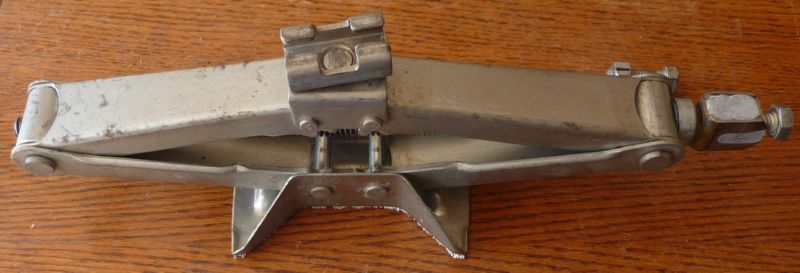

I had a shoulder injury in 1998 that has made it very difficult to raise the headstock vertically. I purchased two Toyota (1978 and 1979) jacks from a junk yard (now politically correctly called Auto Recycling Centers). Cost me $5 then and you can probably get one for about the same price as there is NO demand for them.

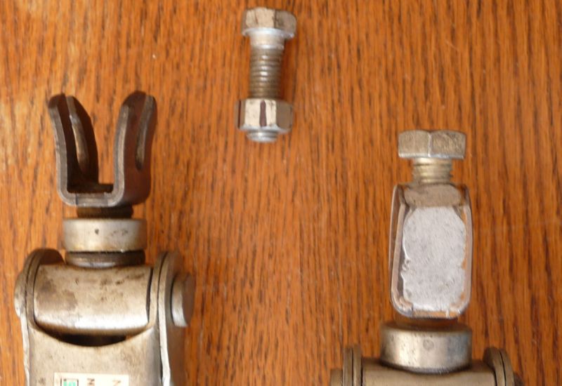

I told my son he could have one and the jack handle since I don't use it. Got tired of looking for it when I needed it so I configured the jack screw as pictured. This way I can just get a socket and speed wrench from the tool chest and raise it
The second picture shows the jack before I cut grooves in two sides of a nut to wedge it in, clamped it closed with vice grips and packed it with epoxy putty. Note the black lines on the nut.

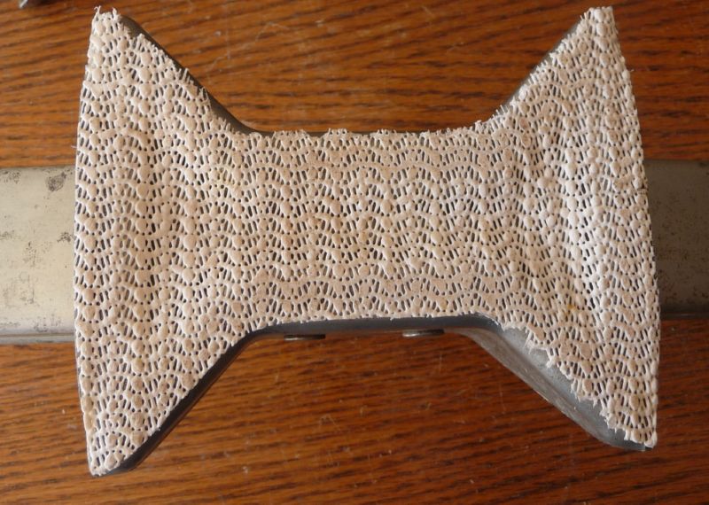

Third picture shows the bottom so It won't mar the table.
The jack is positioned so the the quill is positioned in the center. It cannot come out. So if you get one take some measurements so you get one the right size.
I put the table all the way to the right, position the jack and push the headstock to the right until it is wedged in the top of the jack. A 1/2 turn on the jack to tighten it and then raise the SS vertically. When jacked up all the way it raises it about 1 ft. Lock the headstock, lower the jack, raise the table and repeat. Yes, it's a 3-5 minute process but is cheap, effective and doesn't create any problems that the lift assist seems to.
