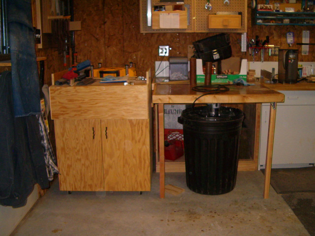

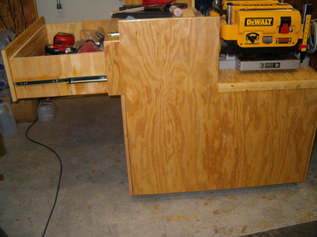

You got excelent advice above in doing over your stand. Thought I'd throw in photos of my stand. It is from plans of "The garage workshop" from Norm Abrham. I had to cut down on the upper level to have room for the planer on the lower level. This cut back the drawer by 2" less deep. No problem.
Side of the cabinet with open tool drawer - this drawer is where I keep hammers and other heavy stuff.
[ATTACH]21844[/ATTACH]
This is the back of the cabinet storage for junk stuff
[ATTACH]21847[/ATTACH]
Here is the cabinet's home - out of the way - you can see the front opening of the lower cabinet
[ATTACH]21846[/ATTACH]
Now days, the front top of cabinet is home to my belt sander.
roll cab't side - open drawer.jpg (124.63 KiB) Viewed 3782 times

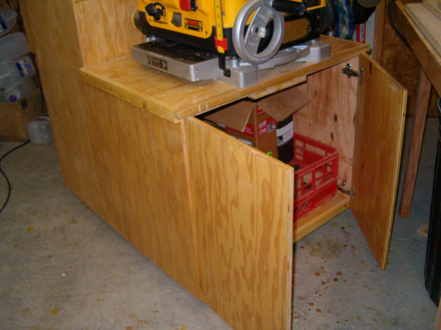

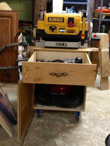

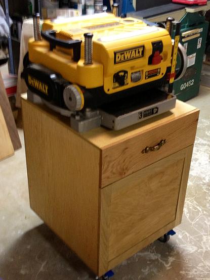

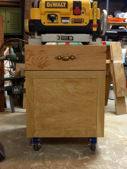

Well, in spite of all the good advice I received to abandon or re-purpose this project, I went ahead and finished the planer stand. I did reinforce the construction with some additional screws through the bottom into the sides and may yet add some through the top. But, surprisingly, this is quite sturdy and rolls readily around the shop with the planer on top, my compressor below and a couple of nail guns in the drawer. It isn't fine cabinetry, but this project involved a number of firsts for me and was a good learning experience.
[ATTACH]22365[/ATTACH]
[ATTACH]22366[/ATTACH]
[ATTACH]22367[/ATTACH]
For me, this was the first time I built and installed a drawer. The drawer is all 1/2 ply (except the decorative/false front, which is 1/2 red oak which I joined and planed from a rough piece of oak I had laying around). The drawer construction is tongue in dado on the sides/front and back; the bottom also sits in a dado. The handle on the drawer was from a set that used to be on our kitchen cabinets until we replaced them. The slides are full extension slides from the Borg.
To install the slides, I went and bought a fancy plastic jig from Kreg that was supposed to simplify the installation. I generally am impressed with Kreg products. Not this one. The magnets built into the jig to hold the slide aren't really strong enough and the first slide wasn't installed square to the cabinet. Ultimately I found I had better luck just drawing a line with a square and using the square to make sure everything was even before marking the screw holes with a punch. I will be returning the jig.
Also a first for me was building installing a door for the cupboard section of the stand. The construction is panel in frame. The panel is ply (slightly less than 1/4 inch) and the rails/stiles for the frame are white oak scraps I had laying around, jointed and planed down to 1/2. The hinges for the door are also from the Borg. Lousy instructions came with them and I had to relocate the upper hinge on the door side.
The finish is simple Tung Oil. Unfortunately, as you can plainly see, the drawer front is red oak and the stiles/rails are white oak. And neither matches the rest of the cabinet which is "sand ply" from the Borg of unknown species. So, nothing matches. But this was more just to see whether I could do it.
Al
