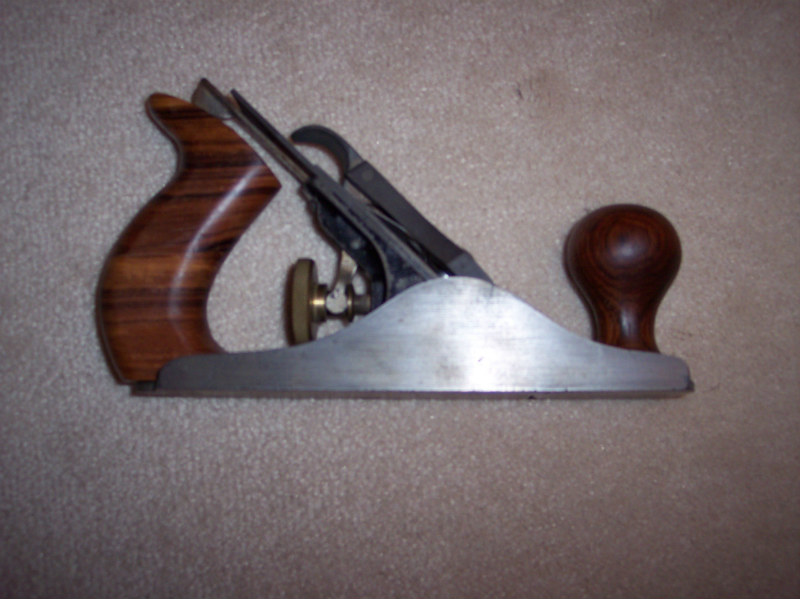

This summer I got it in my head that I wanted a small, No. 2 size, handplane. These have arguable utility but do pull inflated collector prices on the used market. Usually they go for as much as a new Lie-Nielsen No. 2.
I went for a unit with the right front 'shoulder' broken off the cast iron sole. Nobody else bid on it, so the price was to my liking. I'm not equipped for welding or brazing, but I figured I could make a JB-Weld repair. What I did was 3 basic steps:
(1.) Clean up the broken casting void using the Mark V and drum-sander, with the plane on the worktable. Almost like a metal milling project.
(2.) Get an old donor plane, worthless, and hacksaw off its front-right shoulder. Carefully strip-sand its edge contour to fit the radius of the destination's void.
(3.) Epoxy new part in place, after drying smooth up the with strip-sander.
I also made some new handles... another story. Here's my cut-rate No. 2!
[ATTACH]22637[/ATTACH]

Very nice! What kind of wood did you use for the tote?nuhobby wrote:A lot of knife-makers and similar hobbyists use Strip Sanders. Of course, Nick did a sawdust session on making a finger-plane using the strip-sander.

I used some Desert Ironwood. In fact for the rear tote, I had no one piece big enough, so I joined 2 pieces together. Shopsmith horizontal-boring feature is always great for drilling the counterbores and rod-holes in these blanks (in that order, for best concentricity).
Sanded-out JB-Weld looks noticeably lighter in color than cast-iron, I think, with less gloss obviously. One day I might experiment with further 'tinting' on JB-Weld during mix-up. Another thing, which I did on the interior of this casting, was to obscure the glue-line with some black-tinted wax.
I will refrain from calling the No. 2 plane-tote "cute" or "Kardashian-like"
Chris
