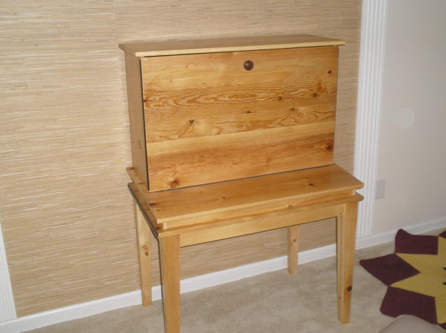

. I find the 15-min-cure epoxy to be highly versatile and tough, and it's supposedly flexible enough to work well with wood's minor dimensional changes.
The Secretary I made 3-4 years ago was all reclaimed wood from a trash bin. I did sort through and use the tougher (Southern Yellow type, I think) pine on the writing surface, with the softer pine elsewhere. I had to fill some knots with epoxy, and it all is still solid as a rock. My nephew uses this desk all the time:
The overall unit:
[ATTACH]22566[/ATTACH]

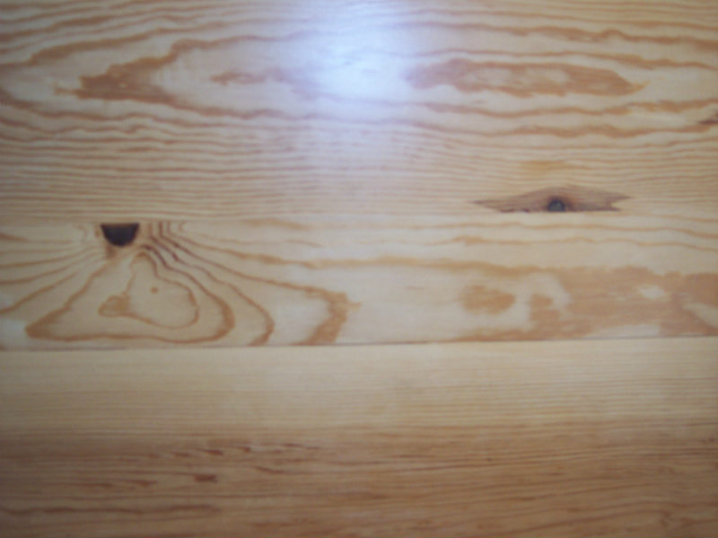

Closeup of a filled knot, from the outside:
[ATTACH]22567[/ATTACH]
Inside (writing surface) view of the filled knot:
[ATTACH]22568[/ATTACH]
The overall unit:

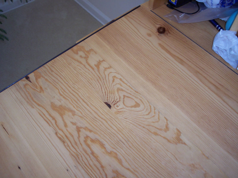

So 24 hours later my 15 minute epoxy is still a little tacky in some places. Is that normal?
Also, what's the best way to remove the excess and smooth it down? On the small spots that felt hard and dry I tried a planer blade out of the hand plane and laid flat on the wood. But it pulled up chunks of wood under the epoxy. My random orbit sander with a half used 80 grit pad did nothing. The handheld belt sander with a 120 grit belt made short work of it, sanded it smooth, but left the epoxy looking very "cloudy" and dull. Is there a better way?
