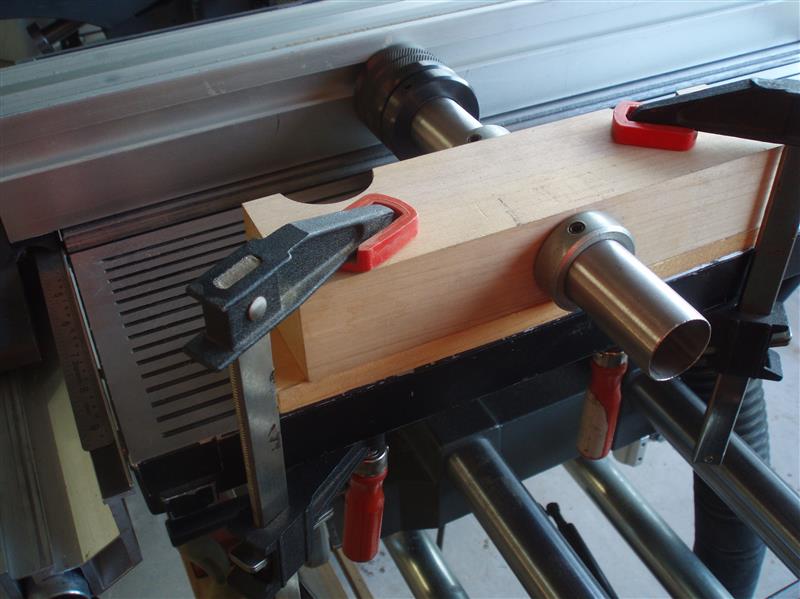

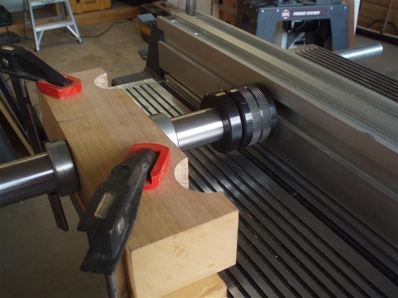

As I stated earlier, this is a great idea. I am making a few changes to meet my own requirements but the concept remains unchanged.
The wood block will be the object of my next changes. I would like for it to be portable from the main table to the extension table and usable either at the edge of the table or in a miter slot.
The block also needs to hold the micro adjuster up off the table top (to eliminate the piece of 1/2 ply that I am currently using.
Somewhat self aligning and portable.
[ATTACH]22585[/ATTACH]
[ATTACH]22586[/ATTACH]
Thanks for the inspiration Benush.
Now I need to order the adhesive tape for my adjustable collars.
[ATTACH]22590[/ATTACH]

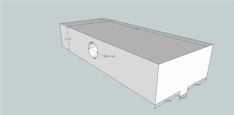

My first design on paper looked similar to what Dusty has designed. The block, rather than being drilled as a complete block was two 2x4s drilled and then they could sandwich an aluminum tube.
The bottom half was attached via T-track to a piece of ply/MDF that had three cleats along the bottom that gave a constant index to the front, back and right edges of the table. That way it wouldn't matter which table (500, 510, etc.) size and the jig could transfer from one table to another.
The top half then would sandwich the aluminum tubing using 1/4 20 bolts with threaded inserts in the bottom.
The T-track was so that the collar could slide the length of the table and be used with or without the fence as a reference.
By determining the precise length of the collar, and a specific mark on the tubing where to attach the collar, marks could be made on the aluminum tubing for quick reference and repeated set up.
A later revision on paper had a short piece of the aluminum round tubing pressed over square tubing and a similar wood sandwich to hold the rectangular tubing and then attach an adhesive back measuring tape to the square tubing as a verifiable reference, probably from the right edge of the table. Research found that there is a 1 1/4" round tubing with a thickness that allows 1" square tubing to have a few hundredths shaved off the corners and fit inside. I'd have to find my notes but I think the round wall needs to be .085. If anyone is interested, I'll post it.

Then I figured I would try the KISS principal and just take a square piece of stock and make a piece for the collar to slide on and see what happened.
I still think that I'll buy a pieces of the round and square aluminum stock and try and build the complicated version.
I'll also see if I can find the "sweet spot" on the fence that allows the fence to,stay true and not deviate from the collar setting position (I know what I meant - but does that make sense?)

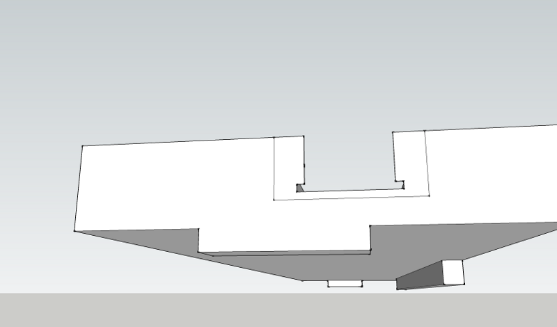

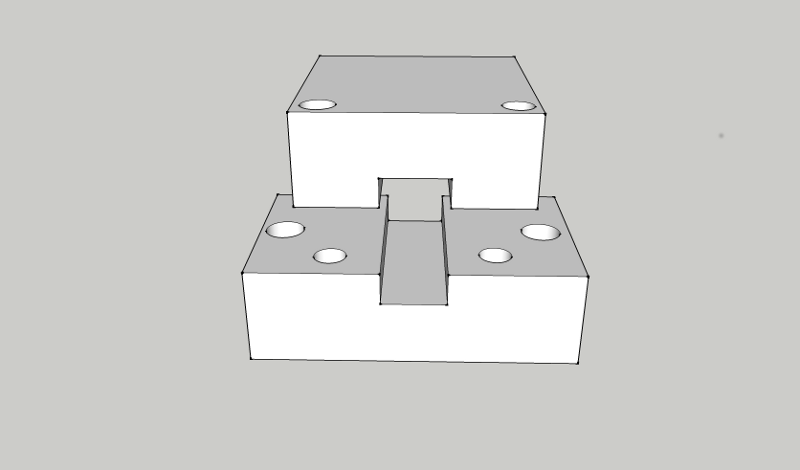

Sort of like this
[ATTACH]22591[/ATTACH]
The larger holes in the bottom half are to attach to the track with bolts and knobs and the sort of matching smaller holes that in "theory go through both at the same place
, would have a threaded insert in the bottom half so you could clamp the top half.
The square groove holds the square tubing
[ATTACH]22592[/ATTACH]
The base is viewed so you can see the cleats along the bottom and the miter T-track from the end. The cleats hold the whole thing so it fits snugly on the table. How it gets attached?? Clamps or maybe the cleat on the right side wraps under the table and then bolts go through threaded inserts to hold it from the bottom?? No, the track is not correct scale, but you get the idea (I hope
Had no clue how to use Sketchup to show a square tube inside a round one (an really didn't want to take the time to try and figure it out), but except for the collar and adhesive backed tape, that should be the pieces.
If the base was placed on the table the same way each time, the repeatability should be plausible.

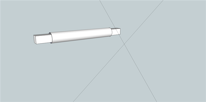

If this is what you are trying to draw, give me your email address and I'll email you the step by step as I did it. I am sure there are many ways to accomplish this. I need you email because I can not (do not know how to) send the Sketchup drawings in a PM or forum email.
[ATTACH]22593[/ATTACH]
But now I would like to know why you need this. Why a stick in a tube? I also do not understand the use of the t-track. What is going to move in the t-track?
