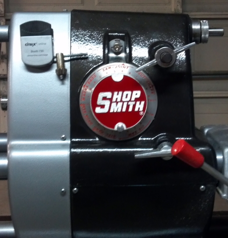

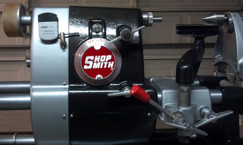

I agree, but I am biasednuhobby wrote:And.... as was said before, don't limit yourself to one color. I think Shopsmith headstocks with 2-tone paints are the bee's knees in handsomeness.
[ATTACH]23111[/ATTACH]
[ATTACH]23112[/ATTACH]
- SSHeadstock.jpg (140.71 KiB) Viewed 1627 times
- SSLathe.jpg (235.41 KiB) Viewed 1630 times

Just a clip magnet from a trade show. It fell of and broke quite some time ago. I now use an old speaker magnet for hanging on to chuck keys.
