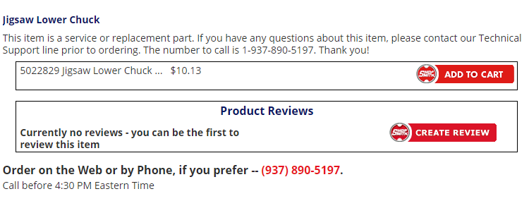

Does anyone have a lower chuck (part #502282) for shopsmith jigsaw model 505644? Mine is stripped inside and I can't chuck a blade.

They have a 5022829 Jigsaw Lower Chuck they show for sale.
Is that the same as yours? You would need to confirm it with them.
Everett

Thanks Everet, I will check with them. My manual doesn't show the 9 at the end but hopefully the parts are interchangeable

Shopsmith sure isn't the company they used to be when I bought the jigsaw. The woman I spoke with told me that I had to make an appointment with an engineer to find out if the parts were interchangeable and it would cost me $20 to speak with one!
I am curious where you found this part number and maybe there would be an exploded parts diagram that would help to determine whether the parts were the same. I looked at the diagram for the newer scroll saw and saw nothing like it.

I tried emailing them and they responded that the parts were interchangeable.Thanks a lot Everett, you helped turn my saw into something workable rather than a boat anchor.
