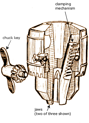

So to summarize, the Morse taper chuck connection is not an issue on a Shopsmith. Neither is the spindle-bearing radial-load capability (unlike a generic drill press). Which leaves the chuck itself.
[ATTACH]25397[/ATTACH]
The chuck jaws are basically wedges that are driven tight against the tool shank by a screw thread. I can see three issues that could affect the gripping stability:
But when pen turning, the other end of the workpiece is supported by the tailstock. The tailstock shares the radial load and prevents the pry-bar effect.
- The 120 degree spacing that JPG already mentioned, which arguably could reduce the load capability when the side load is midway between two jaws,
- The relatively short length of the tool-gripping surface, and
- A poor fit of the jaws to their guide slots.
- 3jaw_jacobs_chuck.gif (20.61 KiB) Viewed 3740 times
Thanks for the picture! Now I know what to expect when I pry my ball bearing chuck apart to replace the jaws.
