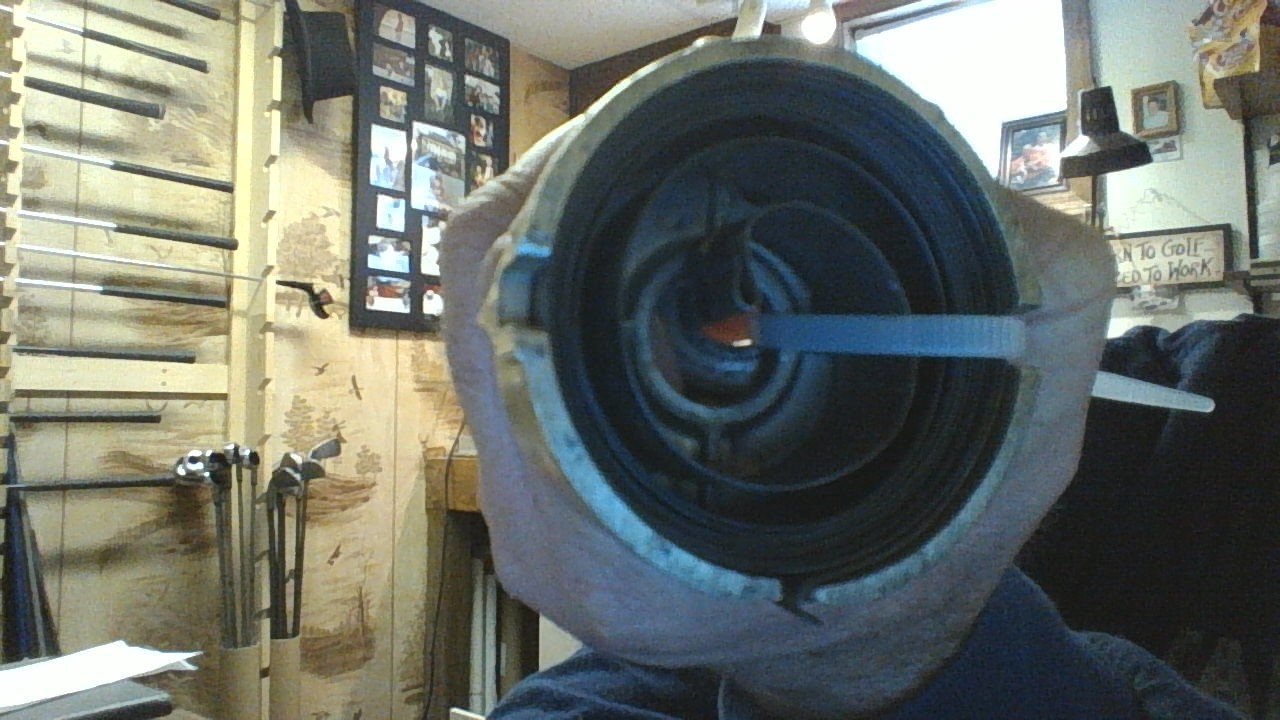

The end is broke off at the end , just part of the hole is left...I'm new here give me a min. and I'll figure out how to send you a pic..

That is a typical failure. Just drill a hole that the "pin" will fit into and a second hole that is the diameter of the shoulder of the pin so when the tension is in place it holds.

Since you have another unit to use to fix this one, that is what I suggest. These springs are not made anymore (that I know of) and are pretty easy to fix. When I did mine, I just pulled out enough to drill it, held it in place with wood and a couple of clamps and drilled. It took 10 mins .... maybe .... :D

It may be light playing tricks, but it looks like the hole(s) might still be there(or at least part of them).
Pull it out a couple(only) of turns. You MAY be able to 'unfold' the end.

drilled two holes in the end of the quill spring,one big for the pin to go into and one small for it to lock into, ground out between them and works great. Thanks for the tip Dick. I didn't even pull the spring out.... just the end, held it out with a screwdriver, put it against my vice and done.
