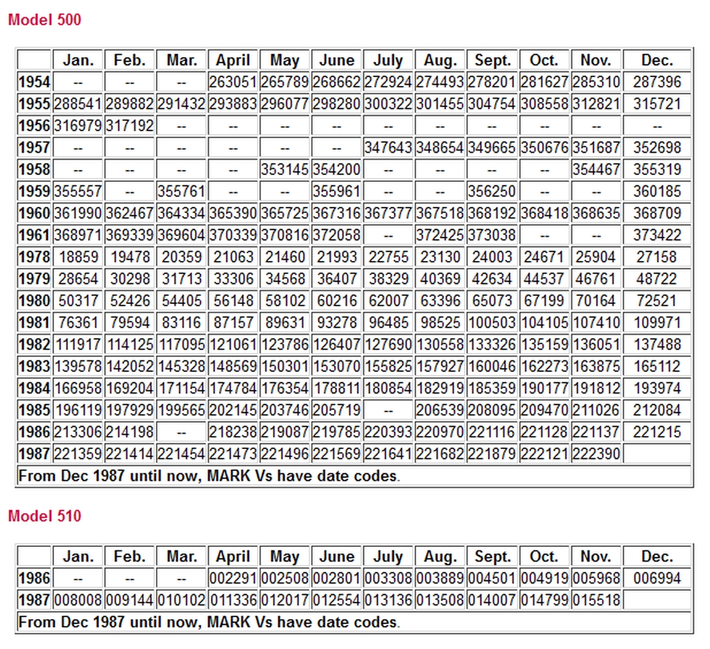

SNchart
This chart is not easy to stumble onto(unusual path to find it IMHO).
[ATTACH]25733[/ATTACH]
- SN chart expanded.jpg (732.91 KiB) Viewed 3123 times
JPG40504 wrote:This chart is not easy to stumble onto(unusual path to find it IMHO).
That's odd. It looks just like the one referenced in post #5 of this thread. I have probably posted this link a dozen times in response to questions of age.
Be aware that the manufacturing dates for most of the Shopsmith equipment is posted on the same link.
PS NO! Not that same link. A little bit further back. Click on "Can you tell me how old it is?" Then scroll to the bottom of whatever page shows up. If the chart exists, it will be there. Not all equipment is so charted.
SS says it is Mark V 500
I followed a link in the reply to a SS customer phone number that actually resulted in talking to a person. After questions about the S/N, table size, and headstock color/texture, she informed me the machine is a Mark V model 500, produced sometime in the July - August time frame in 1981. I told her I never would have been able to interpret that from the table. She agreed. Thanks to all of you for weighing in on this. Now I just need to find the lower guard. . . .
dusty wrote:That's odd. It looks just like the one referenced in post #5 of this thread. I have probably posted this link a dozen times in response to questions of age.
Yep, the same chart.]was[/B] quarter of a year ago!
As usual SS ignores its own creation of Mark5s.woodboats wrote:I followed a link in the reply to a SS customer phone number that actually resulted in talking to a person. After questions about the S/N, table size, and headstock color/texture, she informed me the machine is a Mark V model 500, produced sometime in the July - August time frame in 1981. I told her I never would have been able to interpret that from the table. She agreed. Thanks to all of you for weighing in on this. Now I just need to find the lower guard. . . .

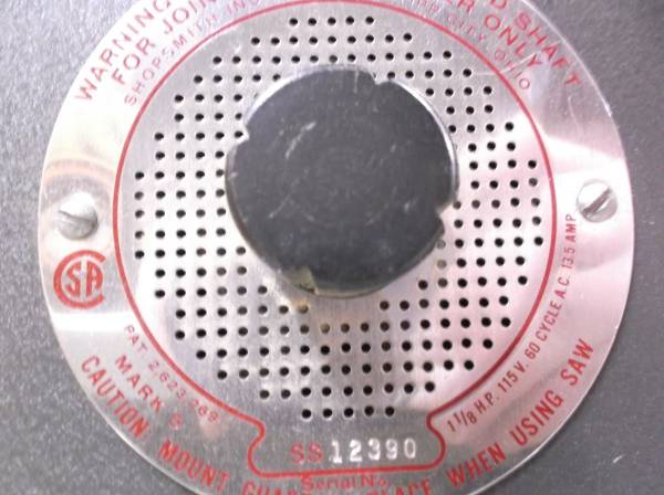

Hello all,
I have yet to purchase a Shopsmith Mark V, but I may be doing this, as early as 3/15/15.
My question is: is the number shown on the attached photo a date code or a serial number? And yes, I have reviewed the graph that was listed (above), within this thread, but I do not see a 5 digit number (12390) anywhere in the graph.
My main reason for wanting to know this is, I would like to know the approximate age of the machine, along with, was it purchased as a 500 or 510?
Please advise and thanks in advance!

- Question: is this a "date code" or a "serial number"
- SS7.jpg (40.74 KiB) Viewed 3030 times
