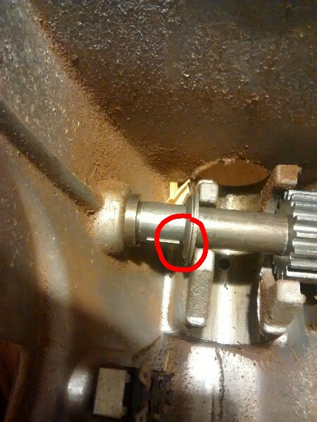

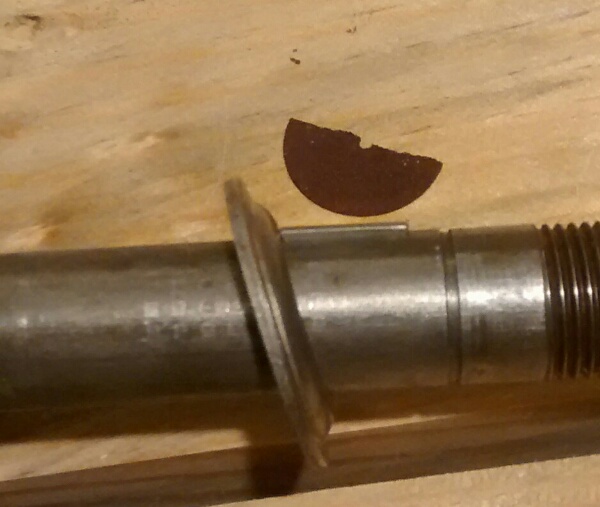

If I understood you correctly about the quill feed shaft not moving laterally though it rotates (and it is unlikely I did)... I ran into a problem yesterday where I could not for the life of me pull the quill feed mechanism out to the side. Turned out the small woodruff key had rotated in its slot so one end was higher, the one , say, on the left if I was trying to pull it out to the left. Think a quarter cut in half inserted in a slot with a curved bottom, it rocked just a little and hung up. Ah I'll just post a photo in a second post in a moment...

OK, these might make more sense:
[ATTACH]24876[/ATTACH]
Here you see the key and the washer it fit hung on which in turn it jammed against the case.
[ATTACH]24877[/ATTACH]
Here it is removed with a half a dremel cut off wheel behind the key showing a much much exaggerated view of how the key had rotated in its slot.
Note you'd pull to the right in these photos, not left as I wrote above.
Again, this may well not apply, but it just might apply to that one more art of your situation It is to late for my brain to follow the thread properly. You can always ignore this. The above had me stumped because the other headstock I got with this one can't right apart the day before and I could not see it binding.

Fitz, you are on CA time right, good for me, I burn it at both ends!!!!! NO the quill feed spindle shaft does not turn, it is corroded frozen, keeping me from fully extending the quill assembly fully to remove it.

My Dear Watson, I think you may have it!!! I dont think that is it Fitz, but worth scrutinizing, since the motor is out and the HS is in the drill press position, at eye level. I can look right in there. I will check that out tomorrow pm, since I will be out buying the ER 10 you gloated me into with your shopping spree n San Fran.
The washer is not the problem. The sleeve will not move.rbursek wrote:My Dear Watson, I think you may have it!!! I dont think that is it Fitz, but worth scrutinizing, since the motor is out and the HS is in the drill press position, at eye level. I can look right in there. I will check that out tomorrow pm, since I will be out buying the ER 10 you gloated me into with your shopping spree n San Fran.
The pinion gear should clear the ear(It has to to reach the quill). The shaft should move inside the spring housing(up to the point of the stud on the shaft and spring contacting the inside of the housing).
As I recall MickyD had a similar issue with his 10ER(siezed quill feed shaft in CI headstock). 10" bolts used as lever with sledge(or pipe) was the 'solution'.
