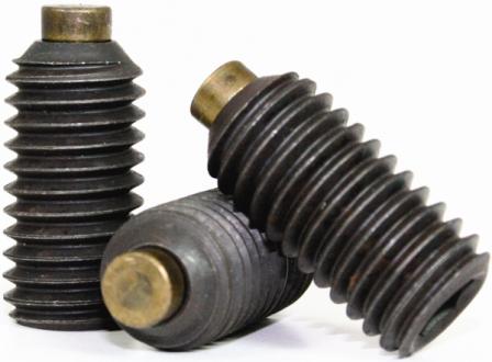

Which one should be used for what purpose?
To me like the oval point would work well for mounting arbors unless the hole is at an angle then a flat point might be best.
What about set screws for mounting router bits? Certainly not a cup center.
Would set screws with brass tips work for mounting router bits without damaging the shank?
[ATTACH]25156[/ATTACH]
Set Screw Brass Tip.jpg (44.19 KiB) Viewed 2417 times

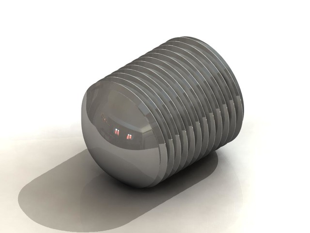

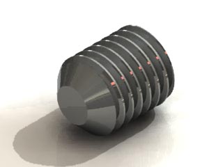

Post by rlkeeney »
Seems like the flat point and the oval point would be the best for mounting pretty much anything that isn't permanent.
[ATTACH]25157[/ATTACH]
[ATTACH]25158[/ATTACH]
I use my Shopsmith outside and I can just see me dropping a set screw and never finding it. I'd like to have a stash of the right ones on hand just in case.
Set Screw Flat Point.jpg (22.69 KiB) Viewed 2411 times
Set Screw Oval Point.resized.jpg (47.65 KiB) Viewed 2411 times

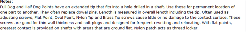

In my opinion, the best source of information needed to answer these questions is the individual users manual.
Brass points are soft so as to not damage the mating surfaces. Router bit shanks are certainly not soft or thin.
The set screw for mating with the the Shopsmith spindle is set at an angle because the spindle shaft is tapered. Therefore, flat meets flat
An excerpt from Fastenal Spec Sheet:
[ATTACH]25159[/ATTACH]
Capture Set Screw Applications (Custom).PNG (79.08 KiB) Viewed 2410 times

dusty wrote:Brass points are soft so as to not damage the mating surfaces. Router bit shanks are certainly not soft or thin.
Years ago I damaged a router bit shank with the set screw and stopped using it because of this. Perhaps I need to dig it out and see if It has the correct set screws in it.
