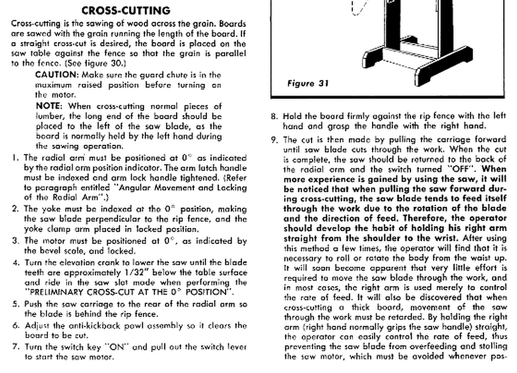

I thought I remembered reading the exact opposite advice somewhere, but couldn't remember the underlying reason. This is a serious safety consideration, so I took a couple of minutes to find it. (It wasn't too hard, because I've only read 1-1/2 books on radial arm saws.charlese wrote:Once again, I'll repeat what is said in most Radial arm instructions. It completely avoids "blade climb". The saw cut should be started on the operator's side of the wood and PUSHED through the wood to make a cut. This also holds the wood tight to the fence.
I know most users pull the spinning blade through the wood, but this is an operator error.![]()
If you have a Shopsmith RAS, carefully read the instructions and you will find the pushing through instruction.
In the section on cross-cutting, Wally definitely instructs the RAS user to pull the saw through the board. Then he adds the following advice:
[ATTACH]25565[/ATTACH]
As I understand it, the problem is that when "push-cutting", the blade engages the workpiece on the up-stroke, and thus can attempt to fling the front edge upward.
This is also the root problem with ripping on a RAS (assuming that you feed the board from the correct direction). DeWalts do have a provision for restraining the board from lifting while ripping (using the leading edge of the blade guard). But a lot of users don't know how to use the saw properly -- thus the hazard.
Perhaps for cross-cutting, the Shopsmith RAS has a safety workpiece hold-down not found on a DeWalt?

From Craftsman ras manual.
[ATTACH]25572[/ATTACH]
- ras cross cutting.jpg (451.96 KiB) Viewed 1378 times

Never Never push a radial arm blade against the work. On the inboard side of the blade the teeth are rotating up. Pushing the blade into wood so the inboard side of blade contacts the wood first will cause the wood to picked up and hurled pass the fence.
Never saw instruction that even remotely suggested that. The Shopsmith Sawsmith instructions don't, nor does the craftsman radial arm instructions, nor do any radial arm books that I have read.
In fact many instruction suggest turning the saw off after the cut and before returning the blade/carriage back to it's home position.
A negative hook angle blade and good procedure will result in safe and accurate cuts on a RAS. Never put a hand inline with the blade, always keep it safely to either side.
