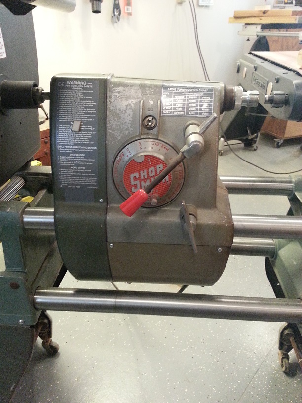

Finally got around and changed the belt sander around. I cut the tubes too short for it to work.JPG40504 wrote:1) Remove the hub from the 'right' shaft.

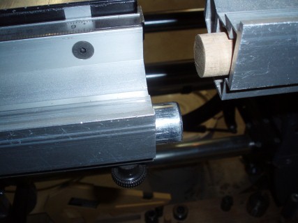

Test Post
to be removed immediately.[ATTACH]25564[/ATTACH]

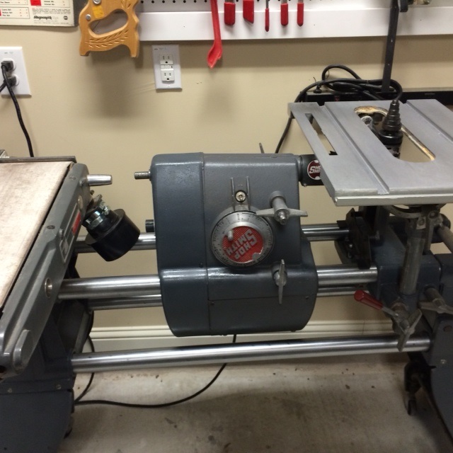

I cut 16 inches off of my tube set. Here are some pictures.
Start Disclaimer: You will need to decide what meets your application. I did all of this as a "dry fit." Please don't cut based on this and then complain if it doesn't work for you! End Disclaimer.
Note: I don't have the rubber collar on the tubes of either of my SS. Do I need it??

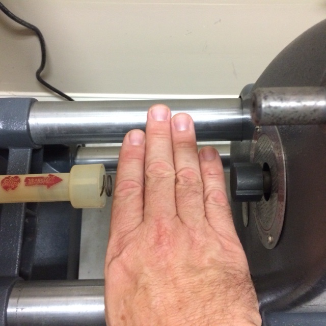

This shows "shorty" with the Speed Increaser installed and the coupler on the jointer. Looks like the fit is OK. I can slide the head back and disengage it from the Speed Increaser. The "4 fingers" of space were taken with the SI engaged, so you should be able to accommodate the SI and the Jointer on the machine at the same time.[ATTACH]25559[/ATTACH][ATTACH]25560[/ATTACH]

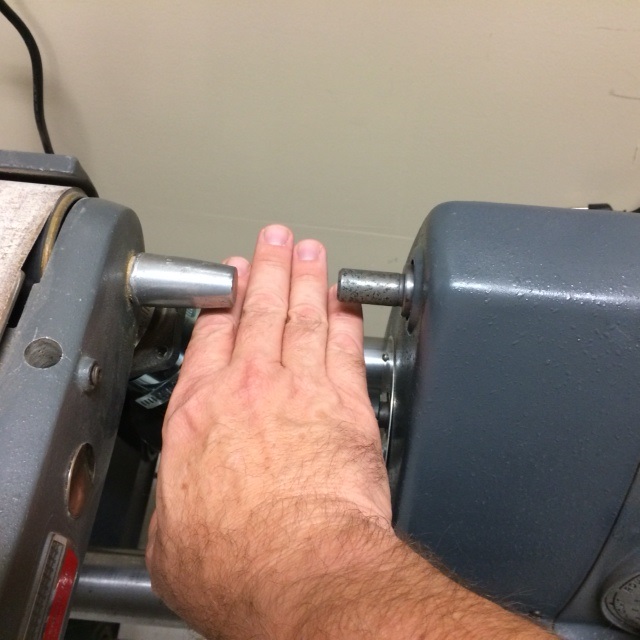

The belt Sander is a different story. With a 16" tube cut and the SI engaged to the right, there is no room for the coupler to the sander on the left.. You would need several additional inches of tube to make this work.[ATTACH]25561[/ATTACH][ATTACH]25562[/ATTACH]

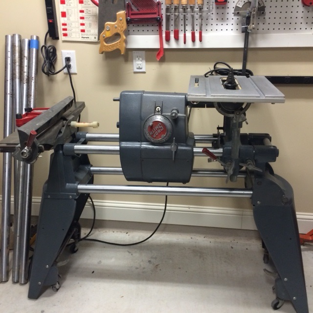

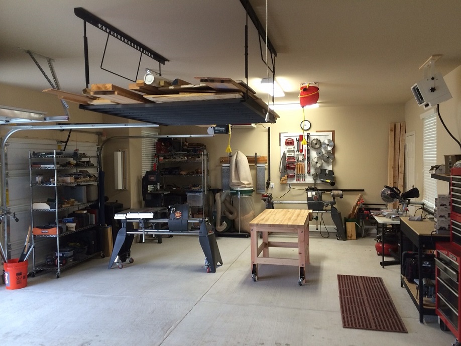

Also, I thought that I would throw in a picture of my shop in our new home. We have a 3 car garage with a 5 foot width extension. Cars go in bay 1 & 2. The shop lives in the other 1.5 bays. I'm standing in bay 1. Overhead wood storage is in bay 2. The Shop takes up the rest. "Shorty" was still "long" in the picture. One thing that I'm glad that I got was a butcher paper roll and holder. You will see it hanging on the left side of the picture. It is great to pull off a sheet to cover the workbench when doing messy stuff!
[ATTACH]25563[/ATTACH]
