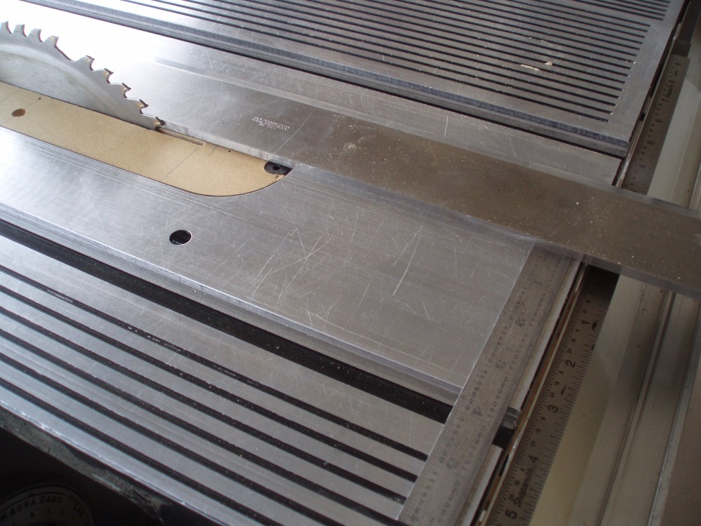

I have been toying with a different method of measuring for parallelism. Using the one tooth in two locations (front and back rotation) is using two points of measurement along the cut line that are at most 10" apart.
If you make that same measurement at the front edge and rear edge of the table, you are using two points of reference along the cut line that are 22" apart.
[ATTACH]26192[/ATTACH]
With this setup, I measure mine blade right now at 3 36/64" and 3 37/64". See the attached image. If you want to be declared radical you could measure this with a micrometer rather than a ruler.
That is a reliable straight edge (a Starrett) positioned so that it just touches the tips to two teeth (front and rear) on the blade. I measured from the edge of the straight edge to the edge of the miter slot. The edge of the miter slot could (should) be better defined by having a runner in the slot that rises above the table top. My tables have been used extensively and they show the wear and tear. The edges are no longer clean and sharp.
I was pleased when I made these measurements today. It has been a couple months of regular, daily use since I did a table alignment check.
