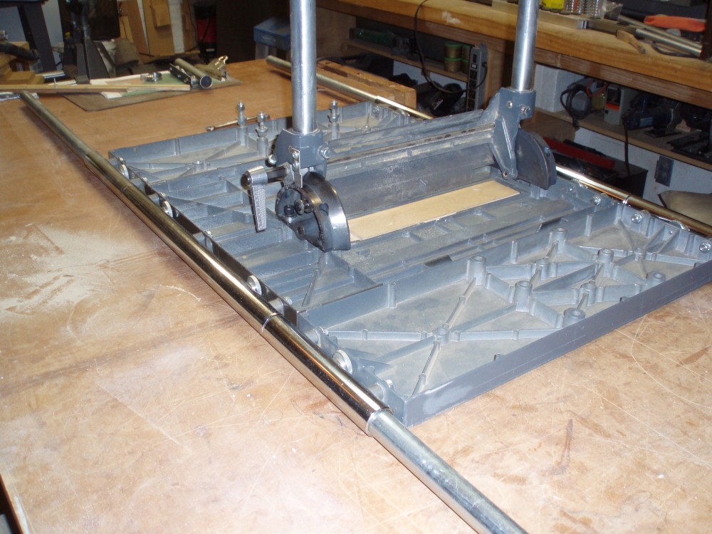

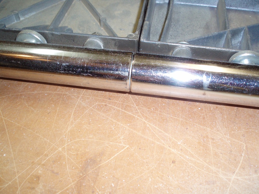

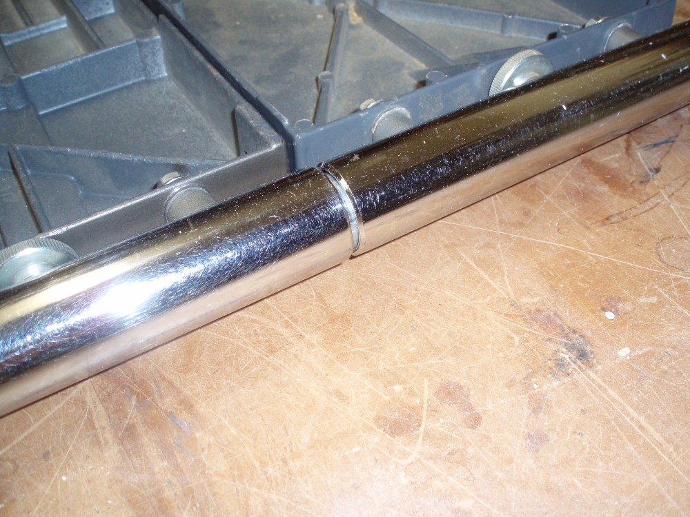

Mark V Model 510 Table Alignment (one to another)
Mark V table alignment takes time but it is a simple task. When I need to do mine, I do it on the work bench. Doing it this way, the table tops are always in the same plane and my only task is to install/align the rails.
[ATTACH]26218[/ATTACH]
[ATTACH]26221[/ATTACH]
[ATTACH]26222[/ATTACH]
The gap between the bench tube and the lower surface of the rails (on mine) measures .356". I had a piece of hard wood cut for this purpose but it is now hiding somewhere (probably in the shop on my other work bench).
Only after I have completed this alignment do I remount the tables on the Mark V. It is then that I align the extension table to the Main Table.
If you have only one extension table, align it to the side of the Main Table that you are most likely to have it mounted. Once aligned there, it may not be aligned to the other side.
