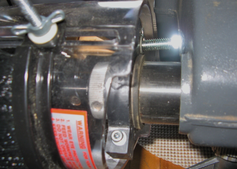

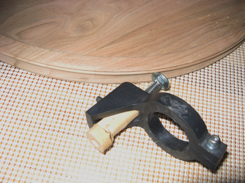

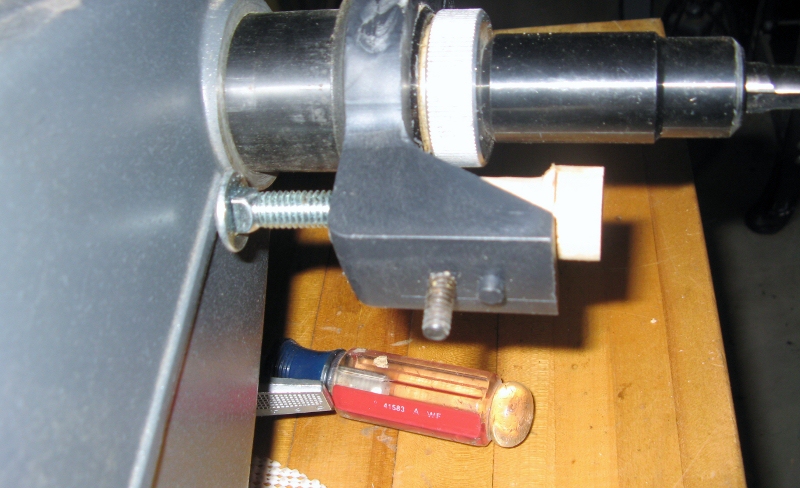

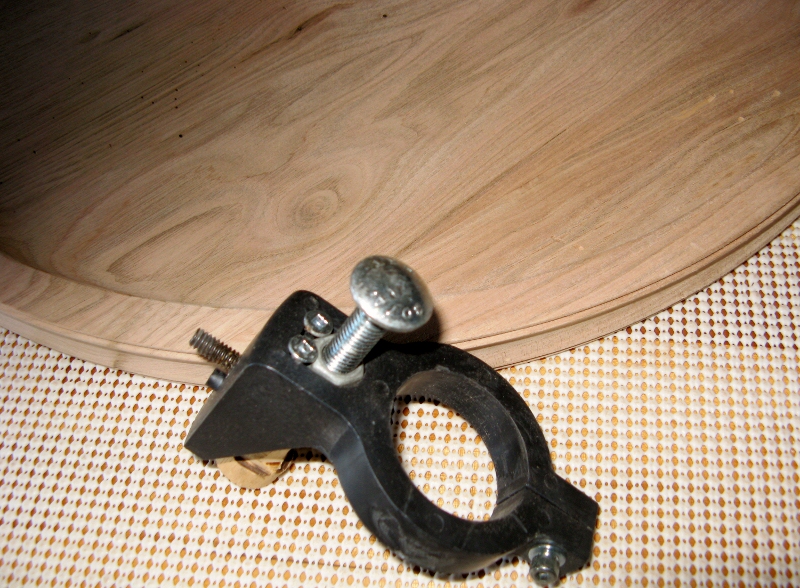

My fine adjustment approach
Post by STB »

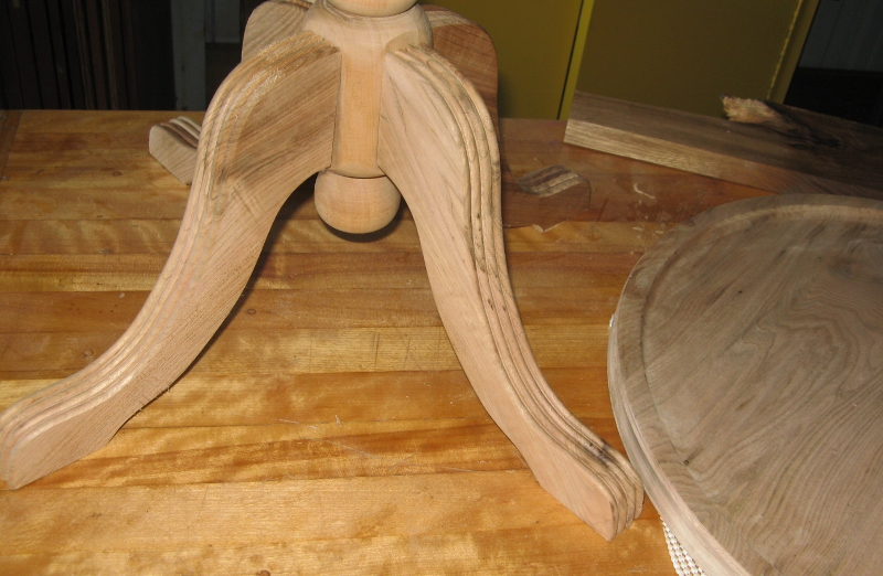

My current project is a round table with the center routed out and a decorative edge. A cove in the center and a bead at the outer edge of the cove. The table top is 7/8 in thick
I used the straight bit that was included with the mortising package to cut the round table top and to rout out the center.http://www.shopsmith.com/ownersite/catalog/rm_slotmortising.htm
I used shaping cutters to make the decorative edge profile. http://www.shopsmith.com/ownersite/catalog/ms_shapingpackage.htm
So this was my solution (in Pictures) to the fine adjustment dilemma.
Note: the power head is laying on the bench when I took the pictures.(don't ask why )

Very nice work, Glenn!!:)

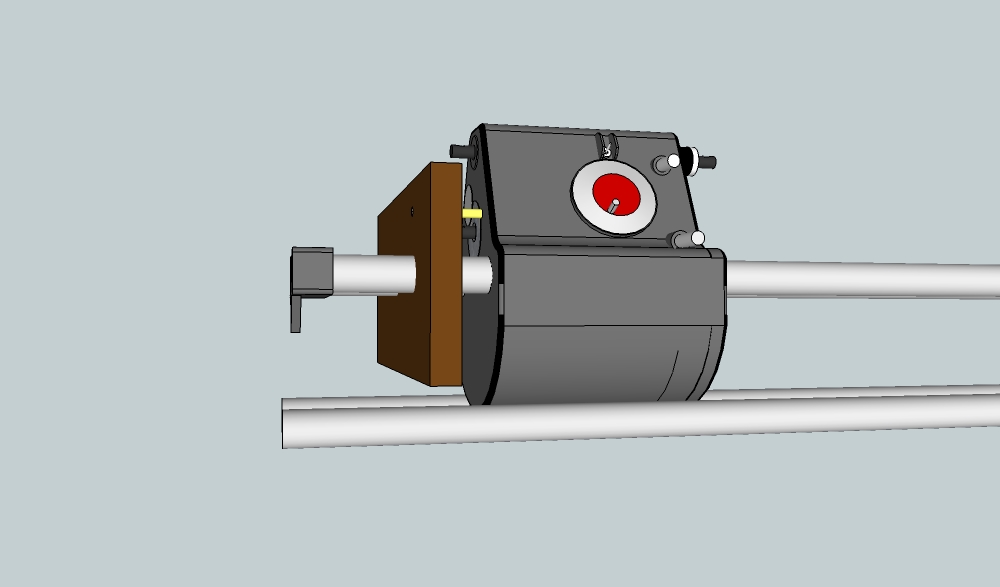

Forrest,
Would the following work?
Use a 2by12 clamped to the way tubes with a large hole bored to allow a stove bolt to pass through. Sink a nut into the 2by so that the stove bolt can thread into it.. Bore and split the 2by so it can be clamped to the way tubes (how you clamp it is up to you. And the drawing doesn't show the board split.
Insert the stove bolt, move the assembly so the top of the bolt presses against the headstock and clamp the jig tight. Loosen the head stock, thread the bolt up or down as needed for fine tuning, tighten the headstock and make your pass.
Forgive the crudeness of the drawing, but i have not the skill to make a threaded bolt, but the yellow piece (for highlighting) is the bolt and it is in horizontal mode(I'm too lazy to tilt the drawing 90 degrees) :rolleyes:
[ATTACH]26180[/ATTACH]
Maybe it would not be stable enough, but I think it is simple enough make.
Anyway just a thought. And thanks to Science guy for the use of your mark V drawing
Be well,
Ben
