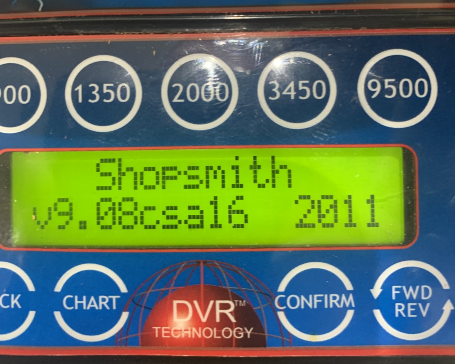

Yes, I think it's down to rotational inertia, speed controller feedback, and vibrational harmonics. I'm not sure what other attachments I could turn safely at 3450 rpm besides the jointer or the table saw to test it. It doesn't happen with an empty spindle. I installed my DIY PP upgrade 3 years ago, but it still has the 2011 firmware. Does anyone know if there is a later version and if so, whether it's possible to update it?
Firmware version.jpg (214.16 KiB) Viewed 940 times

edma194
Posts: 2205
Re: PowerPro Rattle on Startup
Post by edma194 »
I'll check both of mine. One from 2011 I think, the other a few years later. You can run a 12" sanding disk at 3450. You can run a saw blade on the right side of the headstock and a sanding disk on the left side at the same time. Running something on the left side and not the right will reveal if rattle is dependent on which end of the headstock is driving something. CAUTION!! It is dangerous to run a saw blade on the left side of the headstock with no blade guards!!
Ed from Rhode Island
edma194
Posts: 2205
Post by edma194 »
Older PowerPro shows version 9.02xa05. Newer PowerPro shows version 9.08csa16 like yours. The older one is in a 2011 headstock, looks factory installed, I know nothing about the history of this machine. The newer is a self-upgrade from some later date. I did encounter some rattling with the bandsaw on the newer PowerPro for a while. Went over the machine to lock everything down and what was left seemed to be the motor cranking up. I believe this was on the 1/4" hardwood setting, I don't recall the RPM. It wasn't consistent though. The bandsaw is now connected to the old PowerPro but I haven't tried it yet.
