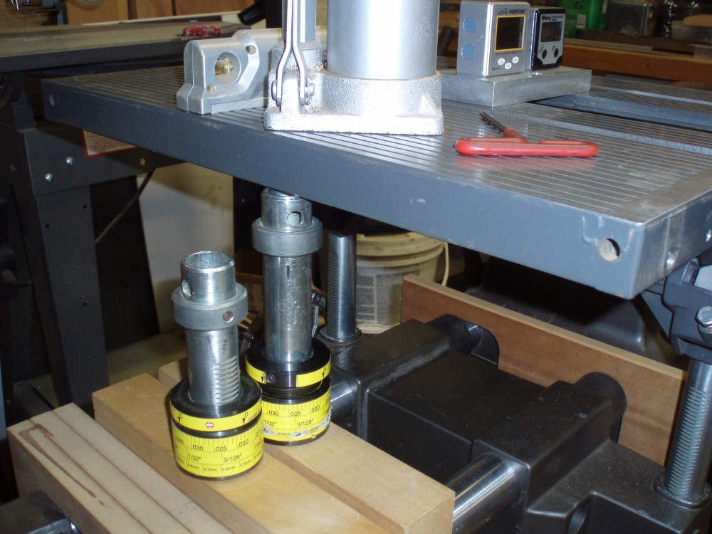

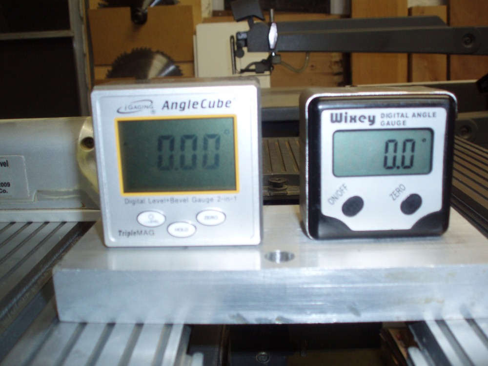

I also hope that I get similar results. After playing with two table assemblies for nearly three days now, I can find nothing that looks as though it would/should cause my slippage problem. Droop as Forrest says.
PS: I have initiated a "droop test" on the eBay main work table. If this works out satisfactorily, I will realign and retest both my Shorty and my GoTo machines.
Note: The table is not supported by the table leg with the adjustable stop collar. It was used to achieve the 0° tilt (90° to the blade) and then the tilt lock was secured. With the tilt lock secured, I backed off the adjustable stop collar. It was left in place so that if the tilt lock slips the bottle jack will not be dumped on the floor. I have three digital gauges in place to collaborate the resulting readings.
[ATTACH]26747[/ATTACH]
[ATTACH]26748[/ATTACH]
The Droop Test 003 (Custom).jpg (130.43 KiB) Viewed 3494 times
The Droop Test 004 (Custom).jpg (176.73 KiB) Viewed 3497 times
