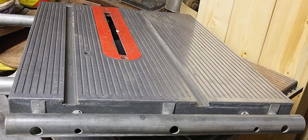

These are the two versions that I know about.
[ATTACH]26785[/ATTACH]
[ATTACH]26786[/ATTACH]
The ribbing on the work surface is the major visual difference. The one with less ribbing is the later model. The one that is ribbed all the way across is my preferred model.
The small rectangular protrusion at the corner has no functional value that I am aware (except maybe during the manufacturing process). I dislike it because it prevents the tables from coming together like the older tables do. Strictly personal preference.
Disregard the rails. The round rail can be used on either table. The extruded rail can be used on either table but the extruded rail makes it a 520 configuration (not what you asked about).
Hope this helps.
A third version. An early 510. Attaching screws are accessed through the holes. Also notice the different 'thumb' screws that secure the tubes to the inside of the rails. The center screw location is different from the later ones.

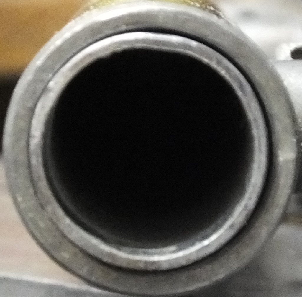

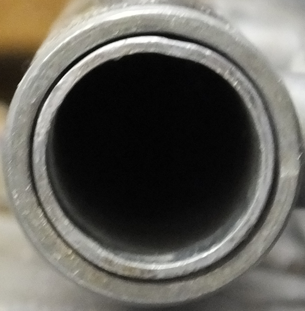

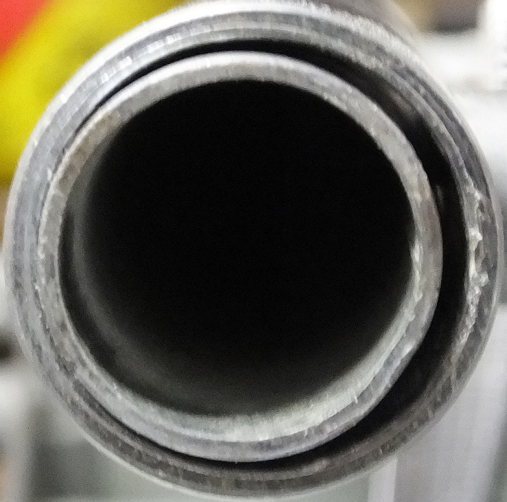

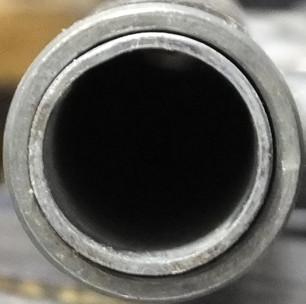

But I think the 'goof' was the newer 510 with the larger id rails.
Here is a 'new' floating table with the tube clamped. Notice the amount of clearance towards the table. It seems to be centered vertically even though the other end of the tube is dangling. There also seems to be no play at the other end of the rail due likely to the central location of the clamping screw.
[ATTACH]26815[/ATTACH]
Now for a look at older main table 'action'.
Notice the lesser amount of clearance at the table side of the rail. This is with only the closer clamping screw tight(the main table has two clamps).
[ATTACH]26816[/ATTACH]
Same but with only the far clamp tightened. Not quite 'centered' vertically, but closer and not quite centered horizontally.
[ATTACH]26817[/ATTACH]
And finally with both clamps tightened.
[ATTACH]26818[/ATTACH]
This illustrates(sorta) the incompatibility of the new/old rails. The tubes are positioned further apart(horizontally) since the overall front to rear spacing of the rail outer walls is the same. That extra gap increases the tube spacing front to rear(further apart).
Now this was all done with the tubes subject to gravity. If the tubes were secure and the table subject to gravity I expect the centering to be less concise due to the weight of the tables. However the tubes are the floaters typically with an extension table but the opposite is true with the floating tables. I do not have a way to try this in a more normal setup(mounted to a carriage etc.).
The apparent greater bottom gap in the last three pix is likely due to parallelax.
P.S. I think gravity was the reason for the 520 change. The top referencing and bottom clamping eliminated those variations. Also provided a stouter resting place for the heavier fence.
