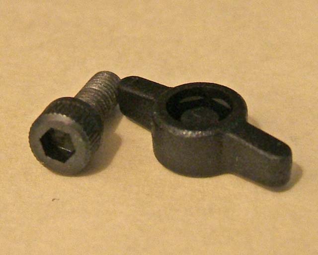

I have bought internal wrenching (socket head) bolts and their knobs and pressed the knobs onto them. My local Ace Hardware has the bolts and knobs in stock, the screws come in assorted lengths so you could get 1/2" length. I think the thread size on mine is 5/16" 18. They also have the round knobs but you can get more torque with the propeller style and getting them tight enough will prevent them from slipping in use.
[ATTACH]1211[/ATTACH]
bolt & cap.jpg (56.81 KiB) Viewed 8136 times
Jim in Tucson

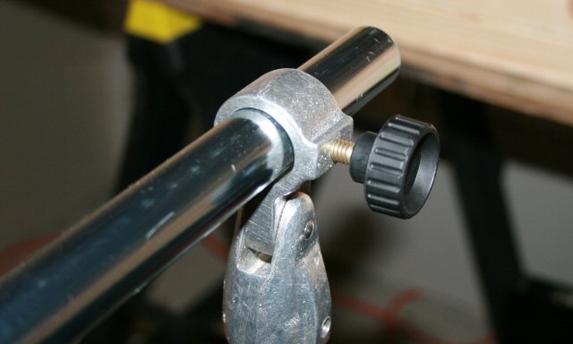

A partial shipment of knobs arrived while I was away. The knob itself is the perfect size for the support legs:
[ATTACH]1220[/ATTACH]
The knob falls to hand very easily, is easy to loosen/tighten, but is small enough that it doesn't get in the way. I'm very pleased with the choice.
The stud length is a little too long. I wanted 1/2" but they only had 3/4".
To trim the stud, I'm going to thread two 5/16" nuts on and tighten them against each other to act as a stop, hacksaw the end off against the end nut, pull the nuts back towards the knob, clean up the end with a grinder or maybe some emery cloth, then thread the nuts off which will clean up the threads. By grinding/sanding the end of the stud flat, it won't mar up the tubes when tightened. Plus, since the knobs will stay threaded in the leg bracket, there's no need to taper the end so it threads in super-easy.

1/2" bolts are too short by a hair unless the thread runs all the way to the bolt head. I thought about drilling out the top of the thread on the leg to accommodate the un-threaded top of the bolt but decided to just go with 3/4" bolts.
