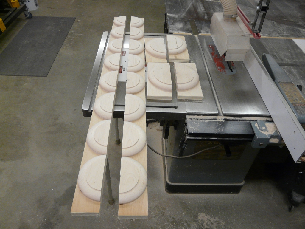

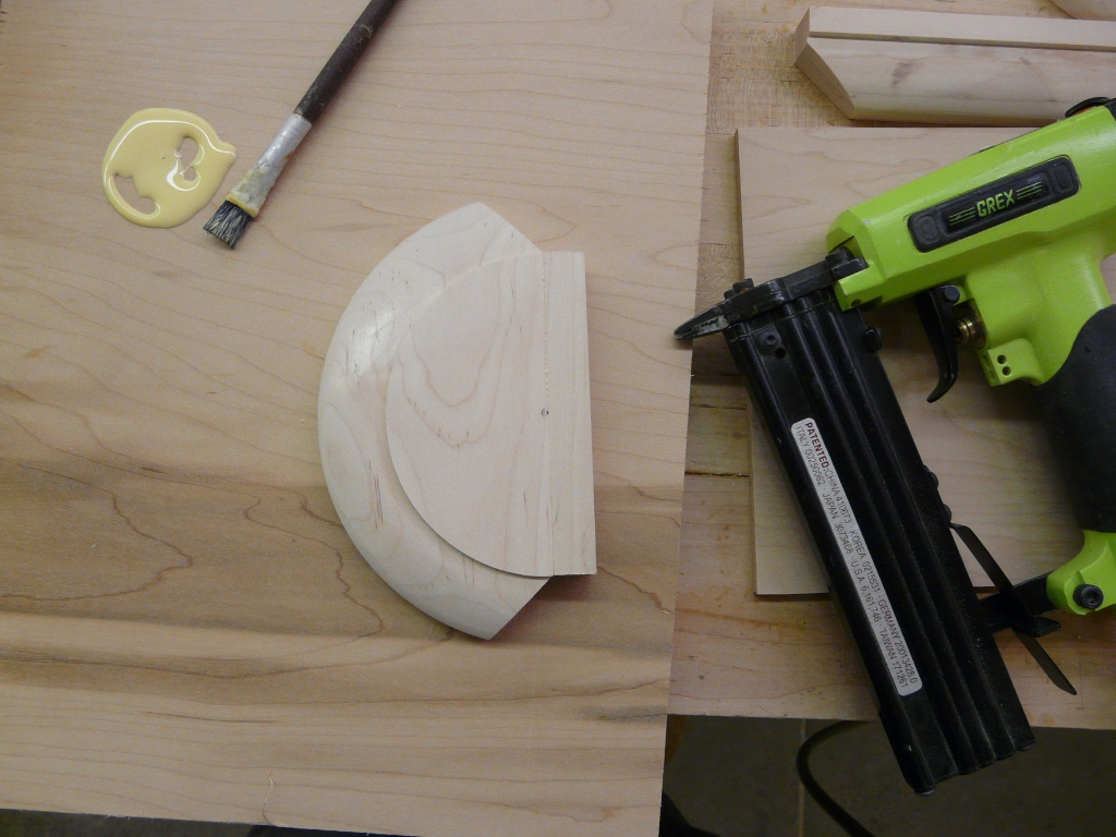

Ok let me back up a little.  The pieces on the right are ripped as a full half circle.  The pieces on the left are the thickness of the saw blade smaller and are the scrap hence the nails through the face..jpg
Ok let me back up a little. The pieces on the right are ripped as a full half circle. The pieces on the left are the thickness of the saw blade smaller and are the scrap hence the nails through the face..jpg (398.6 KiB) Viewed 72248 times

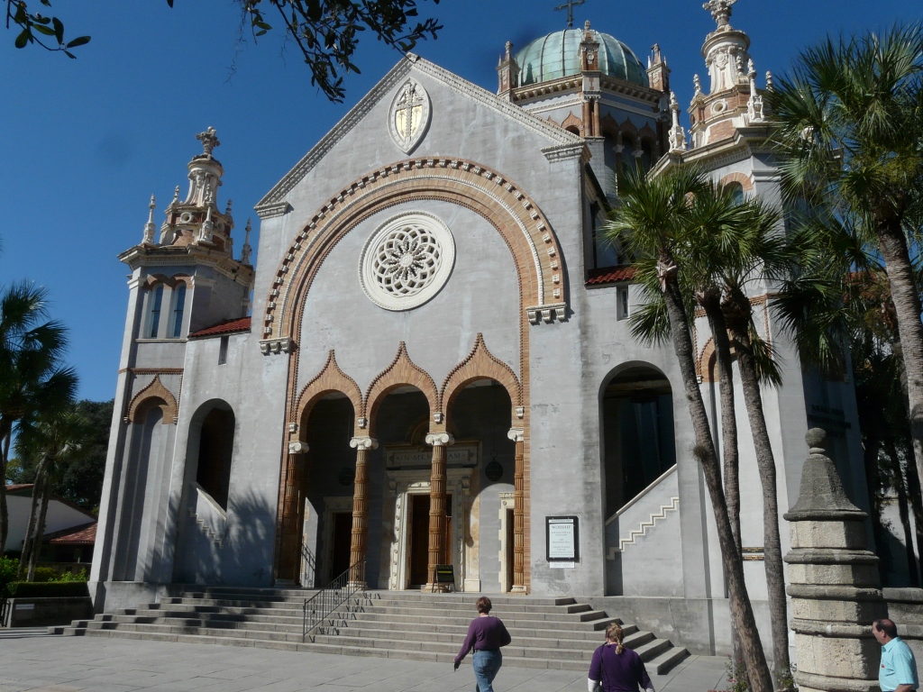

Gotta go to church now. Speaking of churches anyone recognize this one..jpg (507.01 KiB) Viewed 72248 times

I do not recognize the church.

http://www.memorialpcusa.org/
This church was built in the late 1800's in just 365 days. If you are ever in St Augustine Florida be sure to take the tour of this and Flagler College. The wood working will inspire and humble the best craftsmen of our day!

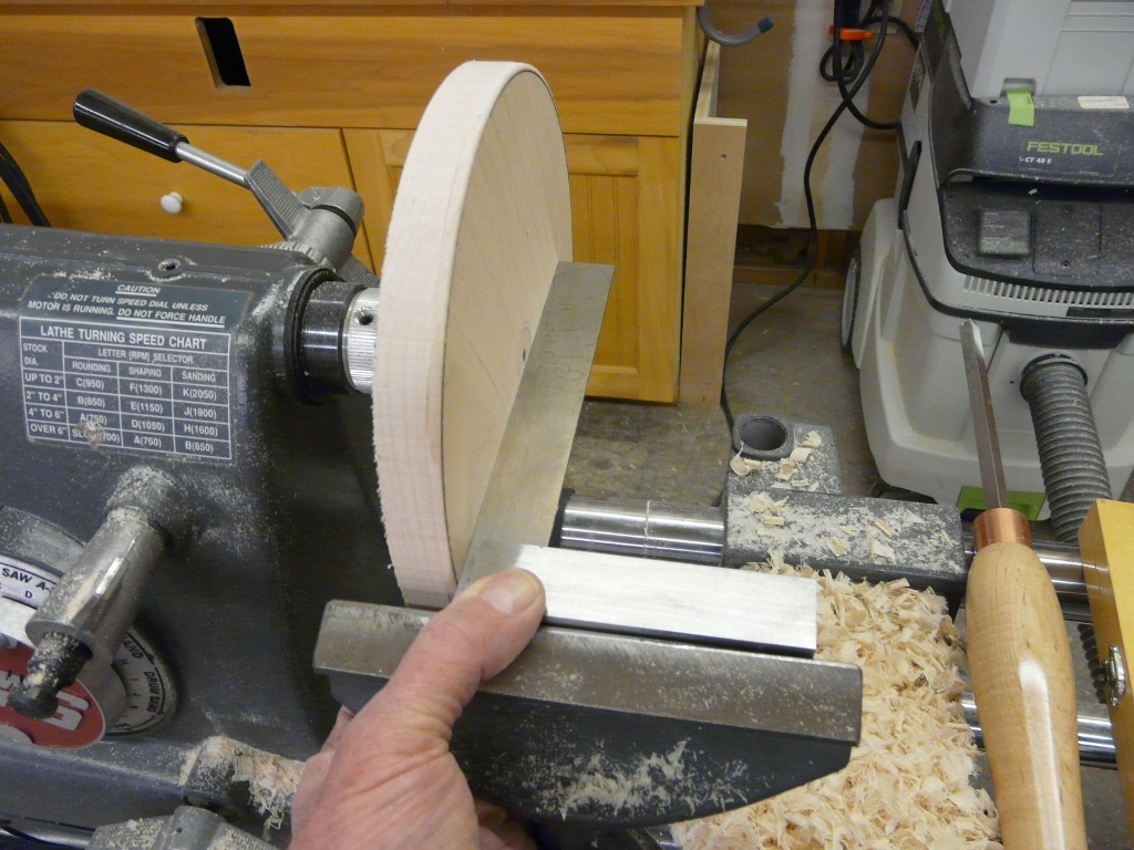

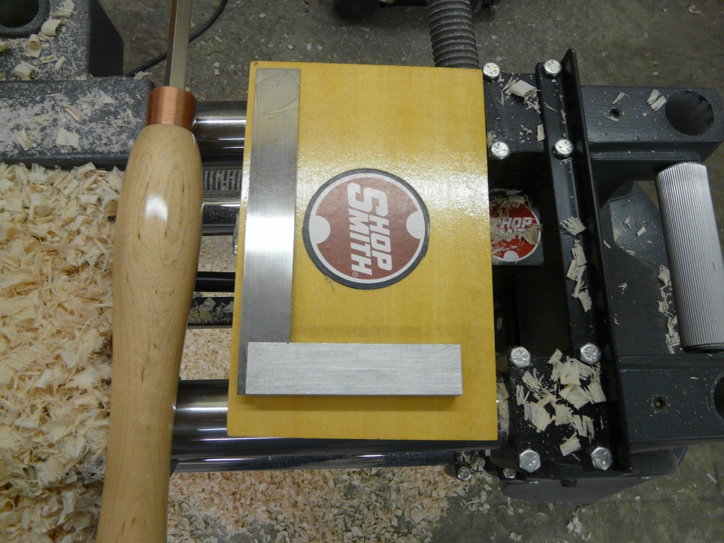

Tip*****
Tip*****
Don’t know if Shopsmith still sells this square but it has been a handy item to own (1).jpg (479.88 KiB) Viewed 72068 times
Tip*****
Tip*****
I like to square my tool rest up to the work piece. It gives me a visual reference and helps me keep the work piece true..jpg (455.92 KiB) Viewed 72068 times

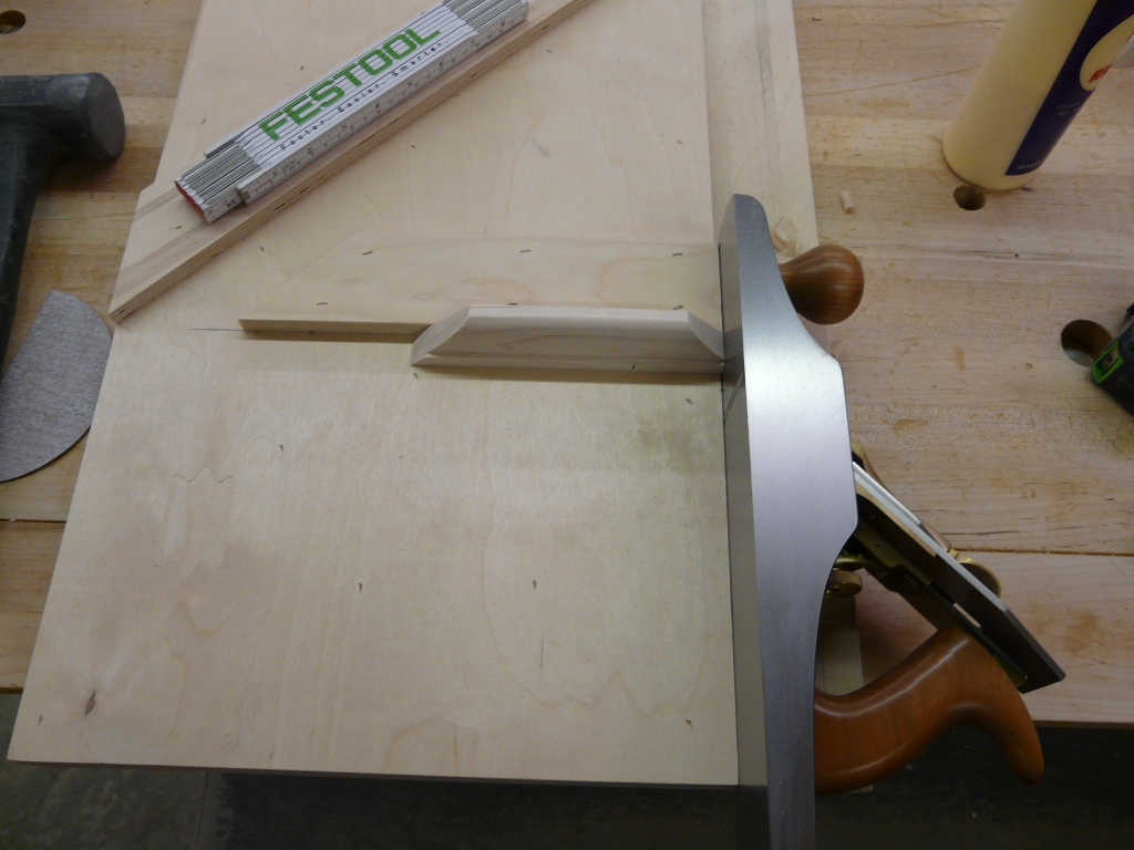

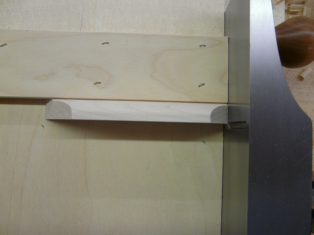

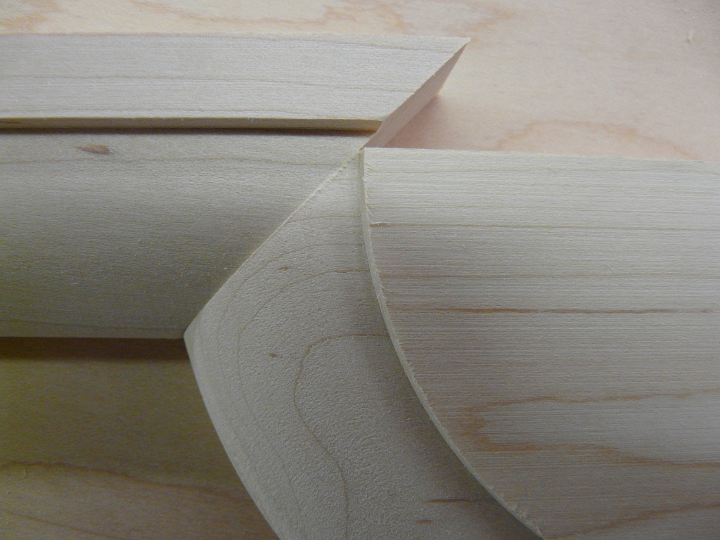

Okay back to the task! ;)

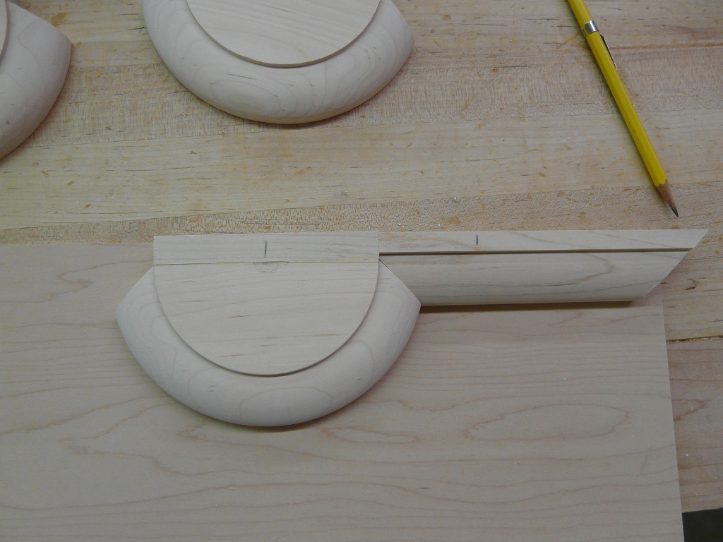

This is where the geometry gets a little whacky.  Both pieces were routed on the same bit and against the bearing. This is the result when trying to join them on a 45 degree angle..jpg
This is where the geometry gets a little whacky. Both pieces were routed on the same bit and against the bearing. This is the result when trying to join them on a 45 degree angle..jpg (418.99 KiB) Viewed 72065 times
Don't worry I will fix it and it will actually work better for what I am making. :)

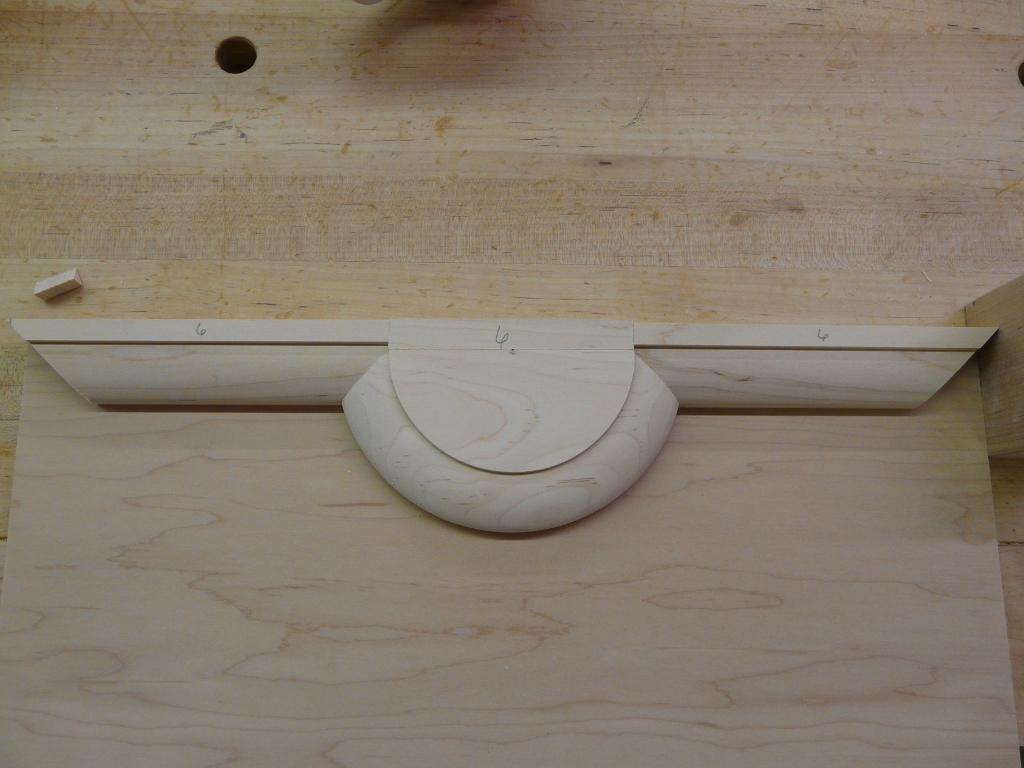

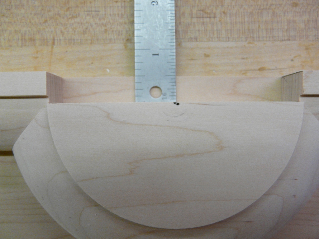

The answer is to square off the miters and add to the half circle. (1024x768).jpg
The answer is to square off the miters and add to the half circle. (1024x768).jpg (347.22 KiB) Viewed 72058 times
I need to add a full ½ inch. (1024x768).jpg (397.59 KiB) Viewed 72058 times
P1090083 (1024x768).jpg (373.65 KiB) Viewed 72058 times

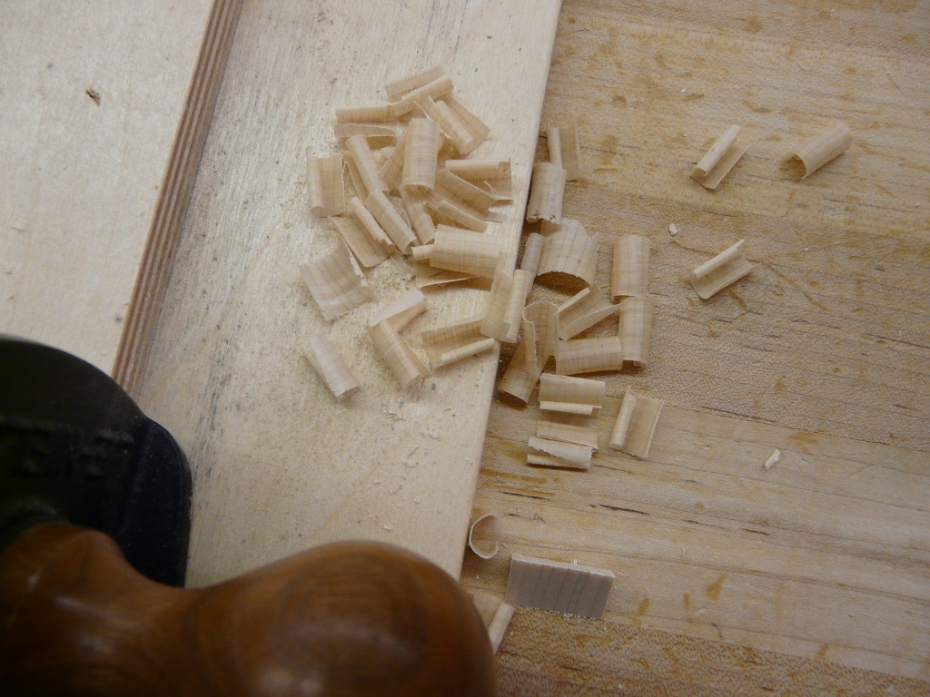

Since not two are going to be exaclty the same I pulled out my shooting board for tweaking. (1024x768).jpg
Since not two are going to be exaclty the same I pulled out my shooting board for tweaking. (1024x768).jpg (344.79 KiB) Viewed 72058 times
P1090094 (1024x768).jpg (366.26 KiB) Viewed 72058 times
P1090096 (1024x768).jpg (445.51 KiB) Viewed 72058 times
I have also marked and numbered each piece so that I do not get them mixed up after all the tweaking. (1024x768).jpg
I have also marked and numbered each piece so that I do not get them mixed up after all the tweaking. (1024x768).jpg (362.26 KiB) Viewed 72058 times

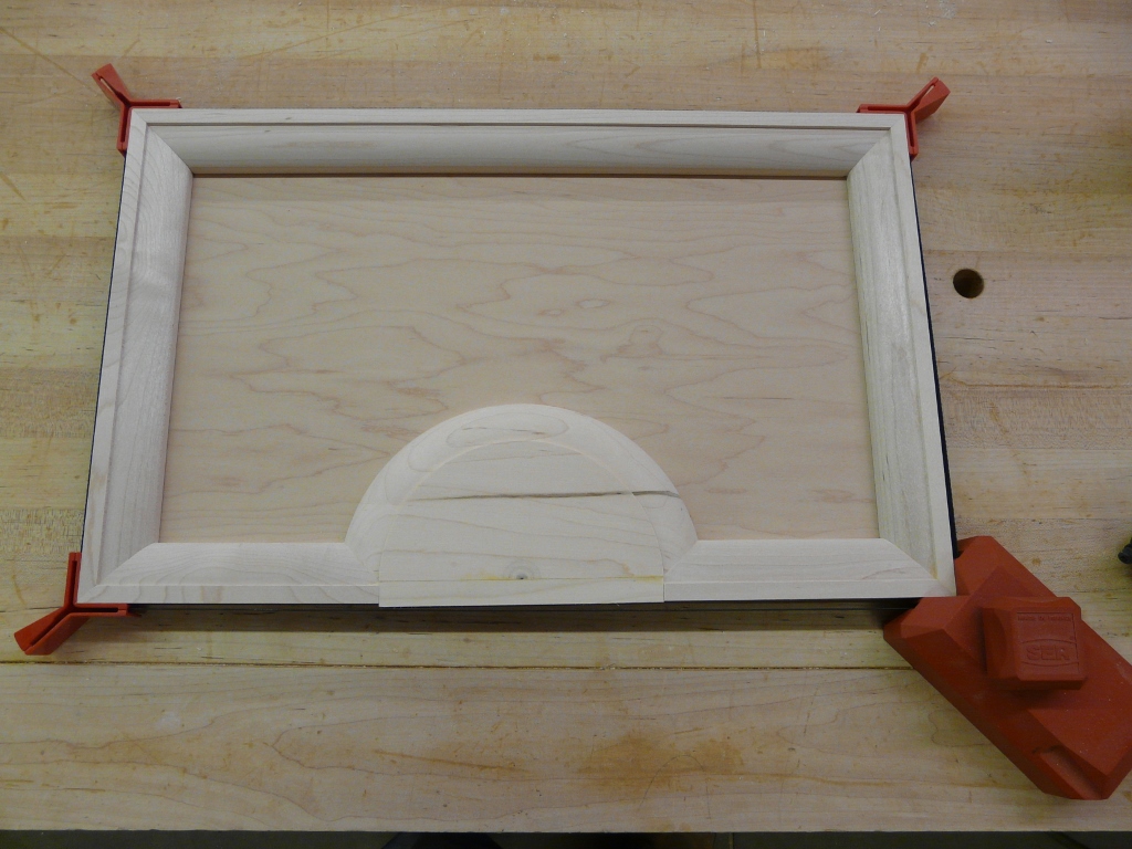

All parts together.
All parts together.

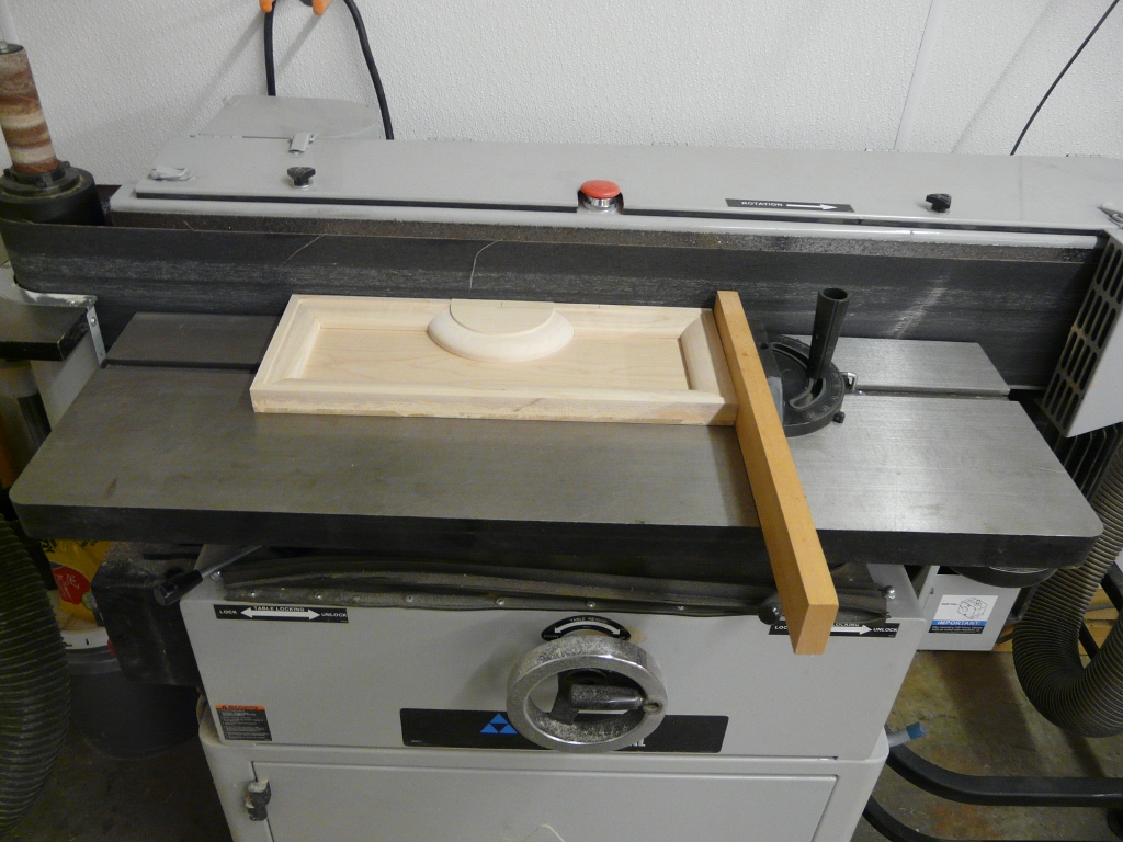

Edge sanding.
Edge sanding.

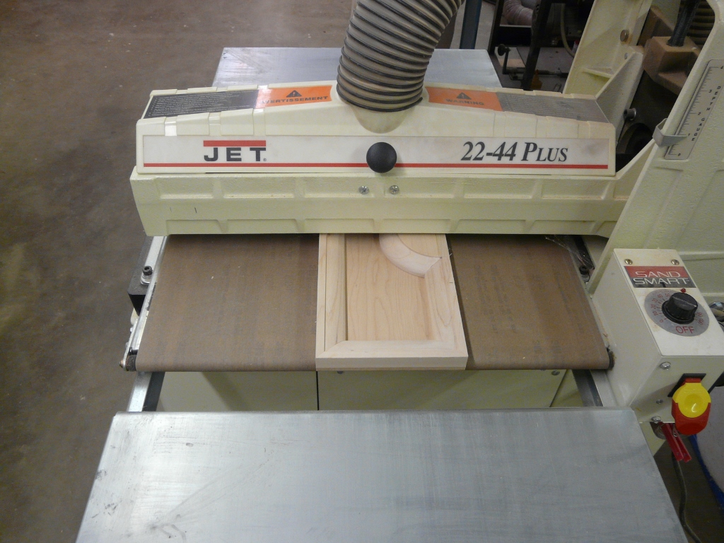

Touching up on the drum sander.
