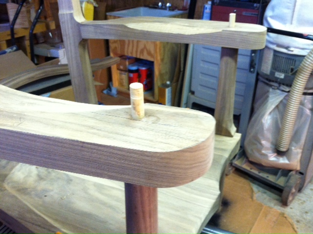

Yesterday I put on the unfinished arms. Used a dowel through the rm into the front leg and a 3" screw through the back leg into the arm - with glue.
Almost forgot to add that the flush fit of the arms to the back legs were made with the disk grinder and the table at an angle.

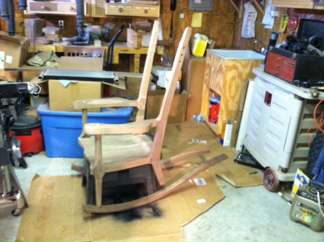

Then I wanted to see if the rockers fit beneath the legs. The seat is resting on a step stool and the rockers placed beneath the legs.
rocker sitting below the legs.JPG (141.65 KiB) Viewed 3135 times

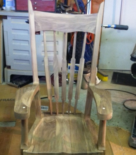

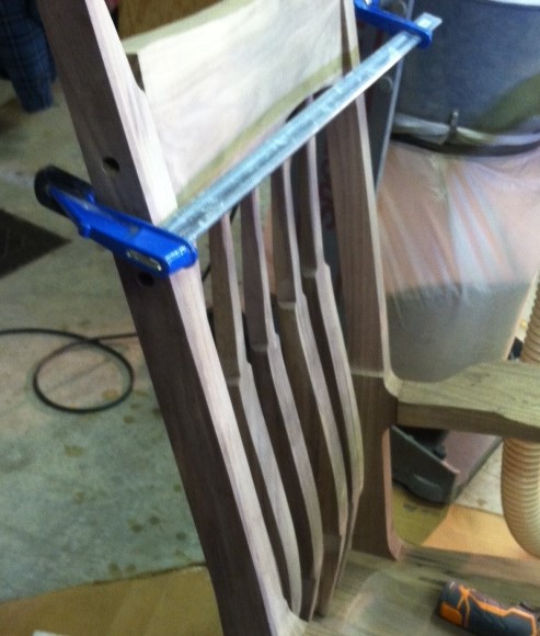

Finally - after a week of Dr. Appts. Got a chance to do some more work on installing the spindles and crest. Drilled 9/16" holes in the crest all at 5 degrees toward the front. After a couple trial fits with the spindles stuck into the crest, drilled 1/2" holes in the chair at approx. 4 degrees toward the back - This had to be done with my hand drill and it will only take a half inch bit.
What I've got, so far, is spindles stuck in the holes while the crest is not situated in the right place. It is at an angle and tilted to the rear too much. Tomorrow (next day) it is adjustments of the spindles. I've finally found that shaping of the spindle ends is a lot more effective than trying to get the holes drilled at a certain angle. The angle of the holes in the seat were set by eye with the help of an sliding angle gauge.
You can see the crest is canted high on the right side of the chair and tilted past the slope of the legs. This means more work with rasps on spindle ends.
