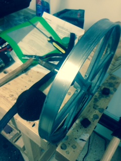

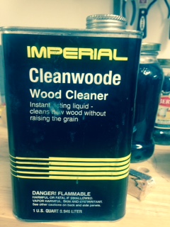

I was starting to replace my bandsaw tires this evening. They were the glued on rubber tires and were more than FIRMLY attached! I was able to do the lower wheel in about 20 minutes, probably less. My secret was to use my trusty Black & Decker heat gun designed for paint removal! That and my secret cleaner (available at REAL paint stores.dusty wrote:I can not relate to the tire coming off. The tires are so firmly attached to my two old bandsaws that I am concerned about how much work it is going to take to get them off when I do need to replace them. But those are my problems.
