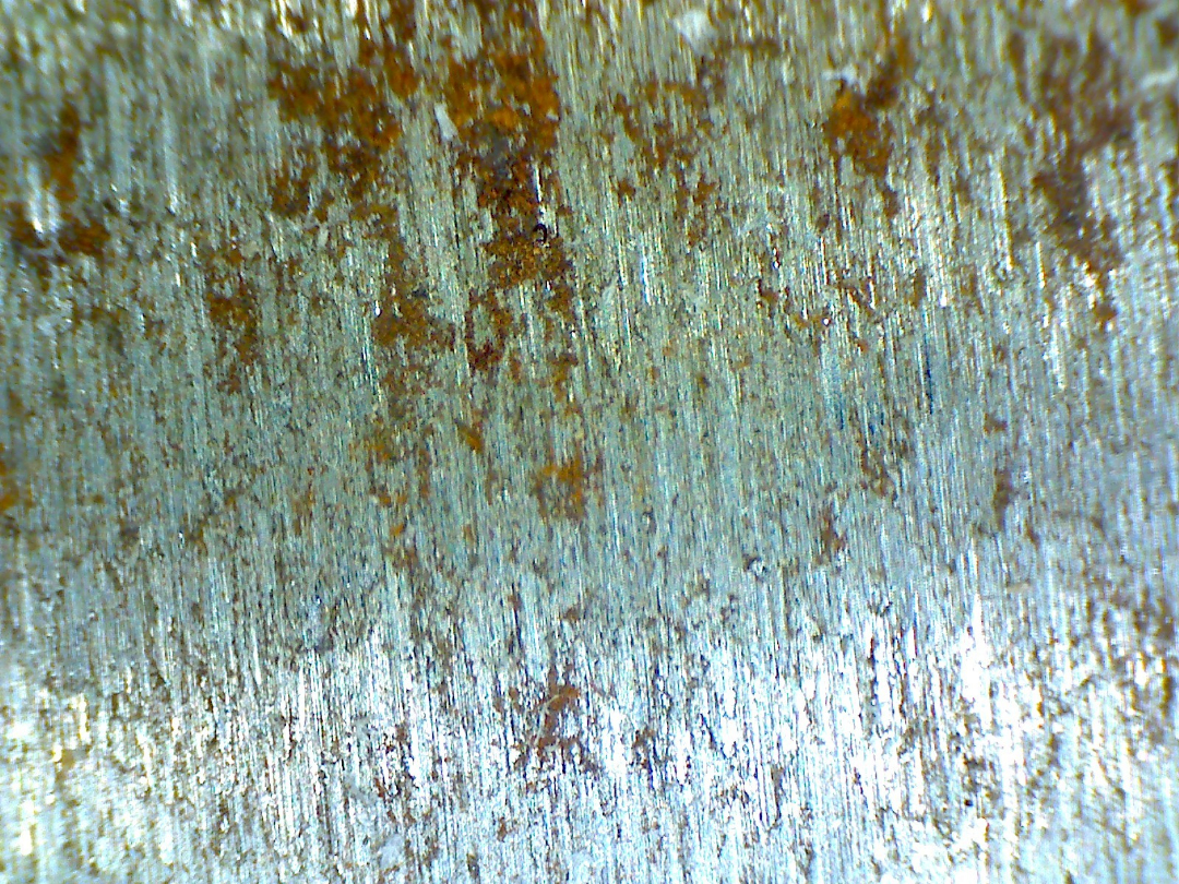

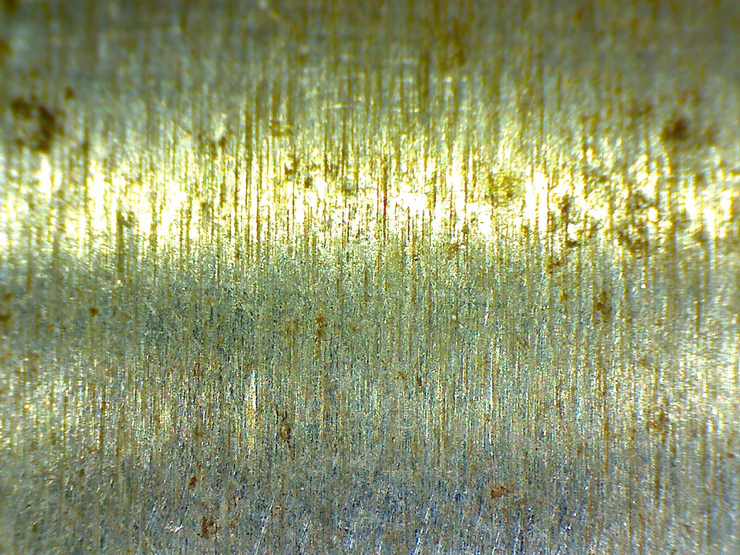

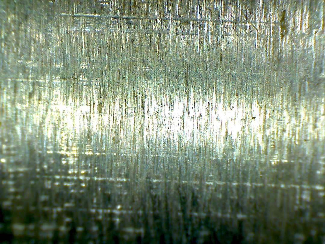

Tube surface closeups
I took another look at the tube surface finishes on my machines -- I'd never looked at them really closely before. Both machines are still in unrestored condition. The 10E appears to have a fair amount of use, but almost no rust. The 10ER shows virtually no wear, but has light rust on the top surfaces of the steel parts, including the tubes.
I figured that if the tubes were centerless ground, there should be fine grinding scratches running radially around the tubes. And what I found was ... drum roll, please ... I couldn't tell with my naked eye. :D
So I hunted down my handy-dandy cheapo USB microscope, toted the laptop down to the workshop, and took these images. They clearly show radial scratches on the OD.
This first pic is of the 1947 10E.
10E tube closeup.JPG (1.52 MiB) Viewed 4895 times
This next one is of 1952 10ER, at the very end where the tail bracket mounts. You can see the longitudinal scratches from the bracket, superimposed on the grinding marks. This spot was underneath the tail bracket, apparently protected by the bracket from whatever rusted the top surfaces.
10ER tube closeup 1.JPG (1.38 MiB) Viewed 4895 times
And finally, here's a shot of the underside of the 10ER front tube, taken near the headstock end. There's a dusting of rust, but no wear that I can see.
10ER tube closeup 2.JPG (1.51 MiB) Viewed 4895 times
So, I think it's safe to say that 10E/R tubes are centerless ground. For equivalent quality, the cost of grinding would have to be added to the price of the plain DOM tubes available online. Which only serves to make a vintage 10ER look like an even bigger bargain.
Re: 10ER Way Tubes - Use them on PowerPro or dedicated drill press?
Orrrrr some PO turned them to 'polish'/derust.
