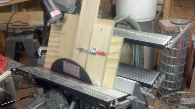

Sorry the fixture did not load to the original post
saddle fixture.jpg (93.86 KiB) Viewed 6976 times
I think I will get the hang of this format in about a tear :D I am not one who embraces change :rolleyes:
Bill V

dusty wrote:Ben, I do not believe I would cut the angles at all. I would use the disk sander on the Mark v and sand the angles with the aid of the v120.
Hard on sanding disks but easy on me. You might want to rough cut the angles to save wear and tear but I would not.
Even doing it this way, set up is critical. The Main Table needs to be absolutely square with the face of the sanding disk. I believe you can rely on the v120 to give you the proper angle.
Lock the v120 in the miter track, clamp the work piece to the face of the v120 and use the quill to advance the sanding disk into the work piece.

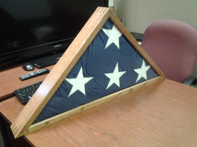

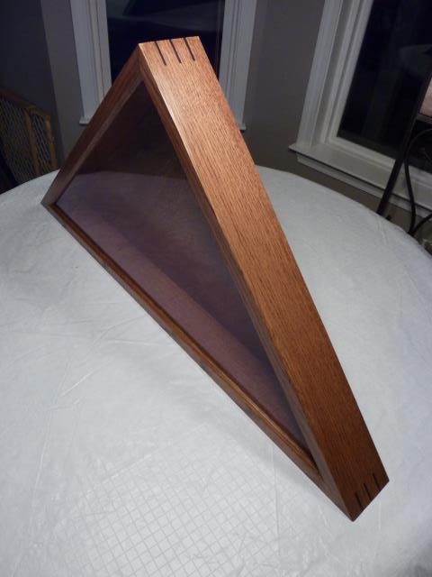

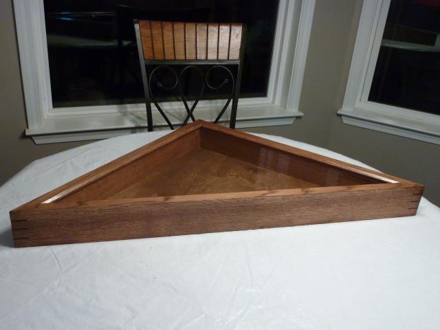

Mission Accomplished!!!
Thanks guys for all the tips. I couldn't have done it without you. Well, ok, I could and would have but with much more frustration. :rolleyes:
Does the jig look familiar Bill? I also made a sled for cutting the splines.
Used white oak with special walnut stain, walnut for the splines. The museum glass was $85.
Customer is very satisfied. They were going to refold the flag and try to minimize the wrinkles. Presentation is tomorrow and she'll be in the museum next week.
Thanks again. This forum is a great resource!
