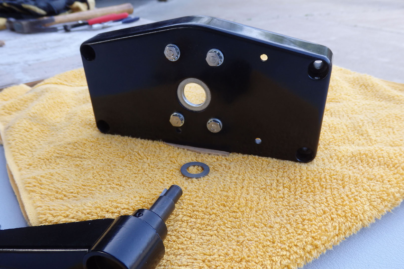

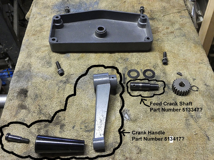

Another favor of the community please ... does anyone have a Parts List and Exploded Parts Diagram for a manual feed planer? In the process of adding the feed pinion to my cart to buy, other "suggested" parts appeared which look to be some of which I need, but I'm not 100% sure, as Shopsmith only shows me a Part Number and a price, but no picture. I have sent my question to Shopsmith CS for verification, but while waiting for a response perhaps someone else could help. Attached is one of the photos which JPG took and posted, to which I have added clouds and PRESUMED part numbers. If I really can get these thru Shopsmith, that much less to have to invent or improvise!
- EXPLODED with clouds.jpg (187.77 KiB) Viewed 18511 times

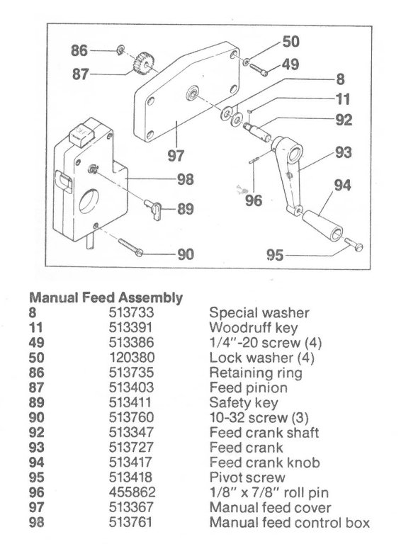

Here is a scan from an old manual. Verification of items with customer service is recommended, since changes can be made to parts over time.
Shopsmith I.T.
Re: Can a 12" Planer w/o feed motor be converted to manual feed?
Admin has provided the original part #.(kudos for that!).
I really think a 3/8" straight shaft will be easier than the stepped shaft. The shaft can be stepped up with bushings where required. Since you will be making the cover bushing, it can be 3/8" to fit the shaft. The pinion gear will fit the 3/8" shaft. A different way to key it to the gear would be needed.

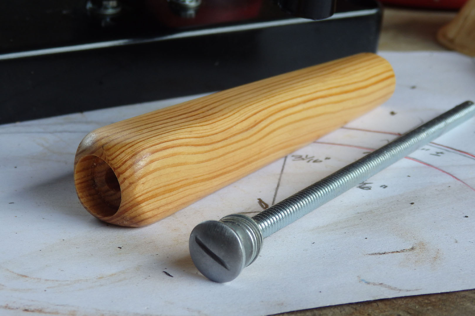

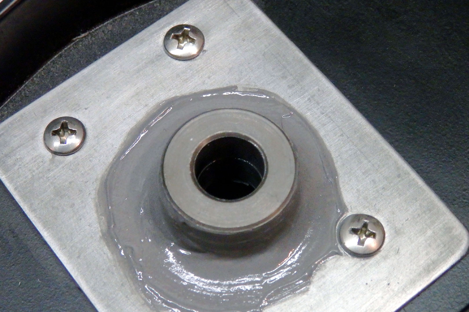

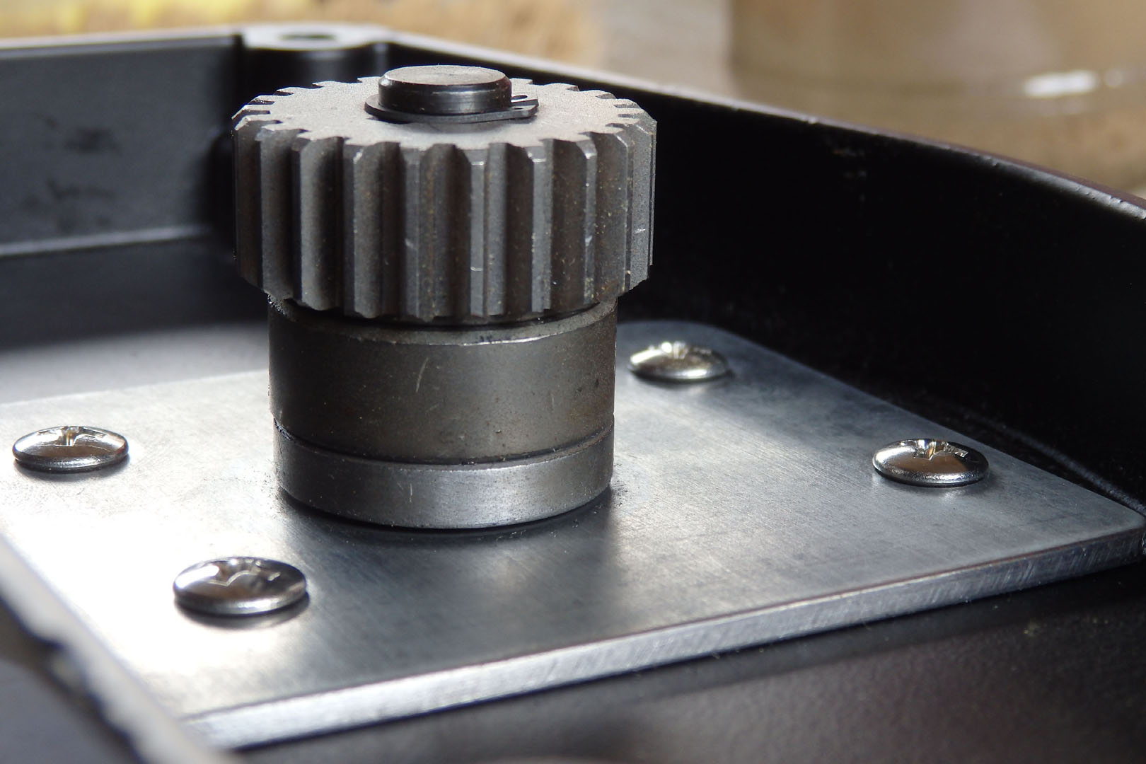

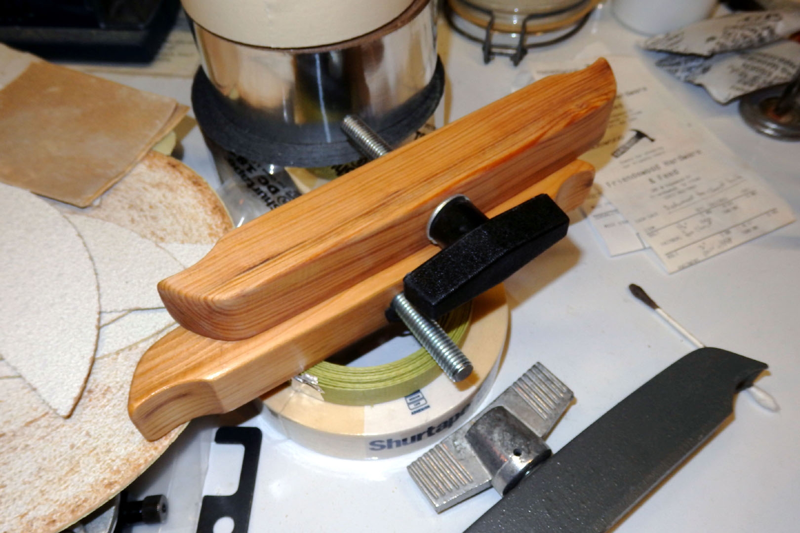

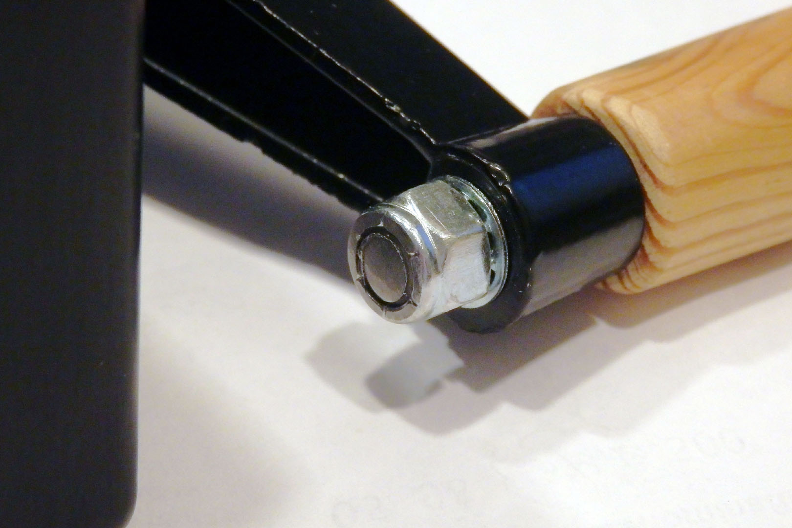

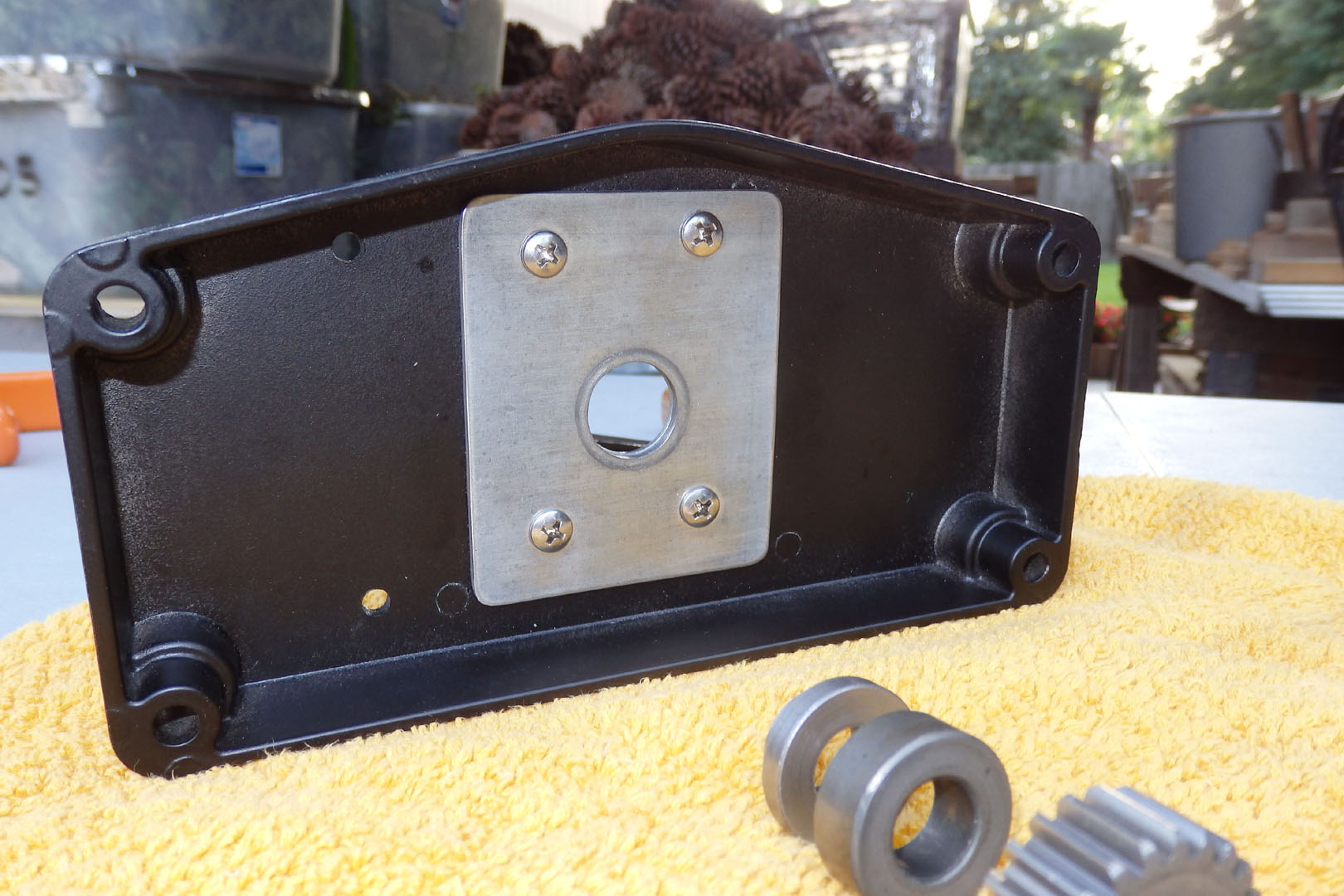

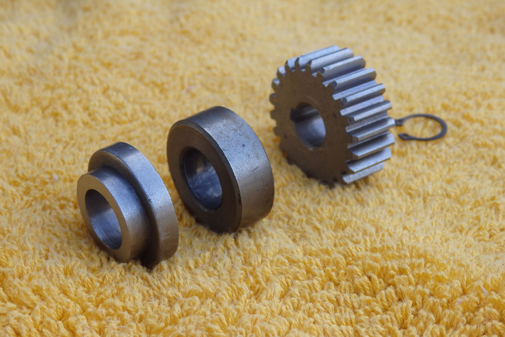

Time for an update. I ordered what parts I could, along with a few other missing necessities like Owner's Manual, knife setting gauge, power coupler, etc. Thanks to Admin for posting the parts diagram. Not having to make the shaft or pinion gear was a real time saver, and the cost was surprising low for these parts. For the cover and bushing, I bolted a 1/8" thick piece of steel to the inside of the cover and drilled a hole matching the OD of bushings, which I had salvaged from my old garage door opener. One bushing had to be shortened slightly, but it had the necessary "shoulder" to butt up against the steel plate. Made another 1/8" thick steel filler with OD to fit inside of the hole in the cover and with an ID matching OD of bushing. Initially thought and tried assembling all the parts "dry", but fit was too loose and too much wobble in crank handle. Used JB Weld to attach bushings to each other and to steel plate. Used 1/2" bolt with Scotch tape around un-threaded portion of bolt to align all of the parts until the JB Weld had set up enough to allow bolt removal. Made crank handle and clamp brackets out of some very dense SYP. (Clamp bracket from Speed Reducer used as template.) Carriage bolt with slot cut in head for screwdriver, filed off square portion under head used to attach wood handle, and a few washers to control amount head was recessed. Lock nut keeps carriage bolt from trying to unthread as crank is turned. Have checked knife alignment and adjusted table height mechanism, so almost ready to try planing!
- Cover with steel plate bolted on
- P4041271a.jpg (281.46 KiB) Viewed 18437 times

- Bushings and Pinion Gear
- P4041278a.jpg (276.54 KiB) Viewed 18437 times

- JB Weld to the rescue
- P4051281a.jpg (258.56 KiB) Viewed 18437 times

- Wood crank handle and carriage bolt
- P4021262a.jpg (186.03 KiB) Viewed 18437 times
- Lock nut to keep bolt from un-threading when crank turned
- P4061296a.jpg (182.42 KiB) Viewed 18437 times
- Wooden clamp brackets
- P4051286a.jpg (219.35 KiB) Viewed 18437 times
