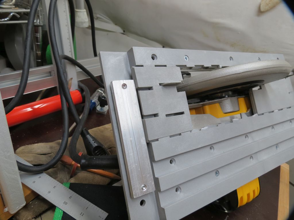

When you try to remove the insert the "studded EZ connector" is in the way as seen in this picture.

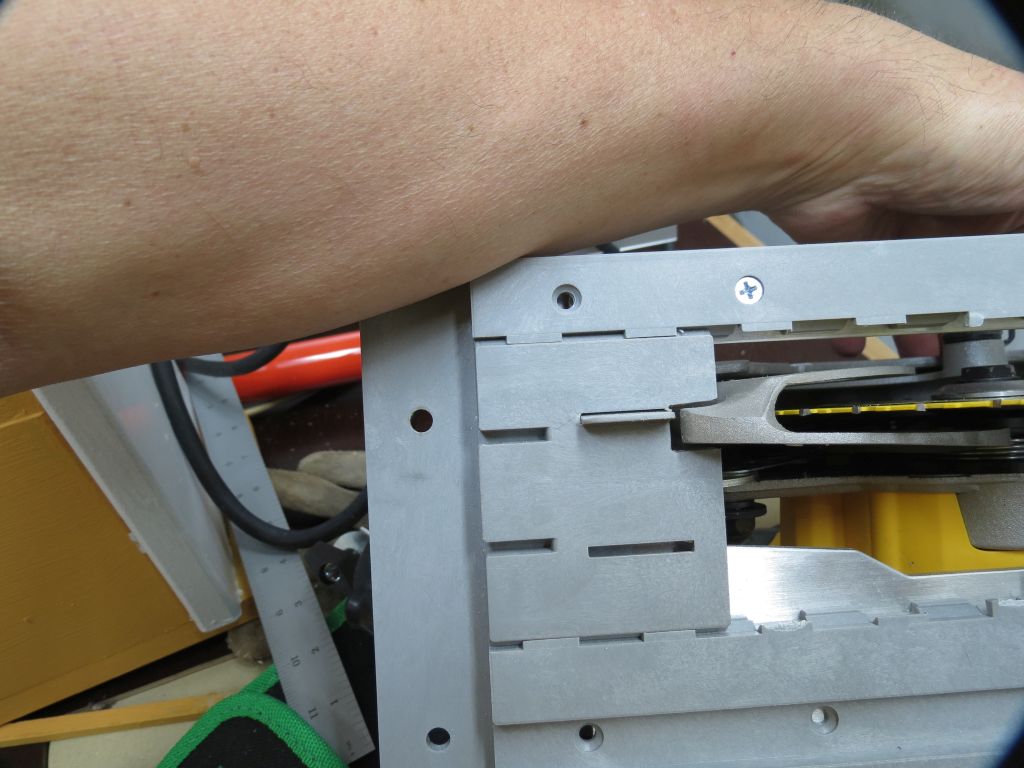

Once that part is removed it slides out as seen here:
It took several trials to get the fit right but it wasn't too bad. Keep in mind this would be a task that you would need to do when ever you need to replace this part.

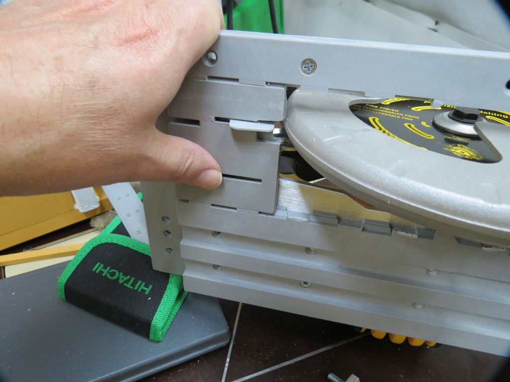

In this photo you can see the protrusion of the guard as it clears the back insert.

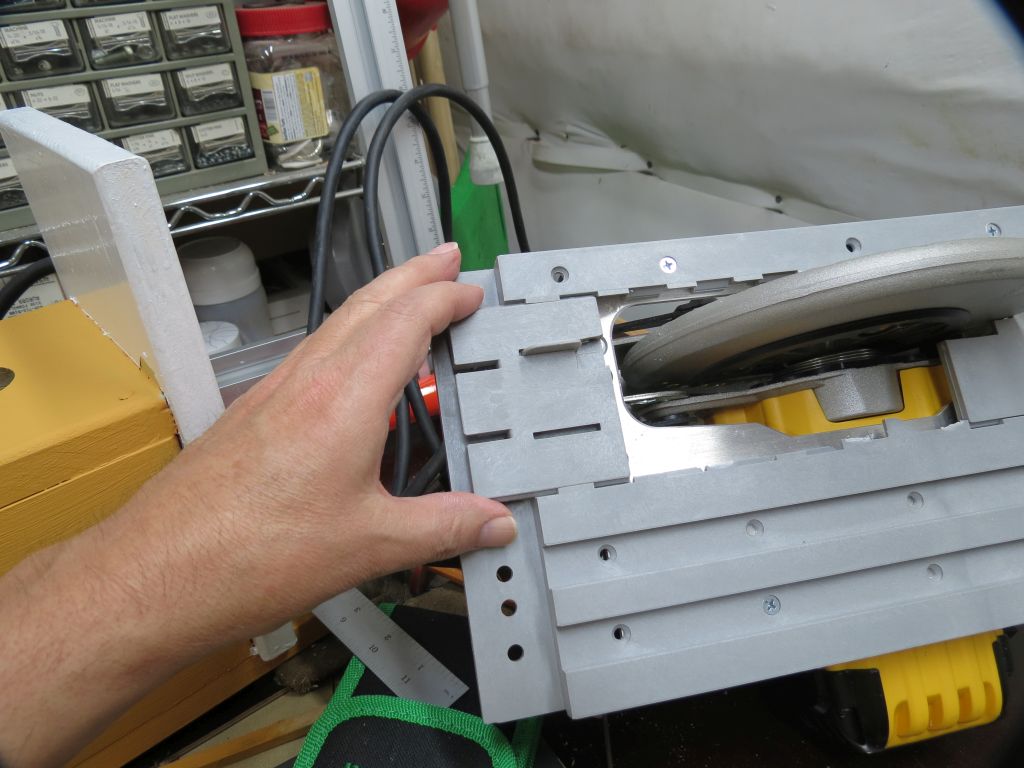

I had to go so far back that part of the fin also needed to be removed. In this picture you can see the flip side of the insert with fin in place.

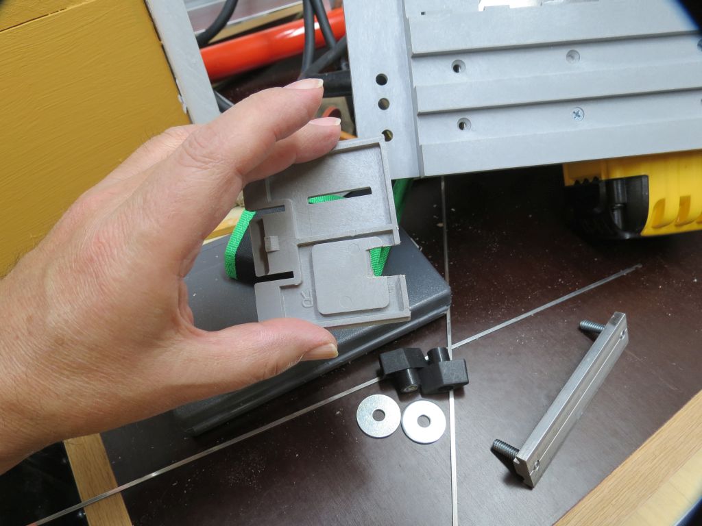

This next picture shows the two parts separated.

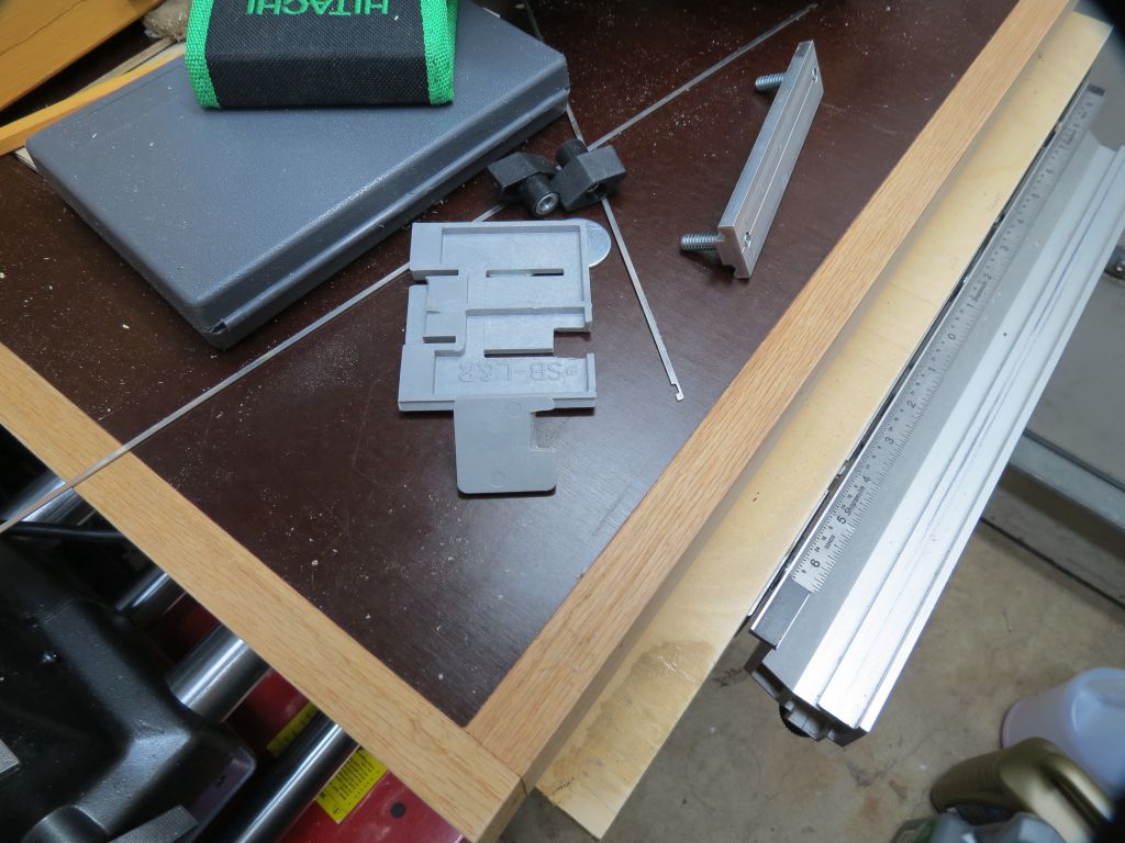

While the normal direction of movement should help keep the part in place I fear that something could go wrong and the fin would slip forward as shown in the next picture. The result would be to trap the blade guard in the up position.
