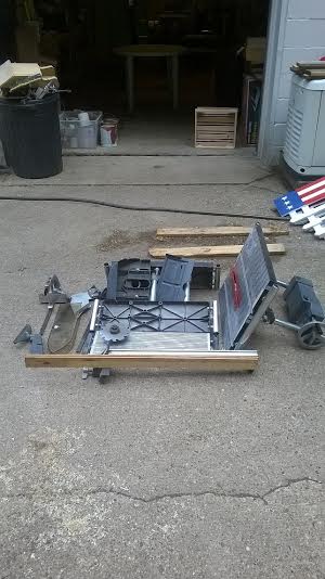

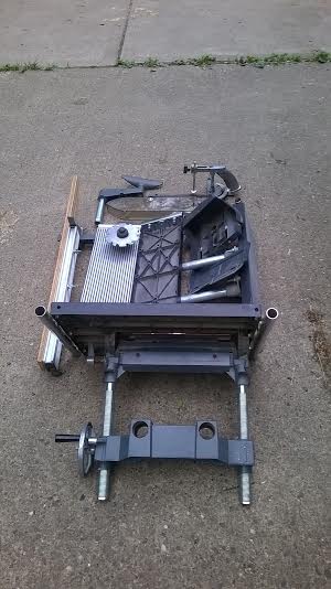

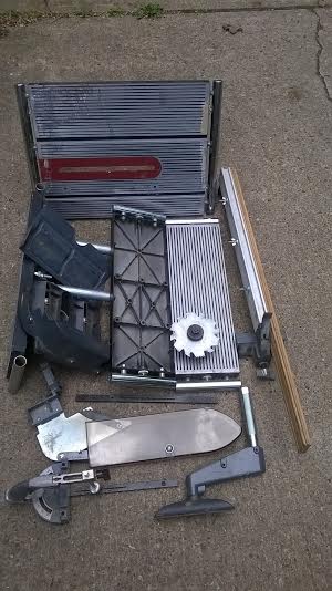

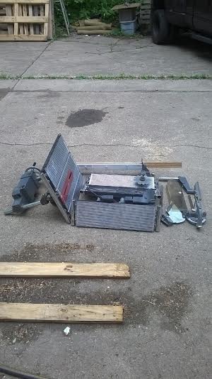

Alright, here is what I bought!
Looks legit, what are your thoughts?

Under the rails there is a knurled wheel for tightening (I assume). So does this mean current design?

Not to 'confuse', but you have an early version of the 'current' design. You do NOT have the 'early' design.ExtraMile wrote:Under the rails there is a knurled wheel for tightening (I assume). So does this mean current design?
The center portion of the latest 'current' design does not have ribs.
It appears 'legit'.
Interesting addition to the fence. I use t-nuts when
I do that(no through(protruding) screws).
P.S. The thumb screws(also on early design, but smaller) are to secure those tubes you will not purchase on e-bay to the inside of the rails. You really need those connecting tubes to be able to use the floating tables.

From the pictures it would appear that you got a few 500 parts in that collection. The most obvious is the top saw guard, and while I can't be sure the bottom also looks like one for a 500.
The bad news is that those are not cheap parts to purchase from shopmsith.
You will need the tubes and I'm not sure if the person selling the "better" and cheaper tubes on ebay is still doing that or not. They were selling 5 foot tubes at the time but you could cut them to shorter lengths.... or leave them long and see how that works for you.
