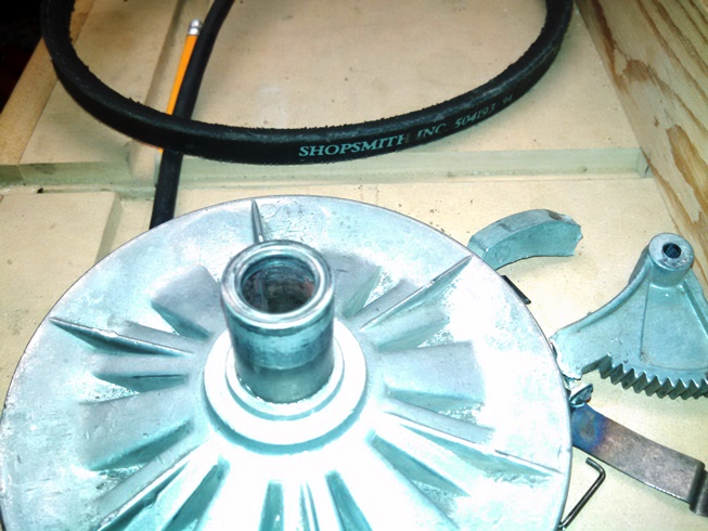

Ok so here is the control sheave
ss control sheave.jpg (131.51 KiB) Viewed 2551 times

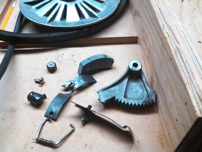

and here is the pieces and parts that I found in the bottom. Also a few ball bearings.
ss wats left.jpg (128.65 KiB) Viewed 2551 times
The quadrant "arm" section with the teeth was still attached to the speed control bracket. As said before I don't think it is bent in any way.
and this is the part on Ebay I was hoping I could buy as opposed to buying the entire control sheave assembly.
http://www.ebay.com/itm/REPAIR-YOUR-SHO ... 4aa780ba64
Its about half the money. But no cheap repair is a good repair if it isn't and adequate repair. an extra $25.00 is nothing if it is the right or best way to do it. I just don't want to spend money I don't need to spend. So i really do appreciate the input and help thus far.

The control sheave looks salvageable(cannot tell for sure from the pix if the new bearing will seat properly).
It appears the wire loop fell off a long time ago.
The button (square in your greenie case) was rotating on the porkchop and just chewed it up eventually. Notice the color of the 'button'. Blue/black ain't 'normal'.
That seller is reliable.
I would get the button etc. from him. And the porkchop from SS. And the screw etc. from Bill Mayo.
If staking is not possible, there is blue(or red) loctite!

'Peening', 'Dinging' ... After inserting the bearing in the 'bore', 'crimp' the end over the bearing to retain it.

Peening is done with a round object(ball peen hammer).
Staking is done with narrow blunt object(dull chisel(sorta)). At least in this context.
Crimping is usually done with a crimping tool and usually to thin material like sheet metal.

With all the damage ya have, I'd get all new parts.
