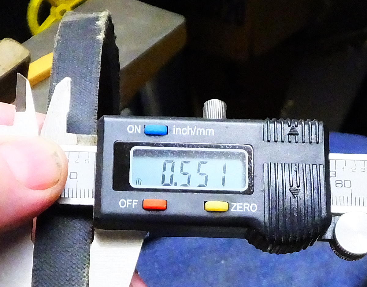

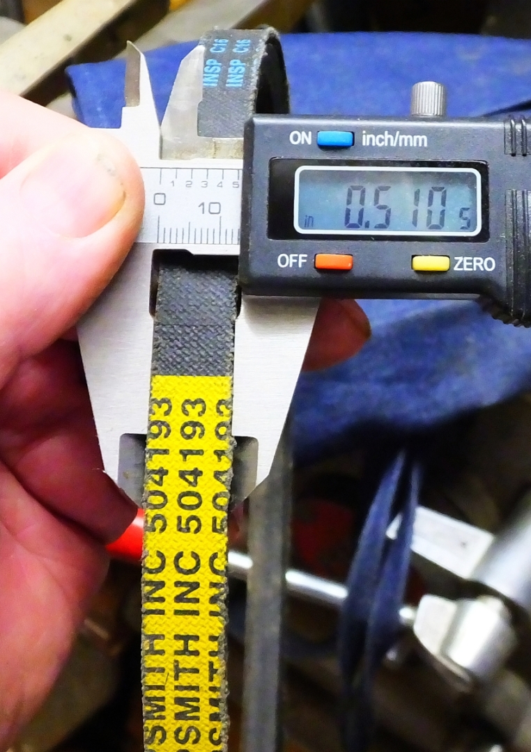

A 'method' of measuring.
The belt is a used belt I purchased on e-bay. I know nothing of it's previous history.
The width varies around the belt(likely due to wear.)
width at the narrowest
504193 NARROW.jpg (560.82 KiB) Viewed 1887 times
And at the widest
And at the widest
504193 WIDE.jpg (855.4 KiB) Viewed 1887 times

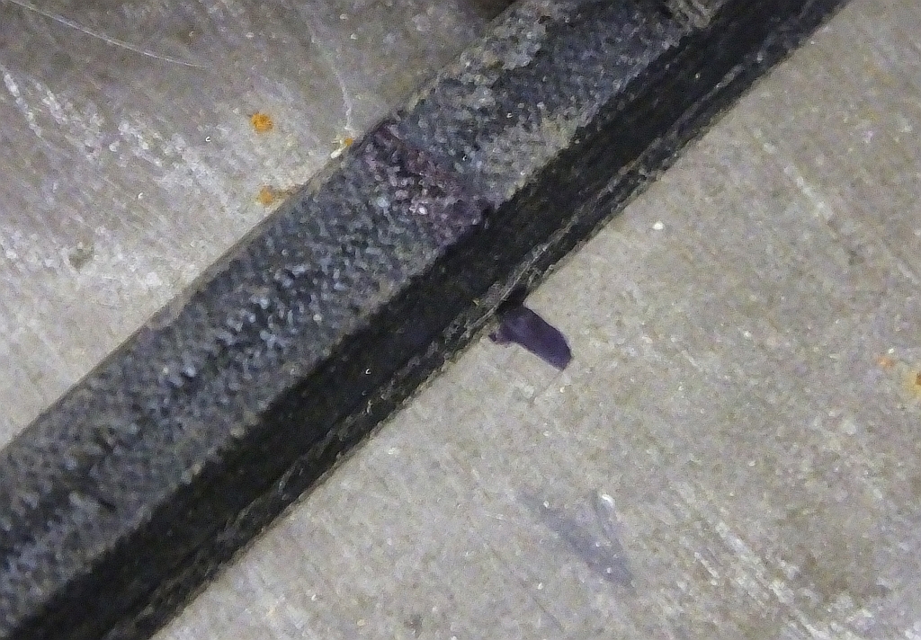

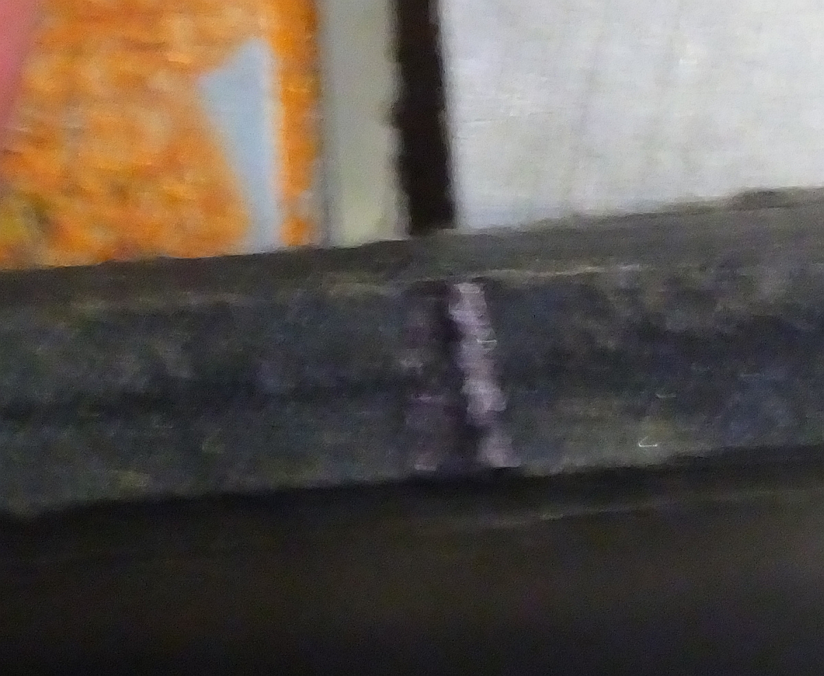

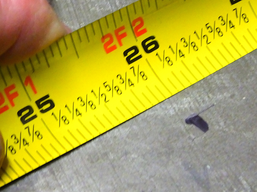

As for the length, using the jointer base as a level surface:
Starting at the 'front' edge
504193 START.jpg (727.46 KiB) Viewed 1887 times
Starting mark after one full revolution held tight against the jointer bed
504193 STOP.jpg (574.88 KiB) Viewed 1887 times
504193 LENGTH.jpg (633.19 KiB) Viewed 1887 times
Focus not too good as the lighting was 'poor'(too many shadows etc.).
At least this is how I 'measure' em.

by beeg
Well my unused one measured 17/32". I'll add the length later.
