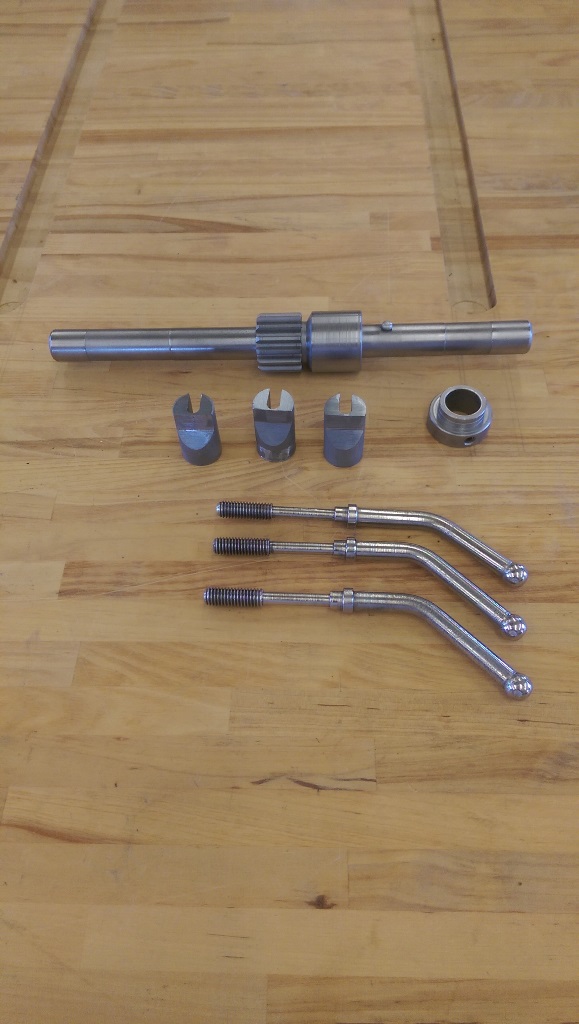

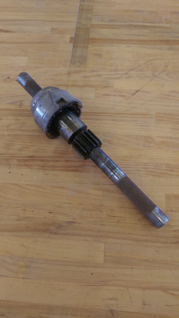

More progress made today. The quill pinion shaft is done along with the motor and head stock pulleys.
The wedge locks had been cranked down so tight that the handles could not be removed. One was so crimped that the handle would not turn inside the wedge. I used Skip's procedure on the first two and it worked. The third one was a different story. I used a large cold chisel to open the slot. Then a 3/16" pin punch (ala Skip). Still not open enough to use the 1/4" punch. I used two large screw drivers side by side to pry the slot open enough to use Skips technique with the 1/4" pin punch. then I filed the sides of the slot to be able to remove the handles.

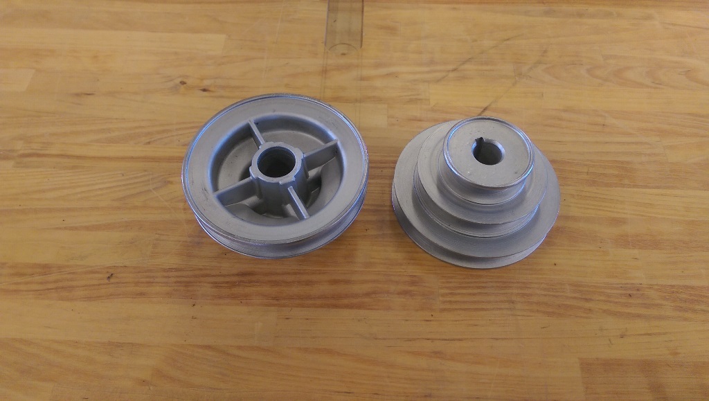

The speed changer sheaves were glass blasted and then polished with 600 grit wet/dry and #0000 steel wool.

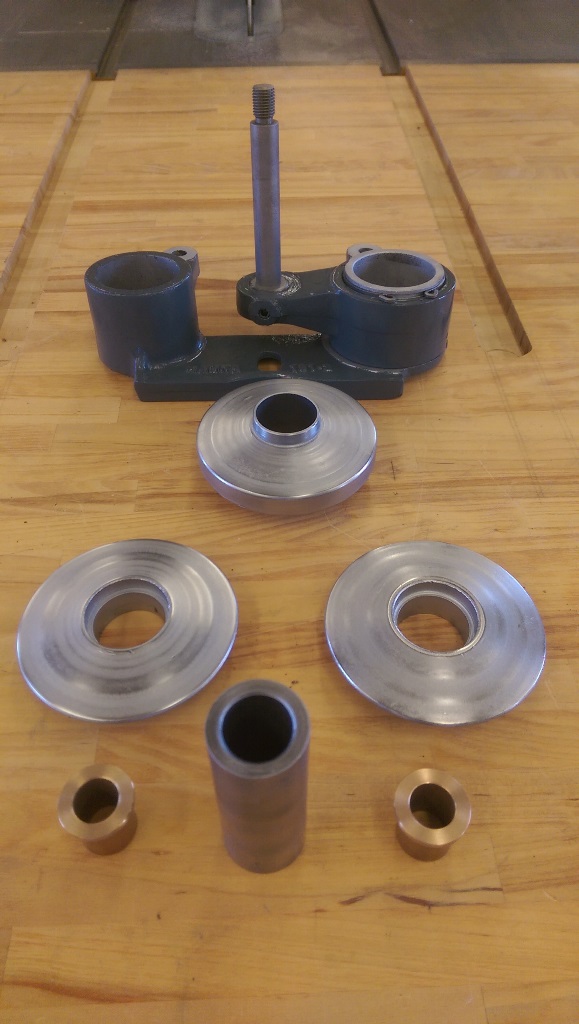

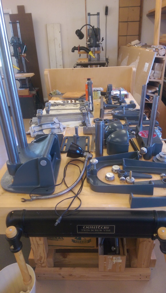

Here are a couple of pictures of all the restored parts so far. As can be seen there are extra parts. They are from my dedicated 10ER drill press that are not being used. I am going to restore the drill press but it works fine as it is.

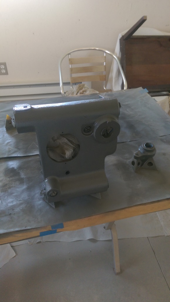

I got the head stock finished today. The only things left to blast and paint are the bench legs and the main table trunnion.
