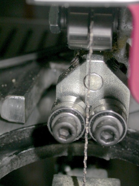

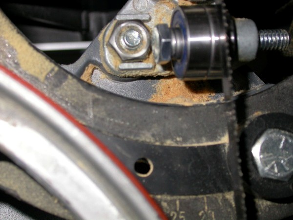

Everything arrive today and is perfect, if anyone is interest I have lots of spare parts including one complete set of everything if someone wants to pay cost plus shipping just send me a private message. I purchased most stuff in bulk (100) because is was actually cheaper then purchasing the 2 or 3 I needed. When I went to install them the auto-track assembly I have looks exactly the same as what I just assembled but I was told it is not exactly the same. I guess at some point Shopsmith made some change on newer saws.
The upper and lower backup bearing are an improvement, but I do have issues where they don't exactly align.

With a lot of encouragement from LDH, I got everything aligned. It turns out I don't think my Bandsaw was ever aligned correctly. I have been relying on the Carter Bearing to keep everything aligned. My old bearings have grooves ground into them, I guess they needed replacing anyway.
The saw is very quite now as a side unexpected benefit.

paulmcohen wrote:Everything arrive today and is perfect, if anyone is interest I have lots of spare parts including one complete set of everything if someone wants to pay cost plus shipping just send me a private message. I purchased most stuff in bulk (100) because is was actually cheaper then purchasing the 2 or 3 I needed. When I went to install them the auto-track assembly I have looks exactly the same as what I just assembled but I was told it is not exactly the same. I guess at some point Shopsmith made some change on newer saws.
[ATTACH]1411[/ATTACH]
[ATTACH]1412[/ATTACH]
Are those the Carter's under the new bearings? I only have cool blocks right now. Havn't done the upgrade yet due to my foot, but hopefully will soon. What kind of Carter replaces the cool blocks?
