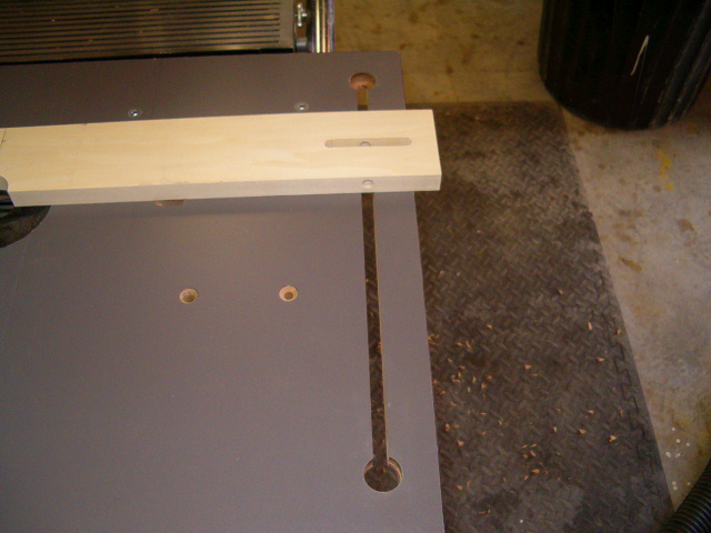

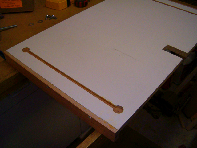

Here are pics of my sliding table and one showing my sliding table fence. In the latter pic, note the hole that goes through the 3/4" edge. With that I can make a taller vertical fence. Of course you need longer bolts for this use.
top of sliding table.jpg (171.57 KiB) Viewed 2751 times
slot in OPR table.jpg (132.5 KiB) Viewed 2751 times

Interesting... Did you use laminate for the table body?
I like the concept. Wonder why SS does not list this in their write-up on the site?
Re: New Overarm Pin Router
Posted: Sun Dec 06, 2015 10:55 pm
by charlese
delong94 wrote:Interesting... Did you use laminate for the table body?
Laminate? Yes.
Why not in the write-up? Because A) It would take a couple pages B)It requires personal manufacturing-- Something SS can not be responsible for.
SS offers plans for some toys, but does not include these things in the write-up on the machine.
