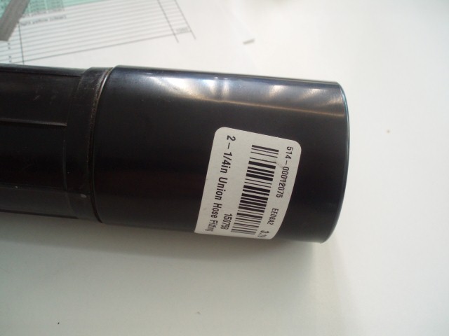

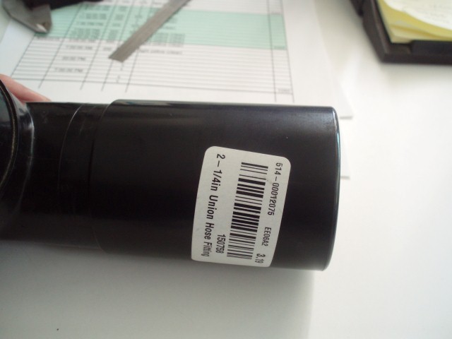

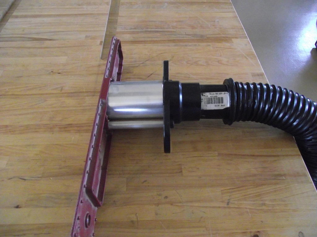

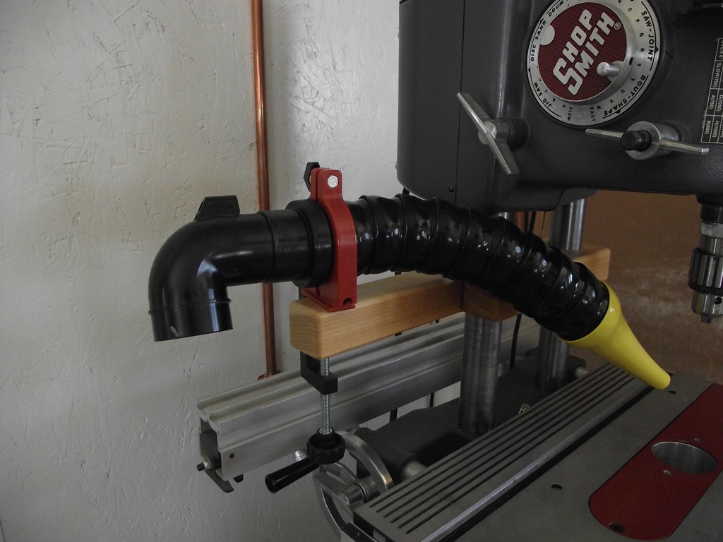

The pictures show two more examples of interchangeability. The first one is a Woodcraft hose end plugged into the SS sanding drum insert. The second one is a SS elbow plugged into a Peachtree flexible hose assembly.
As for the SS disclaimer.
http://www.shopsmith.com/ownersite/cata ... ttings.htm
I see no disclaimer on that page.
http://www.shopsmith.com/ownersite/catalog/dc_hoses.htm
It has nothing to do with the end that plugs into a tool or another fitting or the fittings themselves. It has to do with the threaded end that screws into the hose. SS does not sell the threaded end separately so I don't know why it would ever be an issue.
- DSCF1565.JPG (309 KiB) Viewed 2655 times
- DSCF1566.JPG (340.56 KiB) Viewed 2655 times

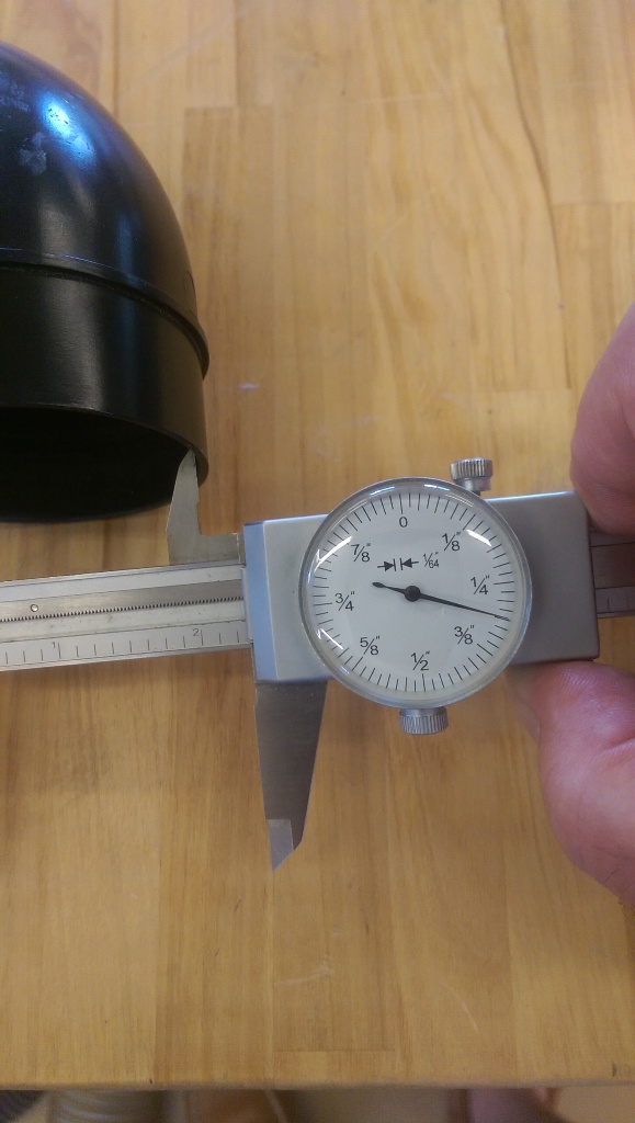

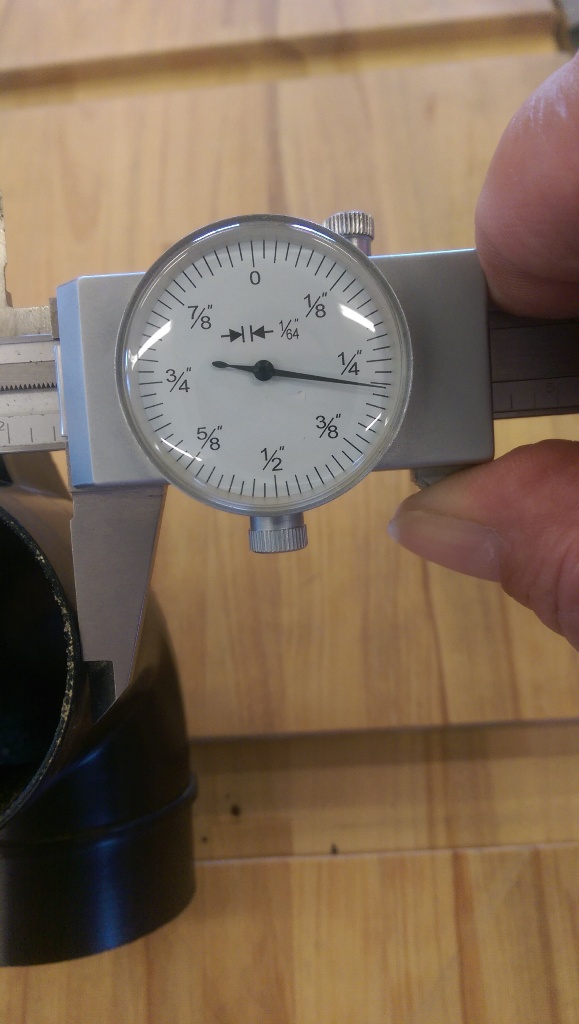

Everything I have here, SS, Woodcraft and Peachtree. I used 2 5/16 as nominal and as I have said they vary slightly from 1/64 to 1/32 less. The female ends are usually a little larger than the male ends as one would expect. You have to measure at the very end because they have a slight taper as you go away from the end.dusty wrote:Whose 2 1/2" hose fittings actually measure 2 5/16"?JPG wrote:rmbishow wrote:Thank you both for your kindness. You have explained an issue that had confounded me. I understand it now and I have a solution to what was not a problem as much as a reflection of my inexperience. Rick
The fact that 2 1/2" hoses have fittings that are 2 5/16"(+-) adds greatly to the confusion.
The pictures speak for themselves.
The two pictures are a SS elbow.
- IMAG0142.jpg (154.97 KiB) Viewed 2645 times
- IMAG0144.jpg (148.28 KiB) Viewed 2645 times

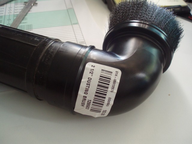

I went to Woodcraft today carrying a couple of the Shopsmith dust collector items with me. I went there with no intention of buying but I did buy a new brush and a union. Both of the Woodcraft items fit quite well on the Shopsmith hoses and elbows. I did not check other pieces because all of the "other pieces" require male ends.
Note that the two new items are different sizes but they both fit ONTO Shopsmith items.
