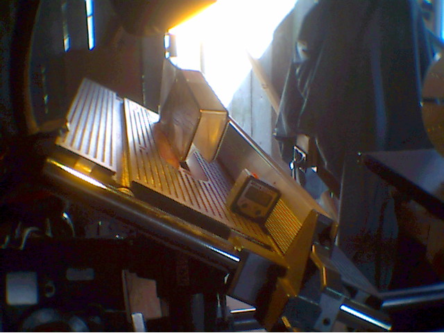

Guess this old soldier is just "brain dead".....but if that thing is magnetic, why would the miter bar not suffice instead of the tenon jig base?
You can expand the bar to stick tight and measure from there....that should take out the "slop"....Magnets on mine stick fine....
Great, I think it will work....but now Dusty and Tobey will now start a thread on measuring compound angles.....:rolleyes:
Doc
Now Doc, that just might be a good thread. Just how accurate can we make compound cuts using the Shopsmith as our major tool. Since it was your idea though, I think you should start it.:rolleyes:
Yes the miter bar will work, sorta. If you are happy with that methodology - that is the method you should use. :)
Actually, you can just hold it tight to the table by hand. That works too.

dusty wrote:mt.
With a larger base, as pictured, it is no longer unstable. I believe I have solved that problem, at least for myself.
With the larger base, I thing that Ed in Tampa might even take a liking to the Wixey and Dial indicator.
Dusty you might be right. The biggest thing I had against these instruments was their susceptibility to movement and being jiggled out original position.
Using the tennoning plate provides a large enough foundation to keep this unwanted movement to a mimimium.
Great Idea.

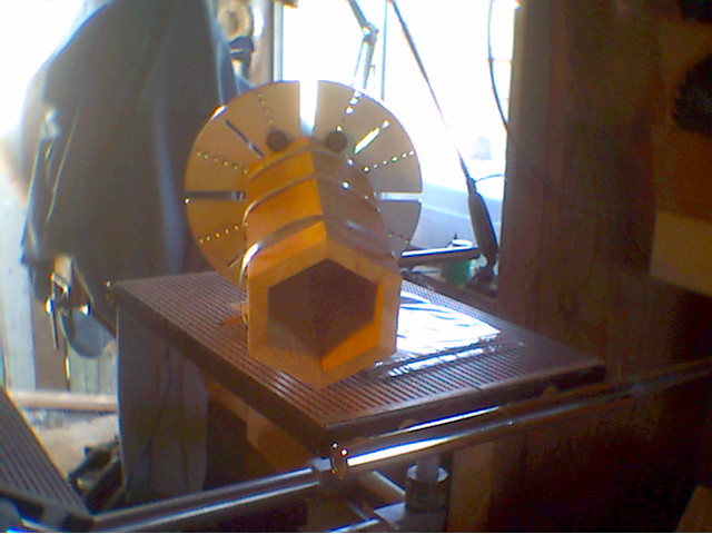

You are teaching me well. Just another way of using the Wixey. The fence helped me keep the wixey straight for an accurate reading. I have a tenon master but this was easier since I needed the fence to make the cuts it saved me time. :rolleyes:

kd6vpe wrote:Dusty,
Holy Cow! KD! Very nice 22.5 degree angles!!! Proof that a Wixey and a Mark V go good together.
Your photos illustrate your system very well!

That was a six sided birdbath a 30 degrees. You are right it should have been 22.5 degrees at eight sides. When I tried to turn it I ran out of wood and it broke and flew off the chuck. I was turning slow so no real dander. So back to the Wixey at 22.5 degrees and see what happens there. I love learning to do woodworking.:o

It is embarrassing to find that I can no longer count. I would have sworn there were 8 sides to that house!:o
