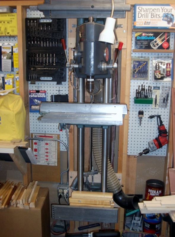

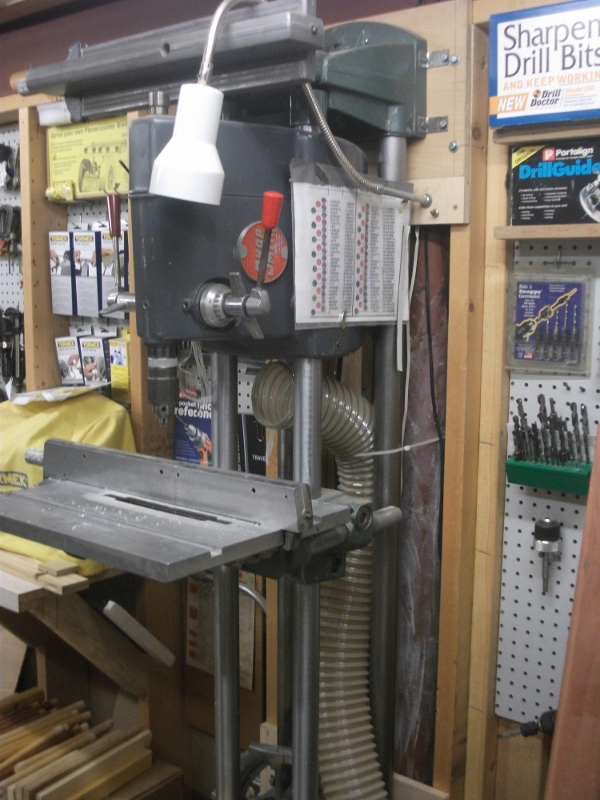

I did not want to cut my tubes on my Mark 5, something just did not sit right with me doing that but I did need/want a dedicated drill press. After a very long thought process I decided to mount the SS to the wall studs without cutting anything. My main goal was to not alter anything on the Mark 5 so I could always remove it from the wall and reassemble it back to its original form. With not cutting the tubes I have full range if I have a need to lower the headstock or move the carriage up or down. I could not be happier as to the way it turned out. See pictures if I did it right.

Love the wall mounted drill press. Do you never find a need to move it away from the wall? My original concern is if the table support tubed would go beyond the wall mount, however I just checked and with the table in that orientation it would be perfect. Now my only concern is how much will I need to anchor it to the wall to feel safe.
-Beave

IMHO u dun reel gud!!!!
Gained a spot to store the other Mark V's rip fence and aux table!
Like the L brackets!
