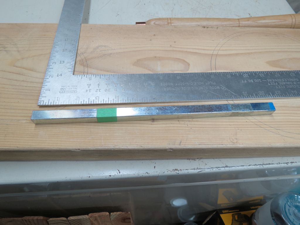

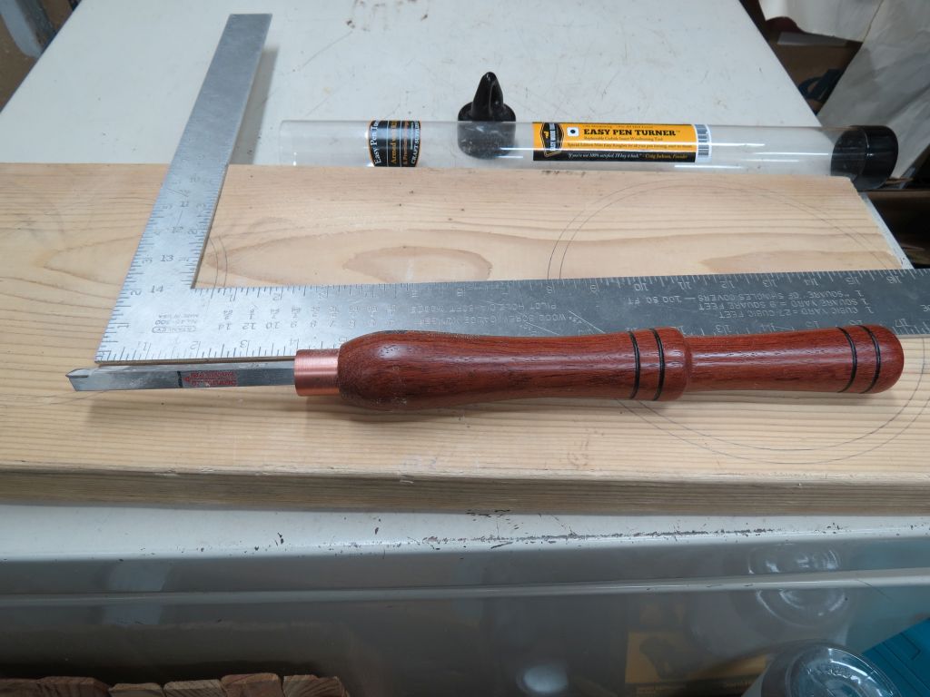

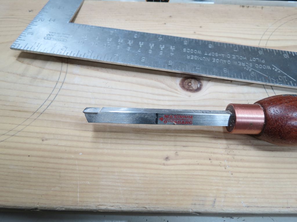

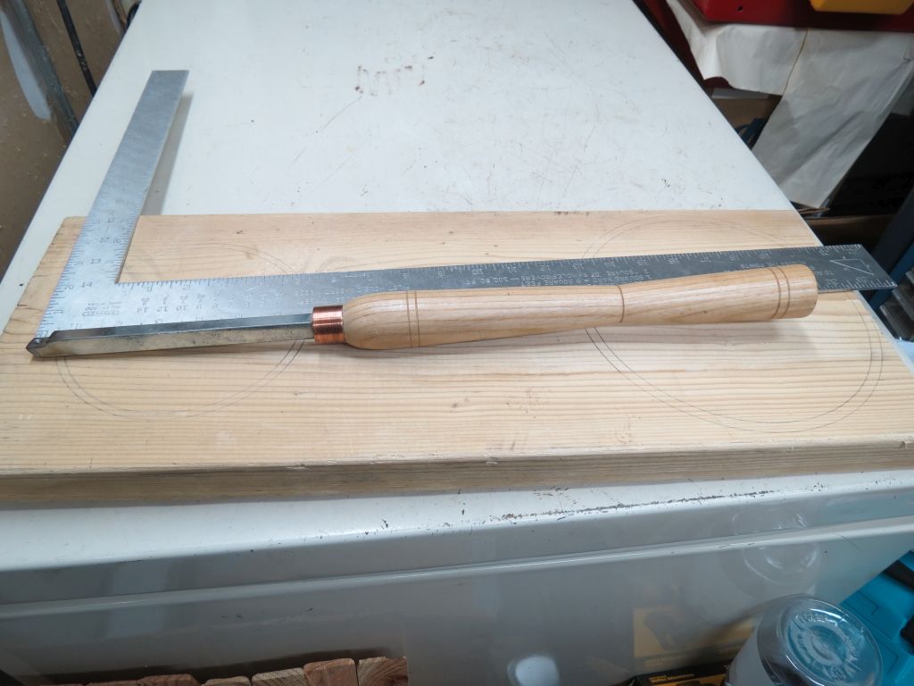

This is the tool that a fellow member supplied me the parts for some years ago. I ground the bar to fit the cutter, drilled and tapped and rounded the section that fits in the handle.
This tool has worked very well for me and was my first such tool.
All the grinding I did on my bench grinder.
I have some material for a second smaller tool that I picked up at a tractor store as a 1/2" square key. It is 12" long and who knows I might get around to that project some day soon, it has been more then a year since I got this but with so many things to do, well its on the list.
As a reference this is an Easy tool, this one is the "pen" edition. If I recall I think I spent $79 on it.

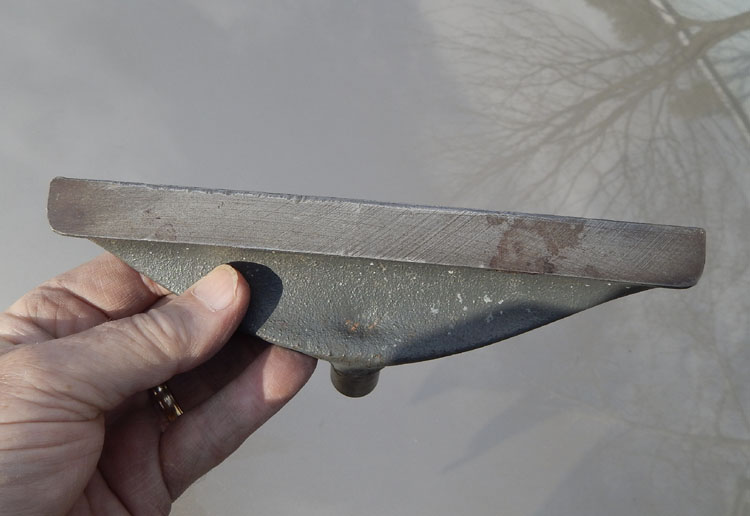

And I mentioned the tool rest, this is mine and could use a fresh dressing before I use it again but it still use able if I don't get to it right away.

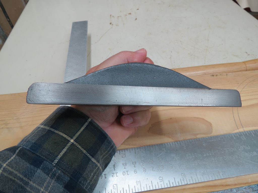

Ed (reible) pointed out the importance of a smooth tool rest.
I've found an ideal, fast method to dress the tool rest. I use the belt sander in vertical position. I use one of my green belts and it (belt) shows no wear. The tool rest is very straight and very smooth.
I used to use a hand file. Too much work and not as smooth.

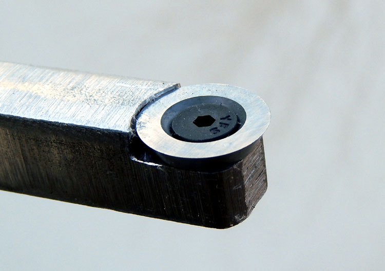

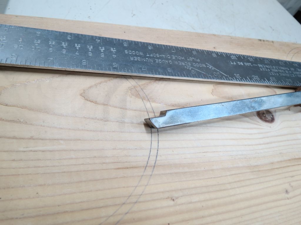

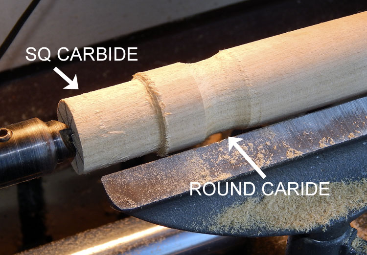

]Well I did the thing no troubleshooter should do: I changed several things at once and now I don't know which one gave me the results. It is the round cutter in my opinion. I have a radius square insert on order and will try it out in a few days. My second steel bar chisel came out much better than the first one.
Daylight time ended this morning and I ran out of daylight this afternoon, so the sample turning only lasted a couple of minutes, but seems to have yielded results. Now, on to other wood species, and some glue ups.
Other posters were right about my tool rest. The knife edge looks like it has been the subject of much abuse. Storage in a plastic bin with other accessories comes to mind. I dressed it on the 12 inch sanding disk but only spent a few minutes on that. I didn't get all the nicks out.
So, I had to unmount the lathe set up, mount the sanding disk, grind the chisel bar and the tool rest, and return to the lathe set up. But I'm pretty pleased with the results. I will have to contemplate what else needs to be done to the tool rest and do some gluing in the meantime.
Cheers.

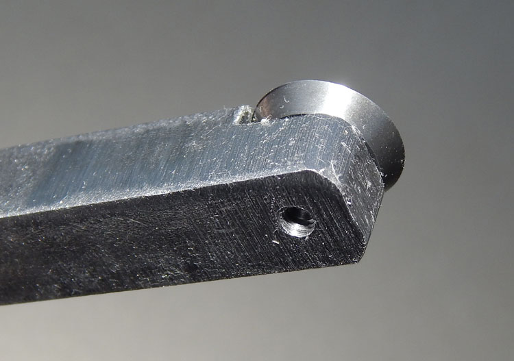

new carbide chisel
new carbide chisel

the poplar dowel with results of round carbide

I got the radius square carbide insert. My third steel bar didn't come out very good so I replaced the insert on the first steel bar. The posters were right. The radius square insert worked MUCH better. I set the speed dial at "L". I hope you can see the improvement of the cut on the same old poplar dowel.(No additional maintenance on the tool rest so far.)
results of three different carbide inserts
