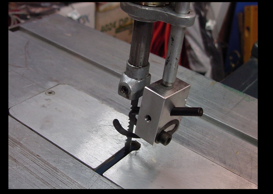

I know this is kind of a dead thread, but Dennis, here is a picture of the aluminum replacement foot ....BuckeyeDennis wrote:Where did you see those aluminum replacement feet? Mine was badly cracked/crazed when I got it, and then a minor accidental drop broke it in half.rjent wrote:Mine is just amazing. Works great
One bolt attaches it. I am concerned about the presserfoot being made of pot metal, but I have seen replacements made of aluminum.
Top half comes off (with a spacer for the bolt) and turns into a saber saw using standard hand jig saw blades.
Very impressive operation for something 60 years old. Took mine apart (like I did the rest of the machine), cleaned it up, painted it Verde Green and carried on. Not much to it ....
- 10ER Jigsaw foot.jpg (307.74 KiB) Viewed 3808 times

Thanks Dick. That photo is going in my Model A-34 jigsaw file. I don't have the equipment to mill aluminum myself, but maybe I can get a blank of the right size, and just drill & tap it. I'd bet that even hardwood would suffice in a pinch.rjent wrote:I know this is kind of a dead thread, but Dennis, here is a picture of the aluminum replacement foot ....BuckeyeDennis wrote:Where did you see those aluminum replacement feet? Mine was badly cracked/crazed when I got it, and then a minor accidental drop broke it in half.rjent wrote:Mine is just amazing. Works great
- rjent
- Posts: 2121
Re: ER Vintage Scroll Saw
I found the image in the Yahoo 10ER site. The description says that the block was totally made by the 10ER. I think drilling the holes should be easy in aluminum and tapping them for the set screw(s) should be pretty easy. I can't figure out how the block attaches at the top. Since you broke yours, how does it attach?BuckeyeDennis wrote: Thanks Dick. That photo is going in my Model A-34 jigsaw file. I don't have the equipment to mill aluminum myself, but maybe I can get a blank of the right size, and just drill & tap it. I'd bet that even hardwood would suffice in a pinch.
