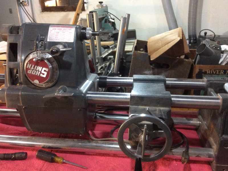

I know pictures or it didn't happen. Here is my soon to be sanding station.
Picked up my fourth ( yes I know I have a problem). It's a 510 came with a jointer and some extras. Needs some TLC.
So the next project begins. Who needs woodworking projects when you can have Shopsmith projects. Maybe after this is done I'll build something out of wood. :D

Oh you got it so bad!!!!!!!!!! :eek:
You are right, I spent the summer of 14, rehapping more SS and some other stand alones then wood working. Well worth it. I did not make them show ponies but bearings, belts and some derusting, some repainting. It was worth it, bargain CL stuff and some work for quality machinery.

cooch366 wrote:I know pictures or it didn't happen. Here is my soon to be sanding station.
Is it going to have an "Extension Carriage" (TM :rolleyes: )?

I've started looking at a design, I'll be able to use your idea in drilling & bolting it to an extension table, and drill / mill access holes for the main table legs to pass thru. At first glance it looks like they will clear without removing too much of the support structure in the extension table. I just need to position it so I can fit disks thru the main table. Which I have not looked into yet.
More to follow......
