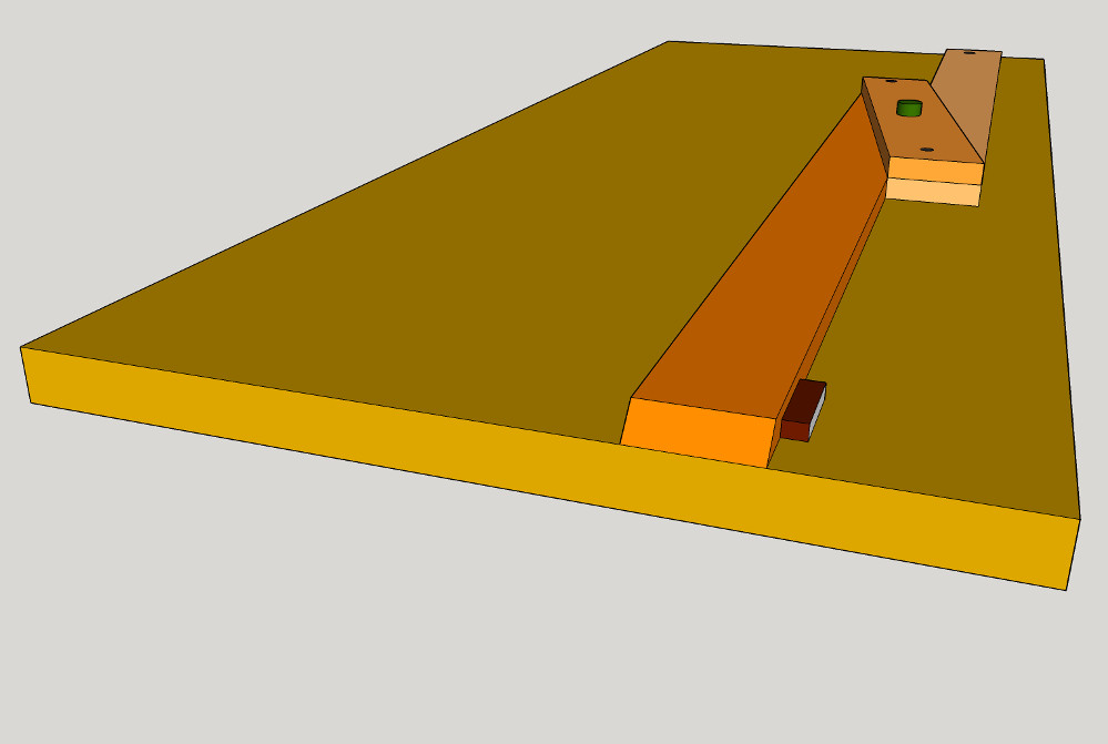

Quick drawing
this would be looking at the drawer bottom up side down with the back facing you
The green cylinder is attached to the case as the pivot point (maybe by a screw ??), the front attached to the drawer bottom and the back has guides on both sides (though only one is showing) to keep the back arm going in the correct direction.
As the drawer is pulled open, the anchor point (pivot), because it is fastened to the case forces the other arm towards the back of the drawer.
Though it does not show well, the back arm has a bevel if you would prefer it on the arm rather than the post (rod)
Hope this makes some sense.
Be well,
Ben
