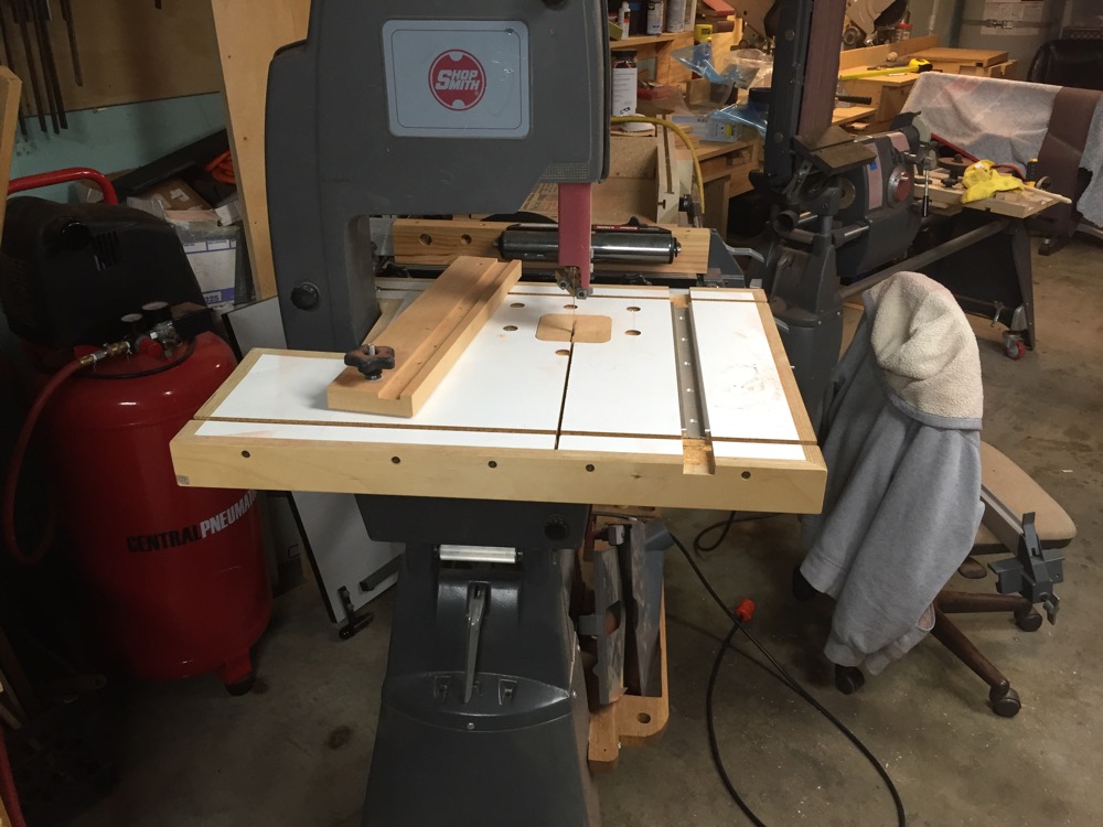

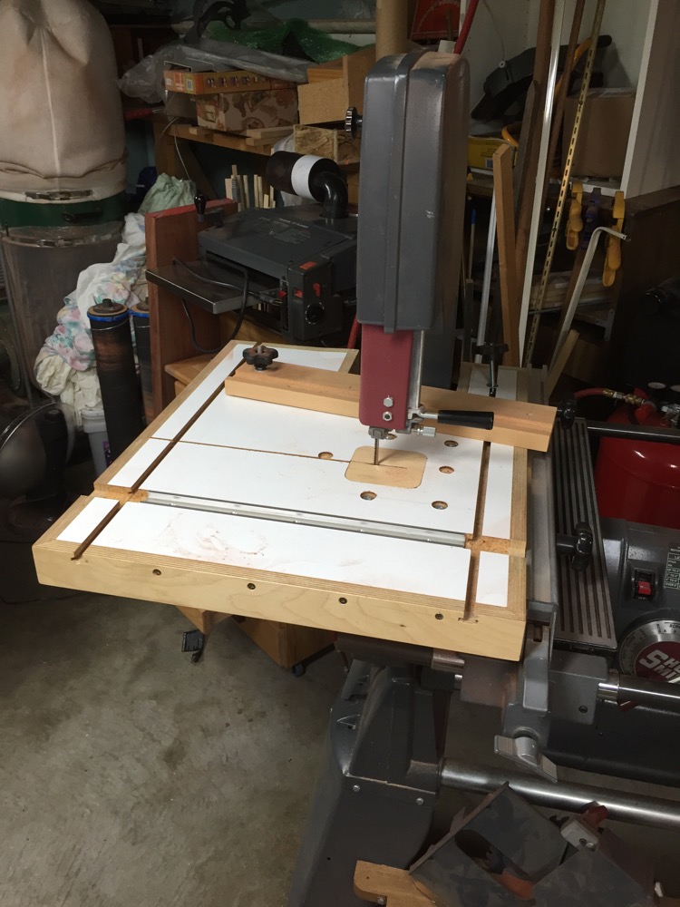

Going back to the original post I think both the old and the new lack in size. You can make your own of any size for next to nothing. Mine allows me a large enough surface for jigging etc. I get away with that size table because I never remove the saw from the SS. If you are going to remove it I suggest a smaller table
Paul
