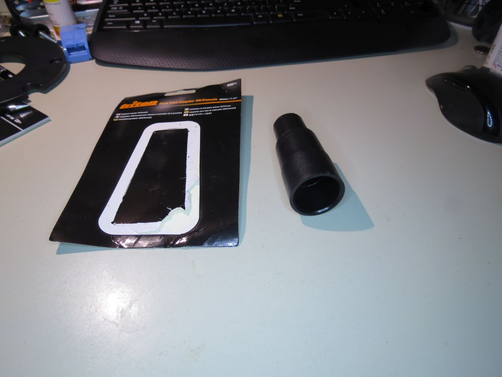

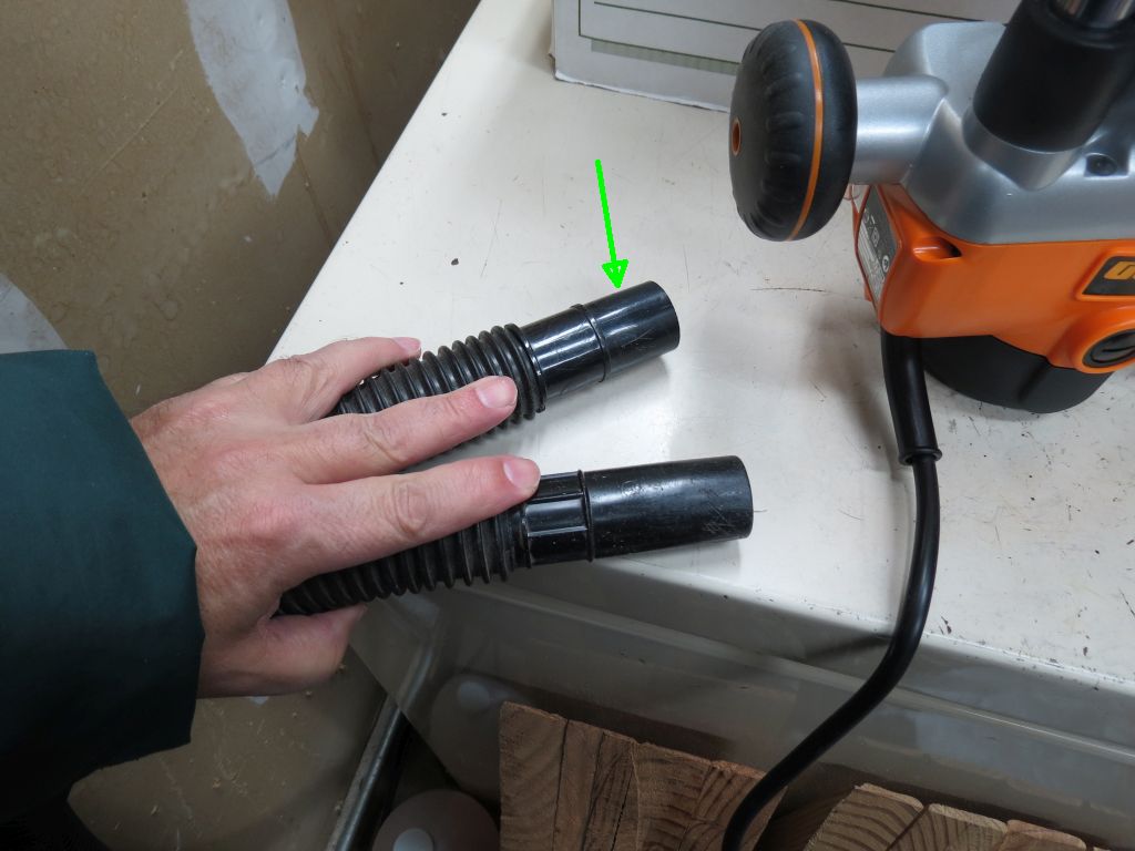

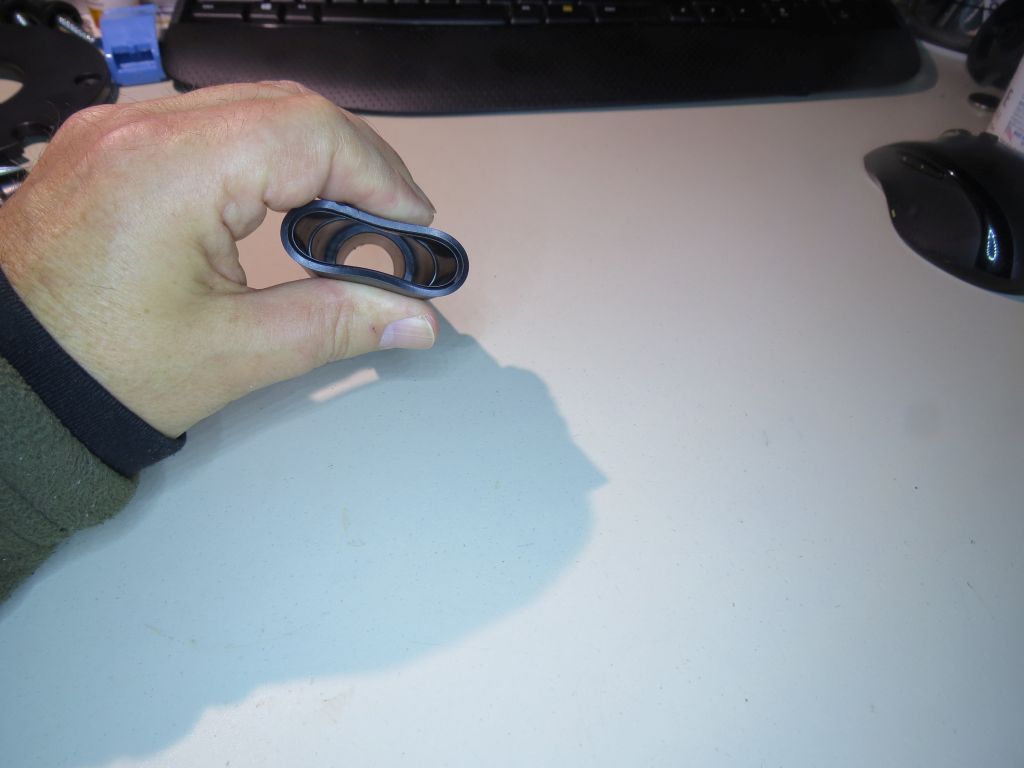

Well that was pretty fast. The dust port arrive just after noon today, wasn't scheduled until tomorrow.
Of course I had to open it right away.
I will give it try with the router sometime later today and I have high hopes. The piece is flexible and should conform to the port. As a guess I think I will be trimming off then small end. Then of course I have to see if I have a hose that will fit it........

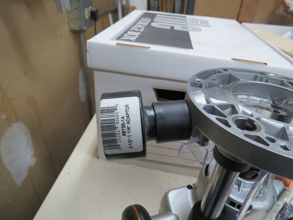

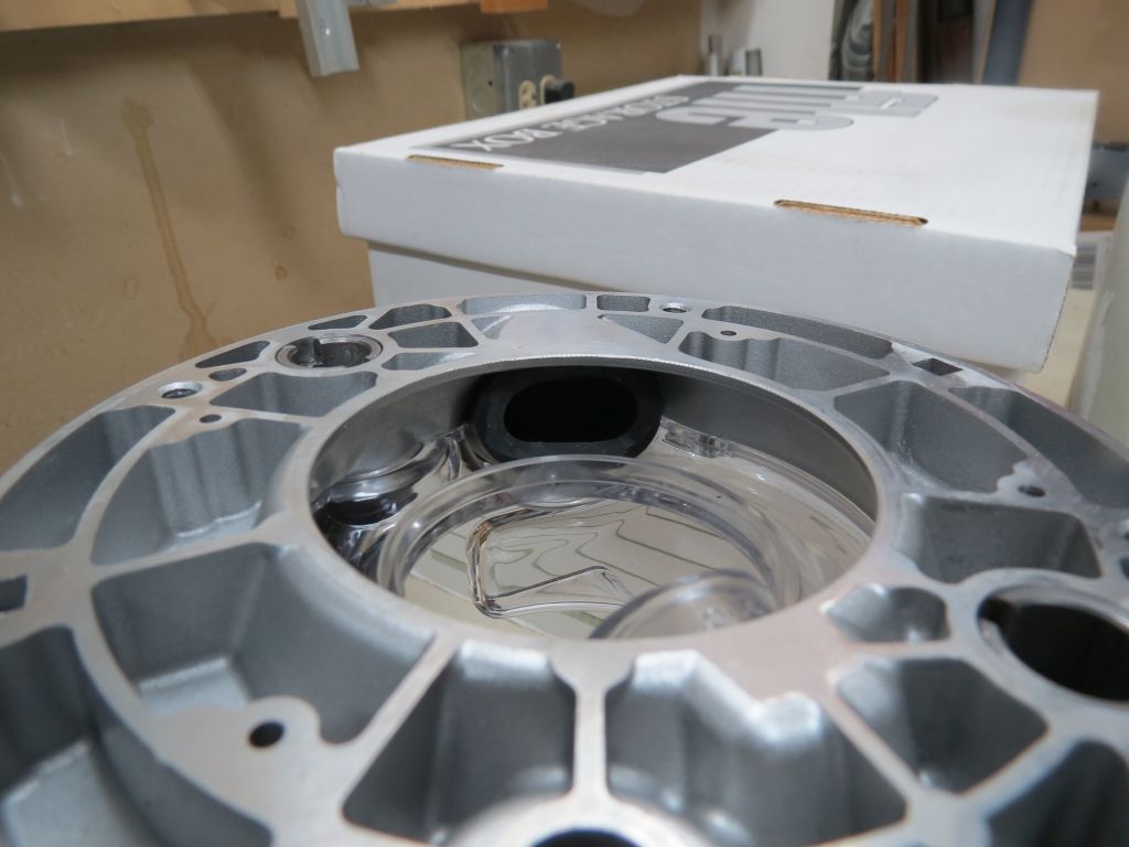

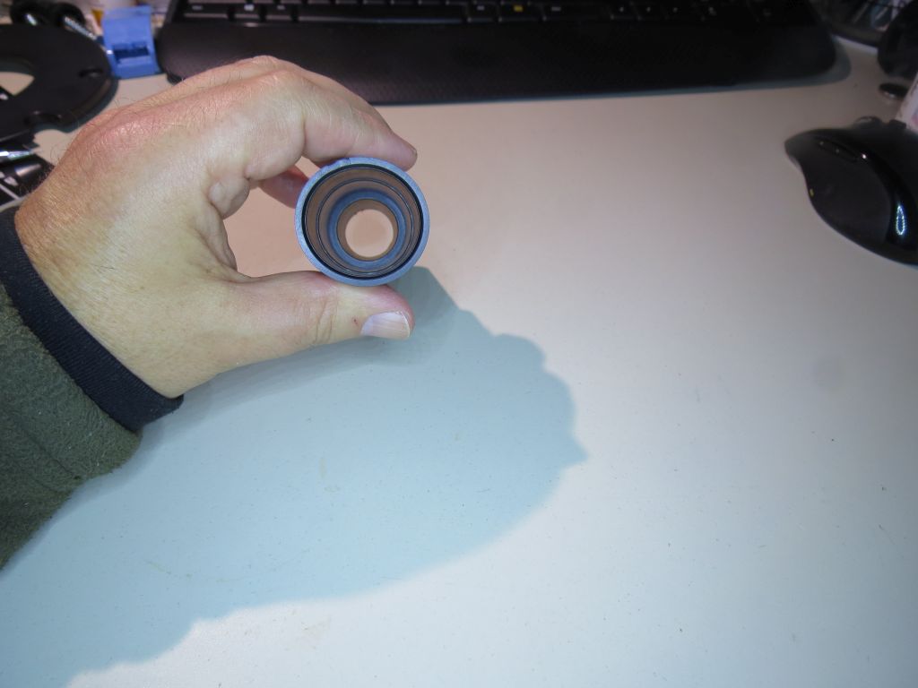

General information on the dust collection issue.

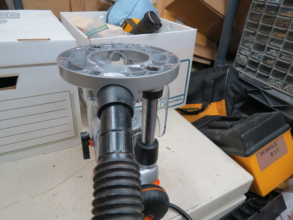

Here is a picture of the adapter (screwed) into the dust port and a hose attached.
Looking at it from inside it looks like this:
Keep in mind the sub-base is off in these pictures.
I cut the small end off the adapter because it came inside the router too far. I stated playing with the vacuum attachments I have, hoses and adapters. Any of the smaller "1-1/4 hose ends fit but not all the same amount of retention. While these hose ends serve the same function they don't work alike. The green arrow points to the one that fits best.
The best fit I have is not a good choice for hand held operations because it takes it to a larger hose with that much more stiffness and weight.
After all of this I'm only marginally happy. I'd like to see a better hold, not that it is bad, but then it isn't great either. Final judgment will be after I trying using this in a real world job.

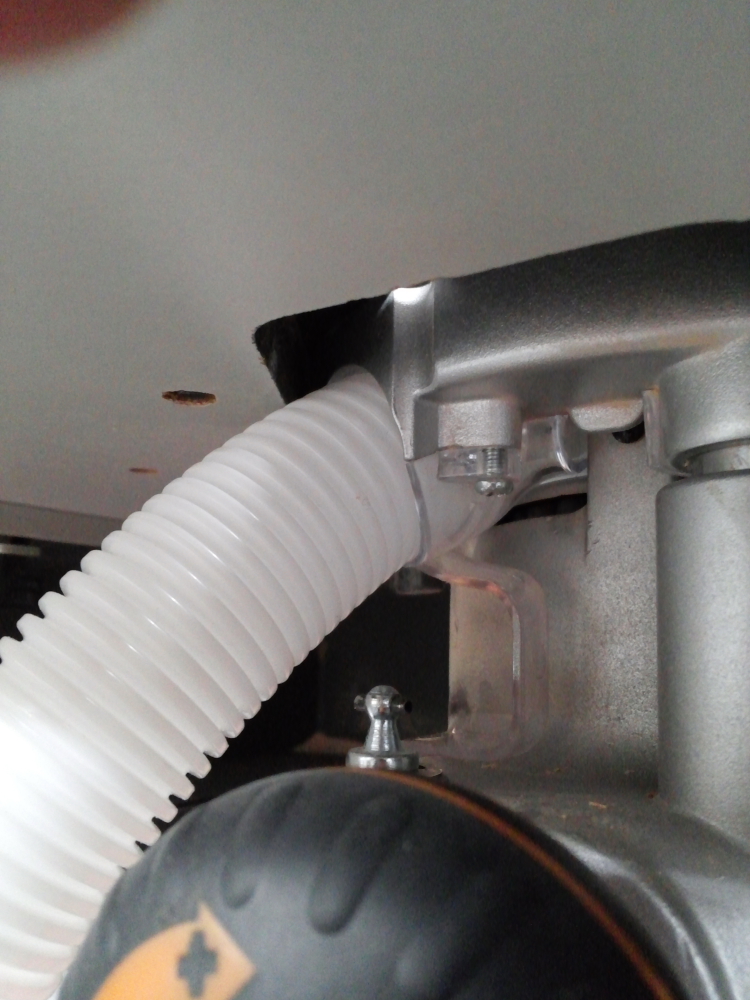

Re: Might be a good deal..... Triton 2-1/4 HP Plunge Router
My trip to the Ace was a bit of bust. They did not have the same hose but in the size I wanted (a larger size then I have). They did have a much stiffer blue version which I got a short section of but it is not going to work. For now I'm going to use the smaller hose I got at Menard's, well until I find a source for the other hose.

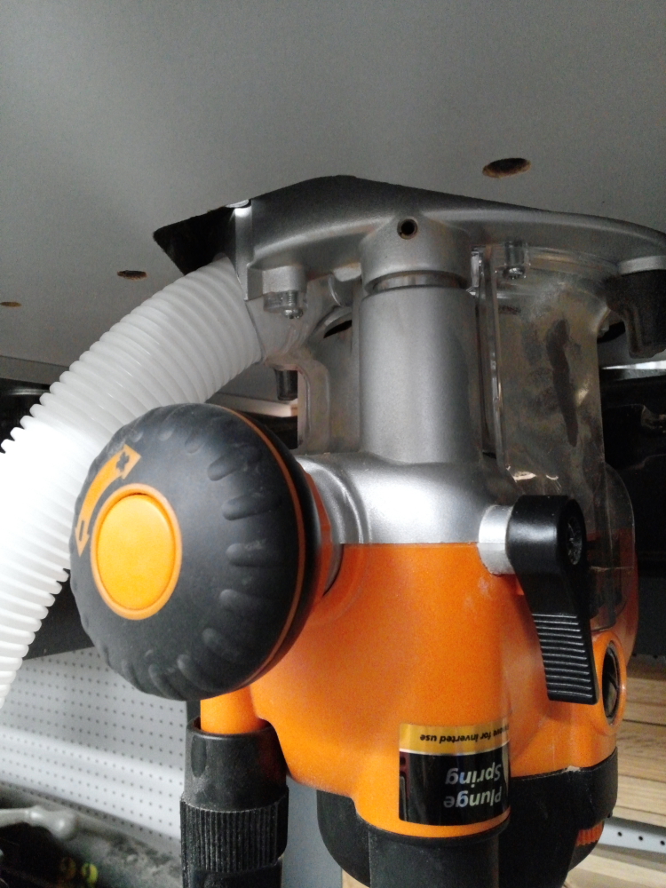

I got the router mounted and everything seems to check out function wise. The smaller hose can fit where the blue was just too stiff. It is tight in there but I can reach all the controls and make adjustments. The lock is a bit of a reach because of the location of the power switch on the cabinet but it is do able.
I working several projects so I have yet to test the table out but maybe tomorrow. I will then have a better idea how the hose works and if it is worth the effort or if all the plastic shields will have to come off and just attach to the back of the cabinet as it was designed to do.
I'm trying to decide how to store the spring. I think the router will be installed in the table almost all the time but if I for some reason want to take it out I need to be able to find the spring.......

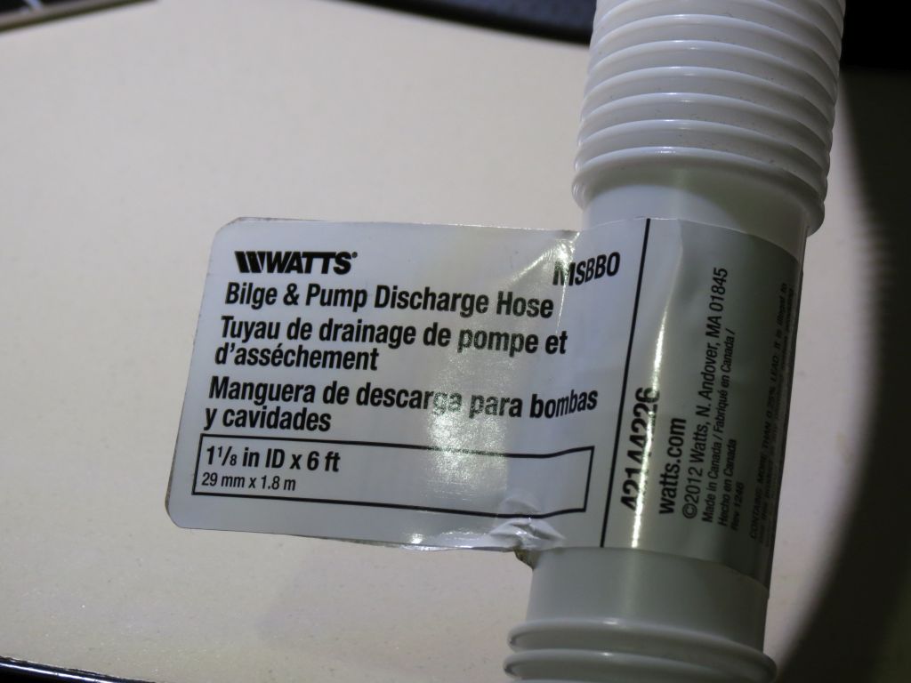

Places to try , Hydroponics stores, Marine Supply stores (boats), Swimming pool supply stores.reible wrote:My trip to the Ace was a bit of bust. They did not have the same hose but in the size I wanted (a larger size then I have). They did have a much stiffer blue version which I got a short section of but it is not going to work. For now I'm going to use the smaller hose I got at Menard's, well until I find a source for the other hose.
If my hose had been a bit undersized, I was planning to build it up by wrapping it with tape where it clamps into the router port. That didn't turn out to be necessary, though.
I looked briefly at Amazon to see if they sold the same size bilge hose. I didn't see any, but one they did sell cautioned that it was not for use in a vacuum environment. So as a test, this morning I hooked my 5' hose up to my big shop vac, and blocked the hose inlet to get maximum vacuum. No collapsing problem, even when I squeezed those straight hose sections pretty hard by hand. And the flexible/ringed part is certainly not going to collapse.
Ed, if you want me to buy a piece of the hose at my Ace store and ship it to you, PM me. It's very lightweight, so shipping shouldn't cost much. You too, Ben.

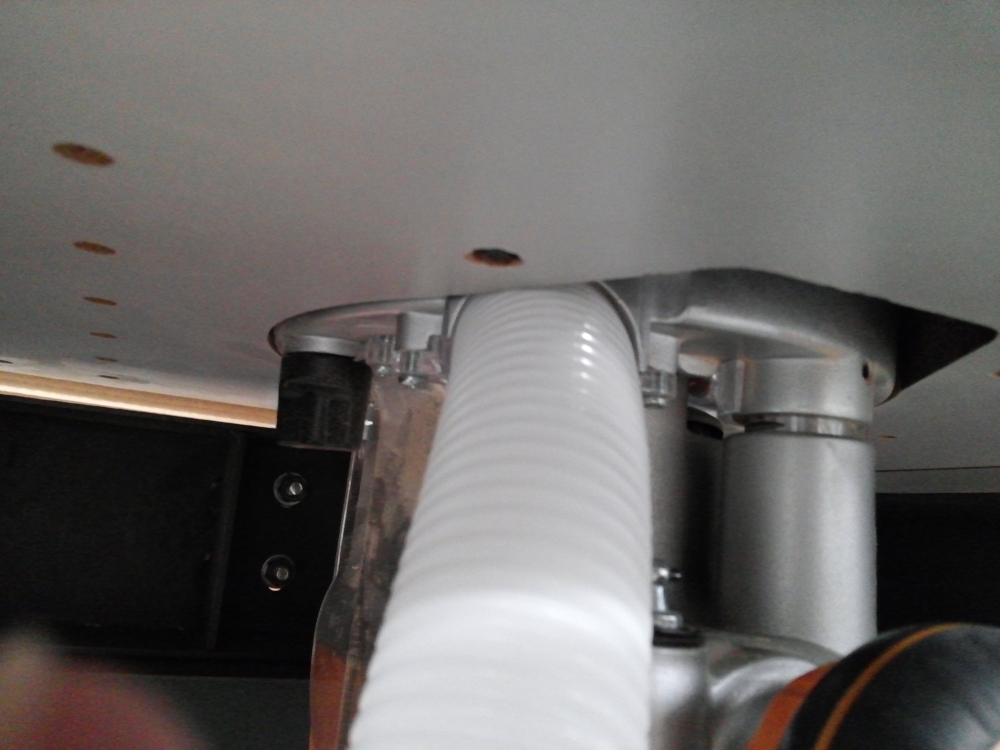

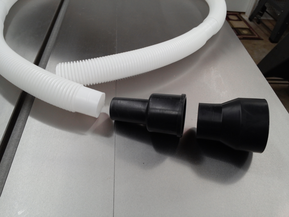

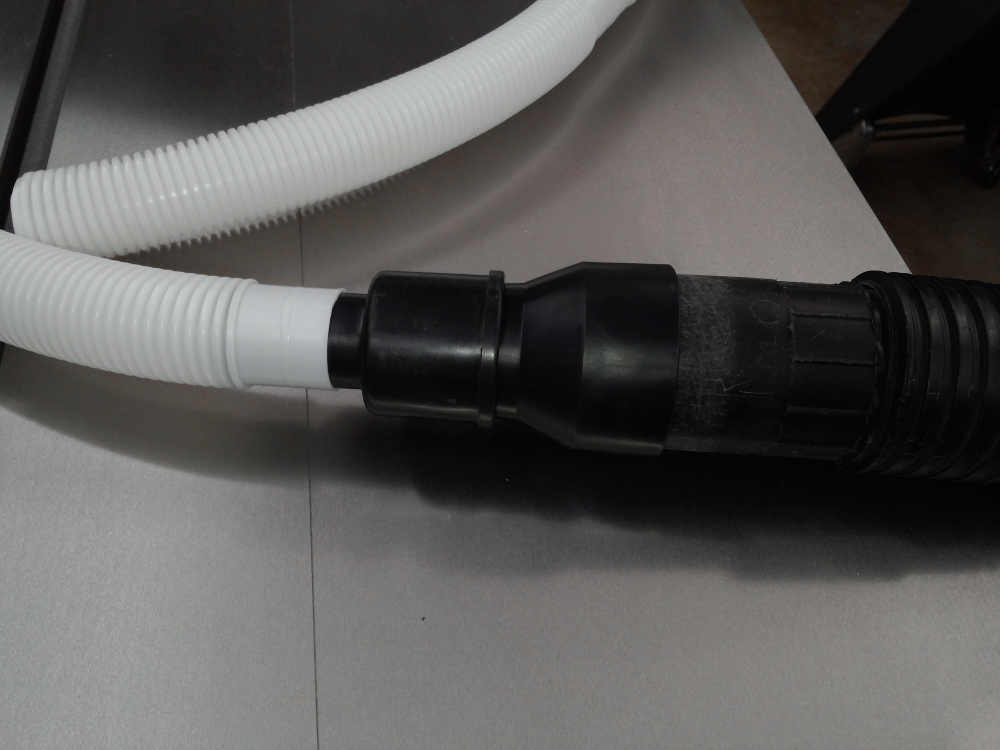

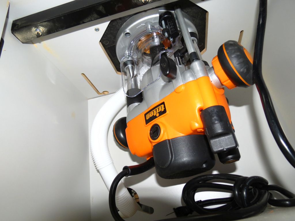

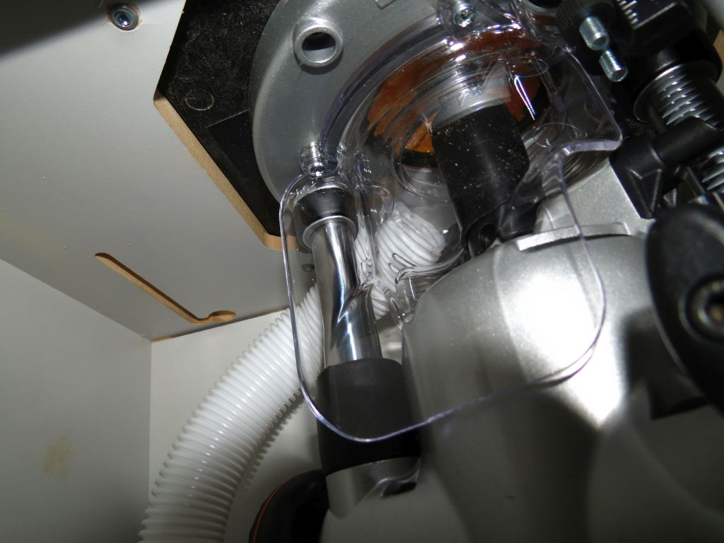

Things did not progress as well as hoped on other projects so I had only a few minutes time to work on it today. The blue hose I got happens to fit an adapter I have and the other end accepts the white hose so I have connection system. I have to dig out a Y adapter now so I can hook up both the fence and the router dust collection ports. I think I have a spare in tub with all my other parts like that.

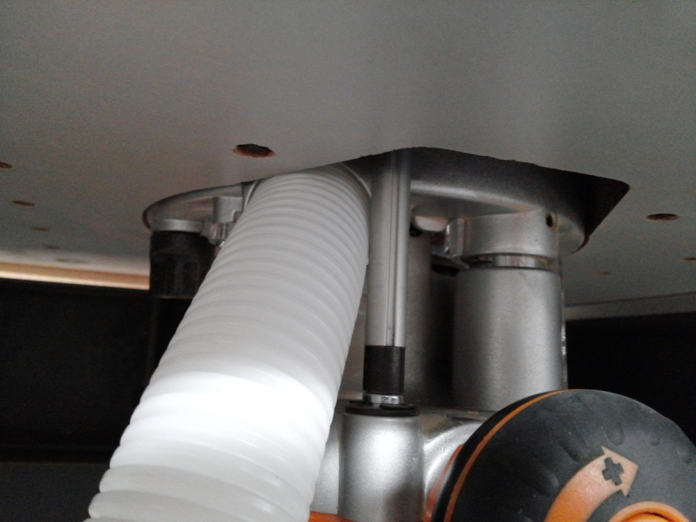

I did manage a picture of the inside of the cabinet and how the hose is connecting. Like I said it is tight in there but do able.
I was thinking that if I see too much leakage at the router I can always get some of that peel-able/removal-able caulk and use that at the connection. I used that on some old windows and it worked well at keeping the wind out until I could do a proper repair and just like it said it peeled right off without a trace.
I have to be out and about tomorrow so it might not be until Sat. that I get to fire it up and tested out.
