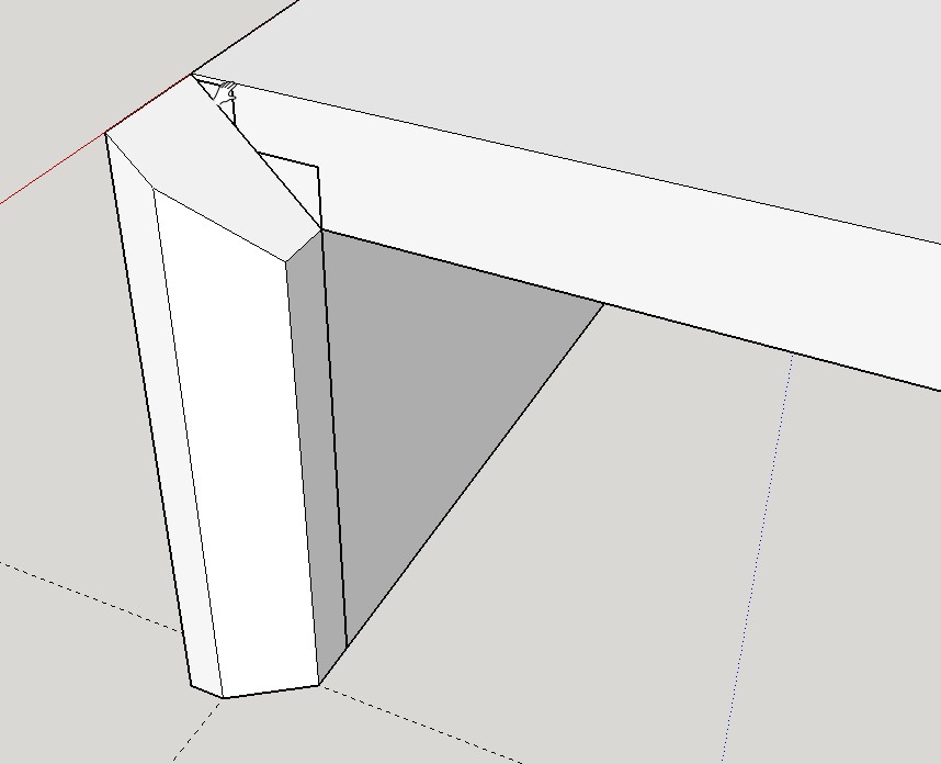

reible wrote:Hope this makes the joint clear enough to understand.
Yes, that makes sense. Another part of the problem is she wants the edges of the opening beveled (not just mitered at the corners) as well! Drawers will sit back as far as the bevel. Her design aspirations exceed my build capabilities!

Re: Build Dilemma
Would this be the sort of bevel she is looking for?
ScreenHunter_93 Feb. 10 22.38.jpg (38.67 KiB) Viewed 2709 times
The plywood edge would need to get covered anyway and the bevel if it looks like this needs to be made in real stock and not plywood.
algale
Posts: 4841
Re: Build Dilemma
Post by algale »
reible wrote:Would this be the sort of bevel she is looking for?
Hi Ed,
That's almost it but she want no step to the bevel and probably sharper. She is aware of the ply issue. Seems not to be bothered by it, though I am. Clearly the easiest and best looking way to do this is to add a beveled face frame after the build is done.

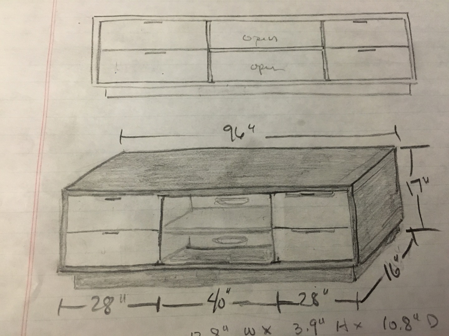

Posts: 4841
Re: Build Dilemma
Post by algale »
So here is my wife's sketch. Not shown is the inward bevel on the edges of the carcass.
Re: Build Dilemma
A good "right brain' drawing!
Leaves it up to your "left brain" to figger out how.
Interesting, she doesn't mind the ply edge yet wants a bevel.
A recipe for "that is not what I wanted" IMHO. :D
