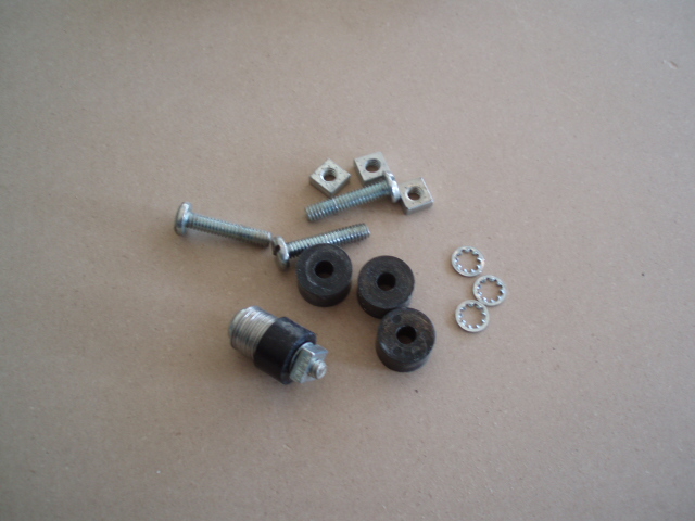

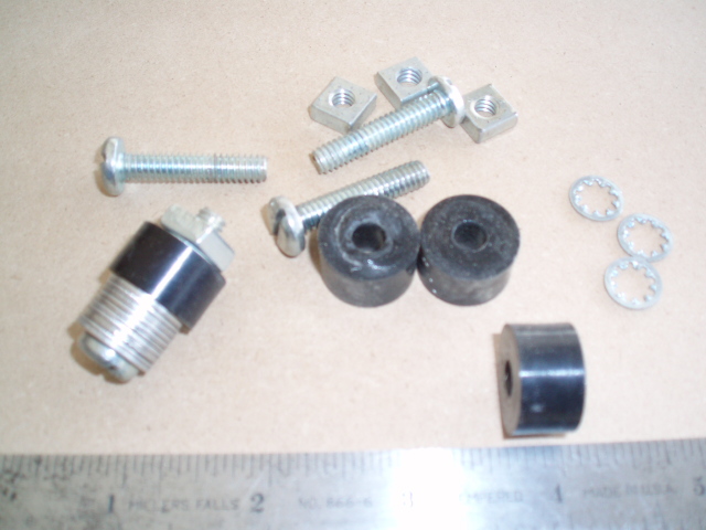

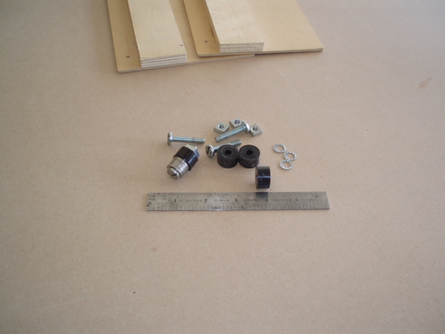

lv2wkrkwd, I think these photos will answer the question in your PM.
The hardware I used to mount these casters on the Power Stand that now carries my Belt Sander is different than what is used on my Power Station and Crafter's Station. The bolts are longer but don't need to be as long as what I show here. This is the hardware that came with the caster sets. I suspect that the bolts used were those required for the worst case scenario (1 kit serves all).
[ATTACH]3252[/ATTACH]
[ATTACH]3253[/ATTACH]
[ATTACH]3254[/ATTACH]
Note the stack of washers on the one bolt. Could be used in lieu of spacers which could also be replaced with a wooded dowel that has been drilled out and sized.

Dusty - looks like just what I needed. As usual good job. Thanks
