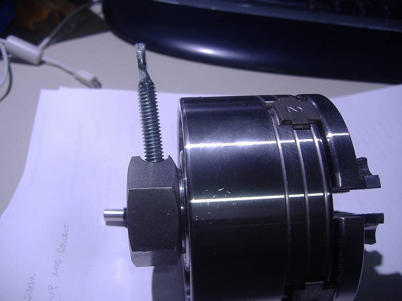

So just to make this clear. All of shopsmith arbors and the like have this about 3 degree tilt. You can and should see this even with your allen wrench each and every time you take thing on and off. I had noticed this many many moons ago and when I first address this some people here were not believers. The truth is out there and you can prove it to yourself.
Pull out the set screw and insert a bolt of the same thread size the is several inches long. Now look at it. Below is an example.
See I'm not crazy.

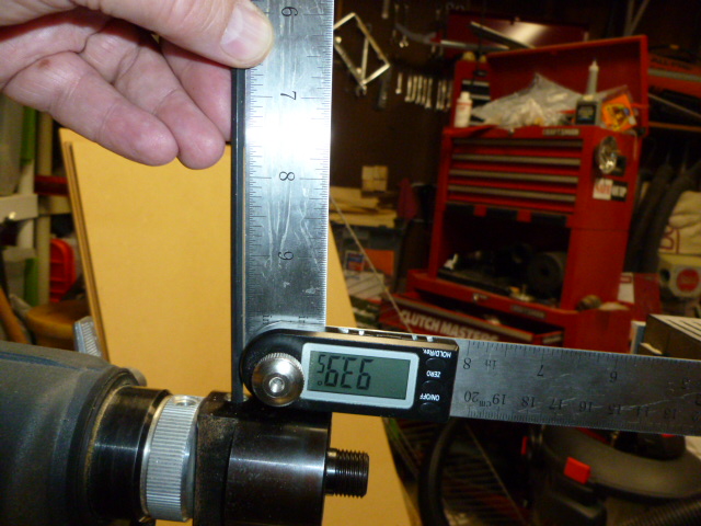

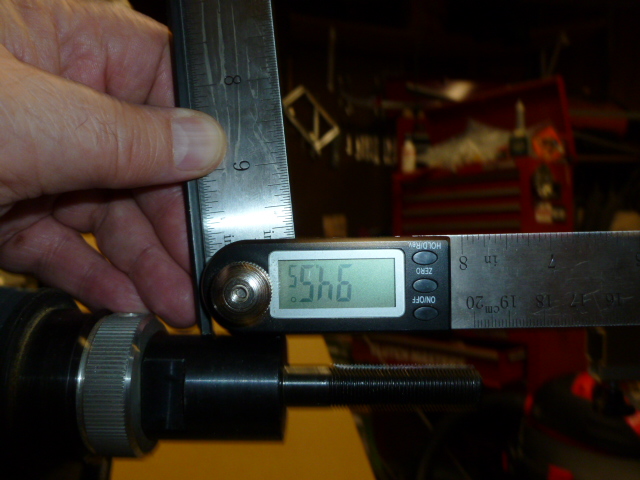

Is this really true? I understand the concept but is this really what SS does, slant the set screws. My bet is no. Sorry Ed but I think you had another problem besides a "not really a SS adapter".
You lose that bet
2 different arbors (sorry the display of the digital protractor is upside down)
The display clearly shows more than 90 degrees and no I did not try and push the hex wrench to one side. I put the arbors on. tightened then and what you see is approximately where they stayed.
Two different arbors, saw and shaper, the first I just grabbed.
Ed, you should have bet more! :D
Be well, Ben

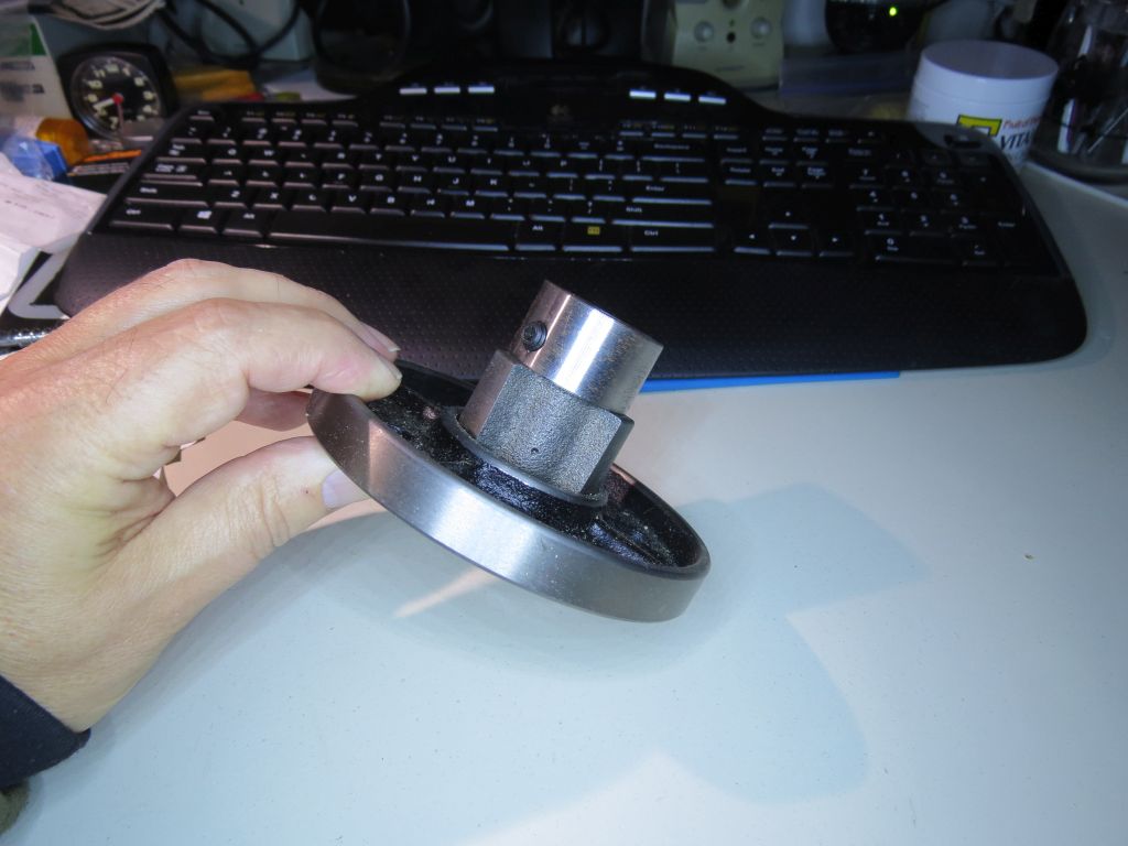

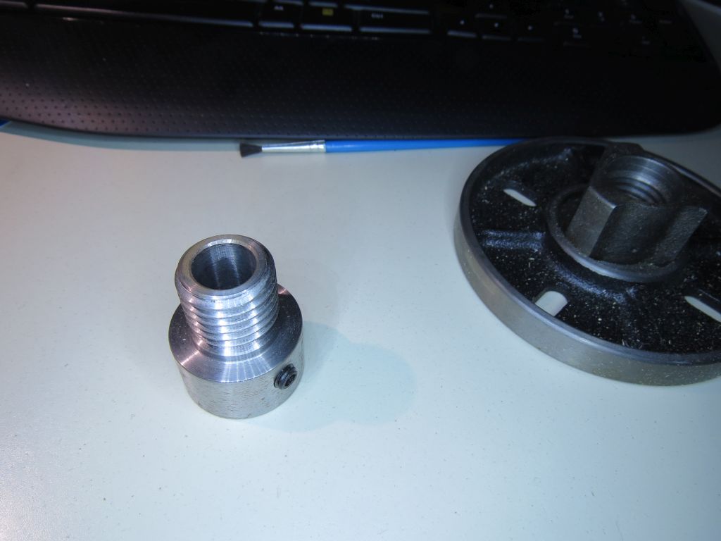

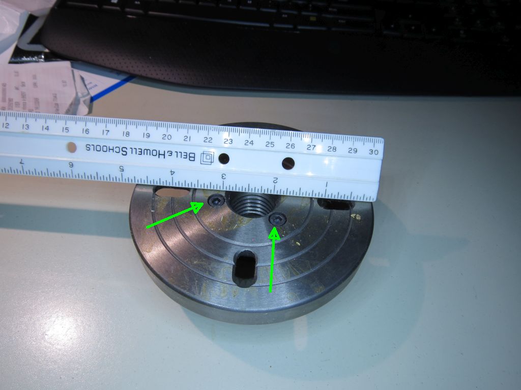

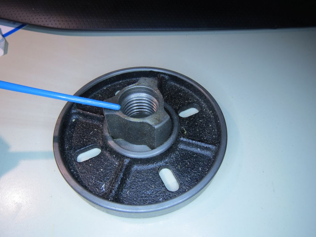

Here is an example of a non-shopsmith face plate. I don't recall where I got it but it is a cast iron version and as you can see about 120mm. It is quite heavy when compared to AL based ones.
The face plate is sold to fit different lathe spindles by way of an insert. The green arrows point to 2 of the three screws that hold and align the face plate to that adapter.
When we flip it over you can see the adapter, via the blue paint brush handle. This is a 1" - 8tpi adapter but they had other common spindle sizes but none for the shopsmith.
So to get it to fit a shopsmith you need yet another adapter. This is the one that I now use, it is about $60 but is far shorter then others that are on the market and has the set screw at the shopsmith angle.
BTW shorter is usually better in terms of lathe use and chucks/face plates so the chucks like the nova ones with the internal adapters are preferred way to go.
Now when it gets put together it looks like this:
