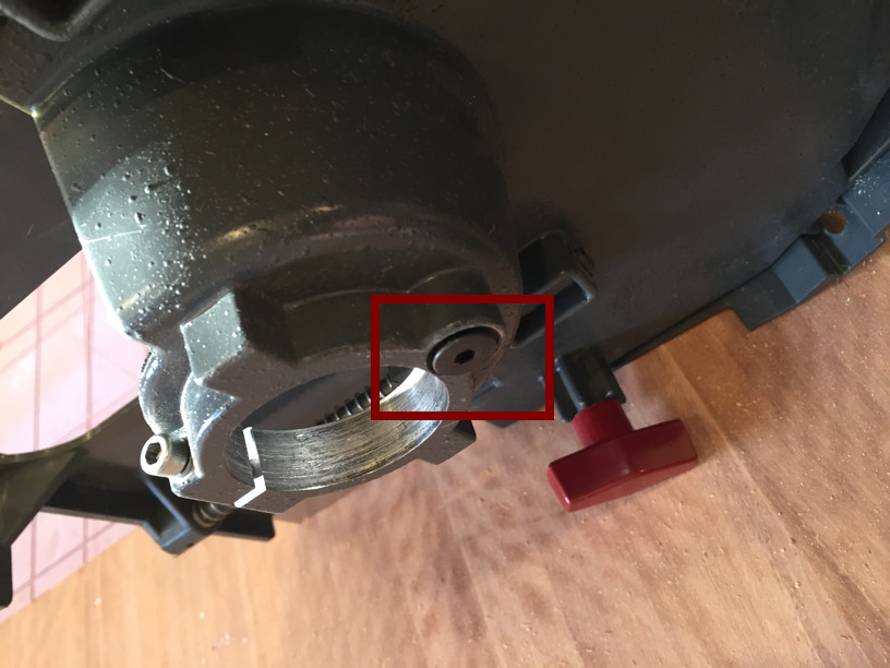

dusty wrote:With regard to the set screw, the alignment procedures for both the band saw and the rip fence tell us in the first couple steps (of the respective procedures) to back the set screw out so as to not be making contact with the rail.
Just to clarify, that be the one(s) in the fence.

Yesterday I went into the shop and took the fence on and off about 50 times or so and checked alignment and it was perfect every single time. So I figured it must have been technique.
Then I took a scrap of wood and made a cut, still perfect. until I put the bladeguard and riving knife on, and made a cut. The peice was pulling away from the fence on the outfeed end of the fence. I stopped and checked the fence alignment again, and even grabbed a known square setup block and then finally saw the problem as shown below
Riving knife offset
Riving knife offset
My riving knife was out of alignment with the blade. A quick adjustment of the set screw on the blade guard, okay it took me an hour to get it perfect, and everything is now okay.
Guard alignment screw
Thanks everyone for all your help
