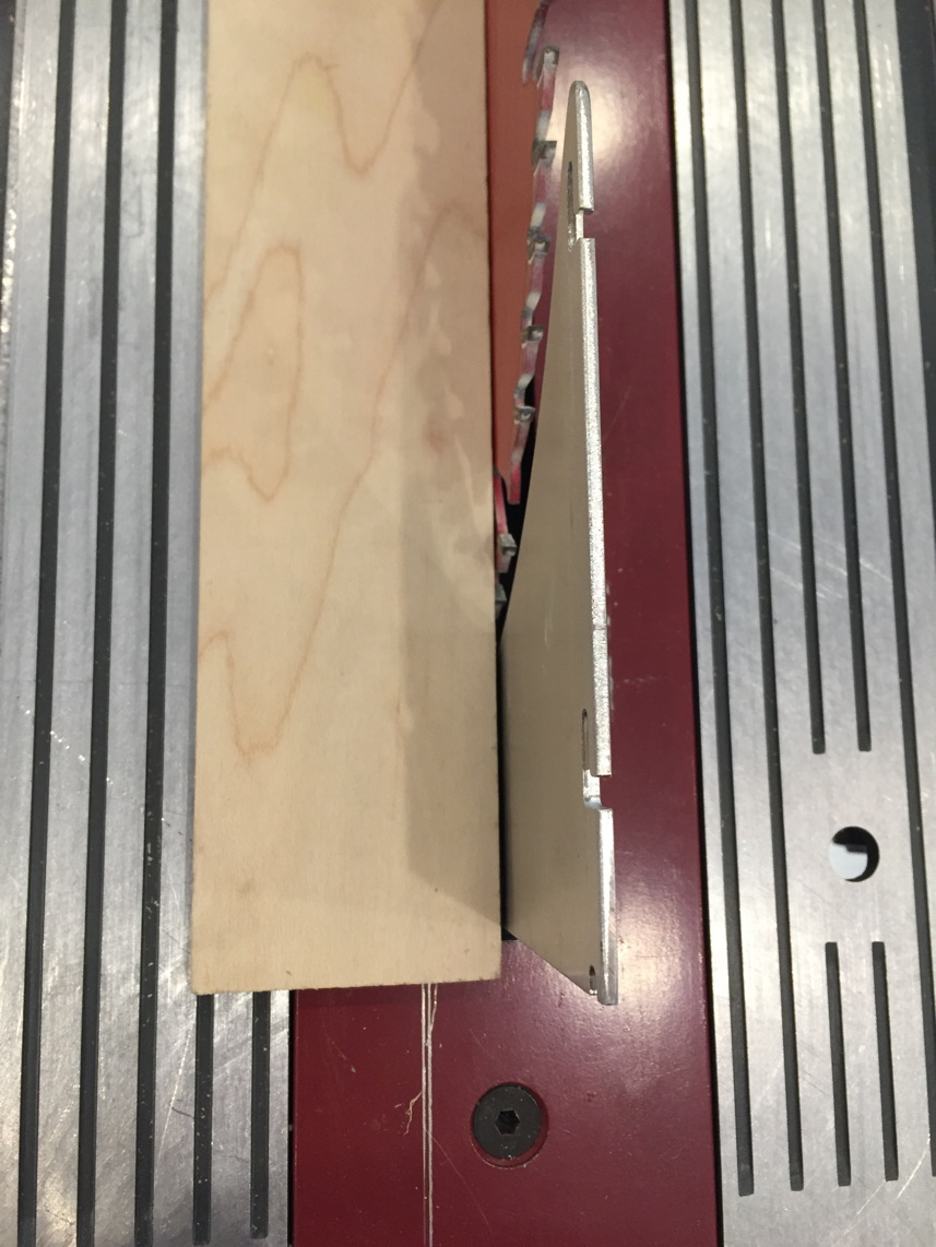

Yesterday I went into the shop and took the fence on and off about 50 times or so and checked alignment and it was perfect every single time. So I figured it must have been technique.
Then I took a scrap of wood and made a cut, still perfect. until I put the bladeguard and riving knife on, and made a cut. The peice was pulling away from the fence on the outfeed end of the fence. I stopped and checked the fence alignment again, and even grabbed a known square setup block and then finally saw the problem as shown below
Riving knife offset
Riving knife offset

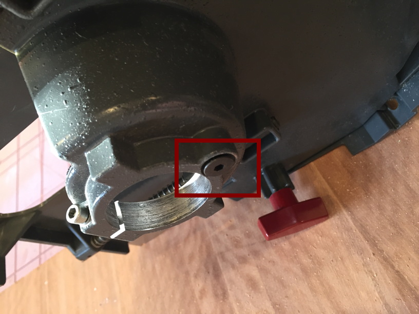

My riving knife was out of alignment with the blade. A quick adjustment of the set screw on the blade guard, okay it took me an hour to get it perfect, and everything is now okay.
Guard alignment screw

It may or may not be contributing to your problem, but that does not appear to me to be a Shopsmith riving knife. Where did you get it?

algale wrote:It may or may not be contributing to your problem, but that does not appear to me to be a Shopsmith riving knife. Where did you get it?
While the knife was my problem, it was no fault of the product, just my own inexperience with the ShopSmith. It's a SharkGuard http://www.thesharkguard.com from Lee Styron. The knife is the same height as the blade so it doesn't need to be removed for non through cuts and the guard it comes with has dust collection. I personally think it's the best guard on the market.
